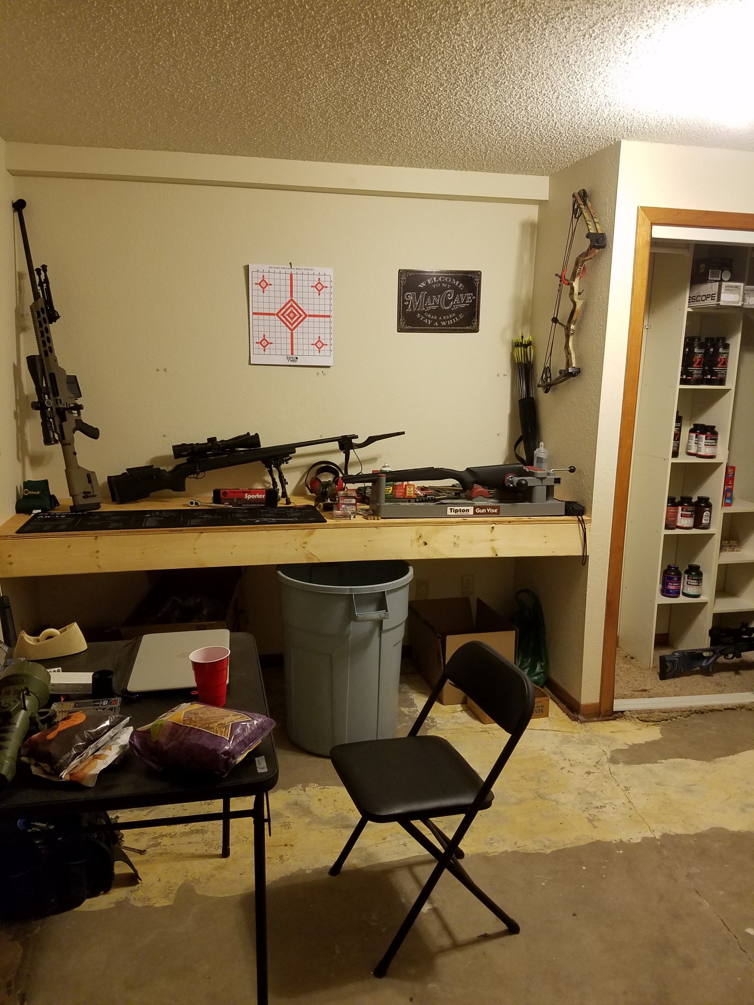

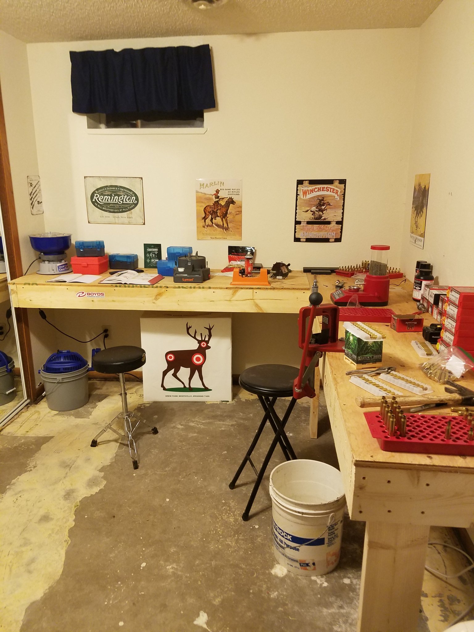

    I have 30 inch depth, but I think 24 would be just fine. You can also radius out a working area to gain moving room. 18 gets pretty small and I could see stuff falling off.
    Some pics from when I was building it. I have put anti fatigue matting on the floor now.
    Given the width you stated, an 18" depth would work fine. I used an 18" deep bench for several years with no problems. I built a 30" deep reloading bench ( including the depth of shelves) a couple of years ago so I could also use it as a workbench.
