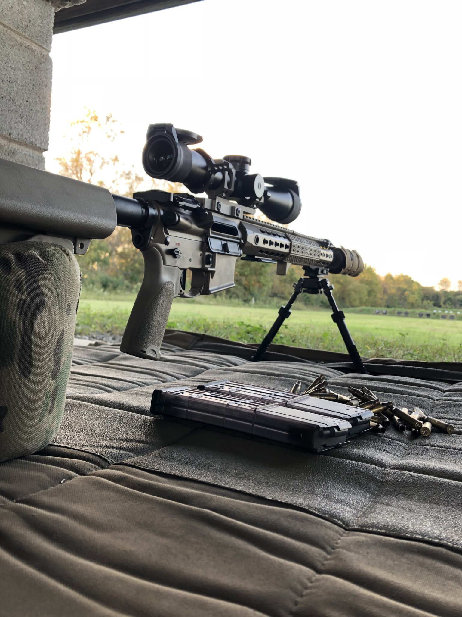

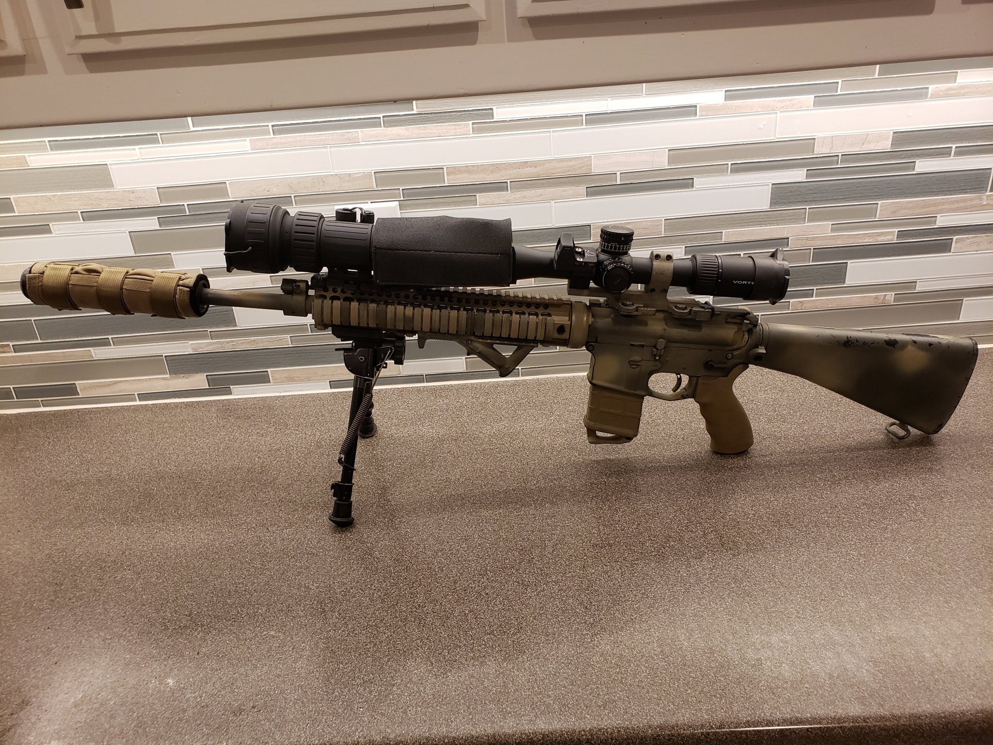

While the mod 0 is basically AR perfection in my opinion I built mine with a more modern flair.

Seriously, the AEM5 with knurling can is SO NICE if the fact that it is heavy doesn't ruin your day (I dont care, the tone is amazing). It's crazy how good it sounds even compared to some of the better modern offerings. The tone, the lack of back pressure, its cheap! it's a great system.
It also has a single stage Timney 3lbs trigger. The upper and lower are a matched set from Rainier Arms. I have gone through several scopes. I can't find the one that i like the best. Currently it has a Vostex PST Gen II 3-14x44 Scope.
It loves MK262 ammo. I can get a solid .5 MOA or better at 300 yards. I have only had it out to 700 yards. I guess i could go longer but if i am going to do that i will use a differant rifle.

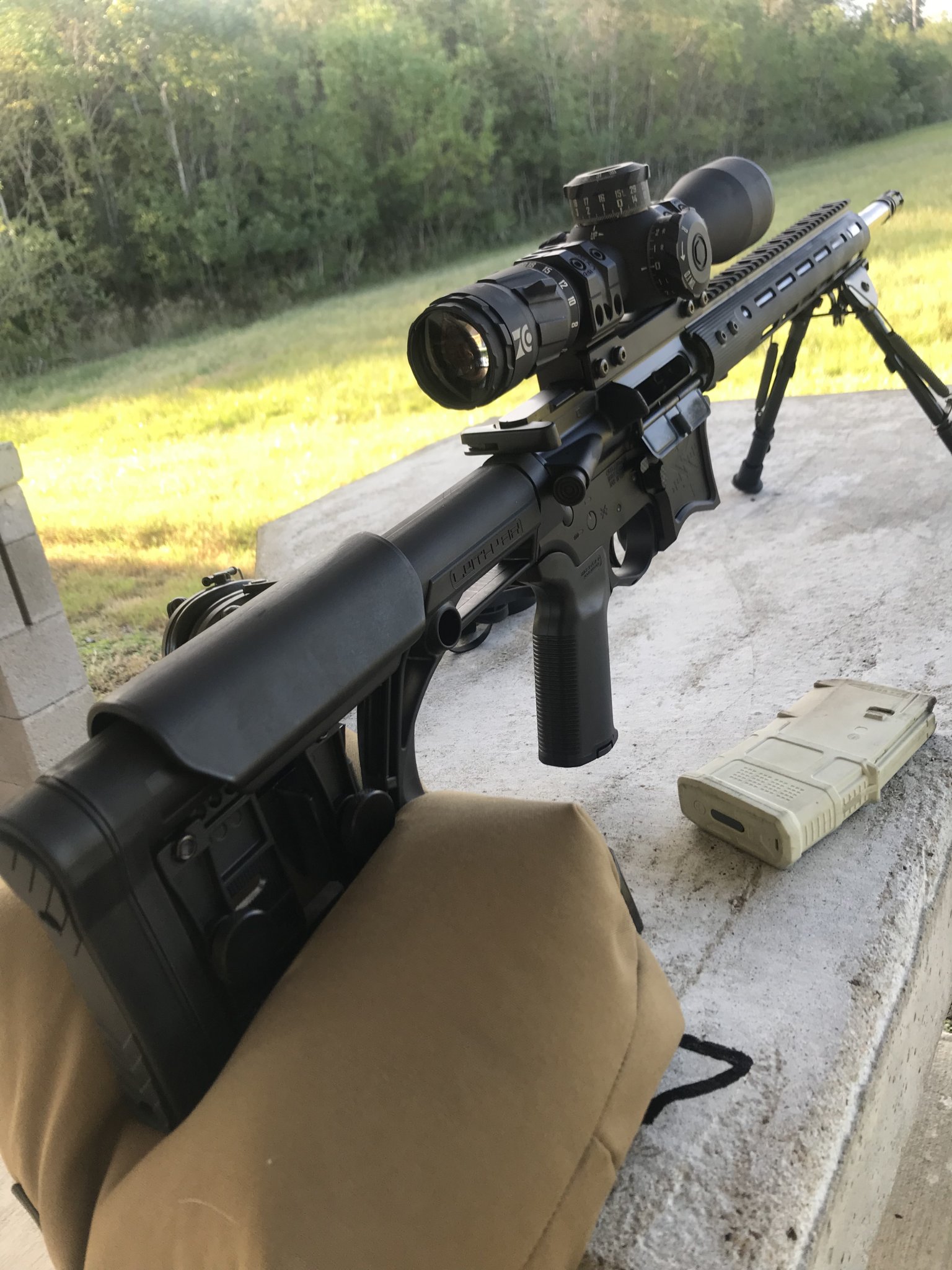

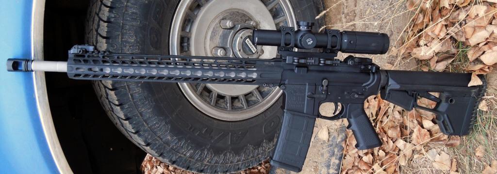

Love my JP 18inch Rifle length adjustable gas upper with a Geissle 2stage trigger. Have a CQBSS 1-8 on it now, though a 3-15 is oh, so sweet. PRS stock was overkill. Looking to go from a Rifle stock to a UBR. With that 1-8, it is a steel assaulter out to 600 yards, down to 10 yards double tapping.

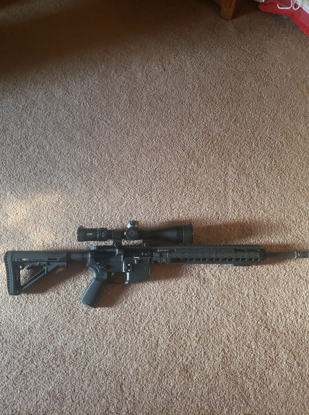

A few years ago I modernized my MK12 WOA barreled modO clone with a URX4 and SF MB since I was never to go get around to getting the Ops/Allen suppressor. Now it’s an LPR wanna-be and I’m pretty happy with it.

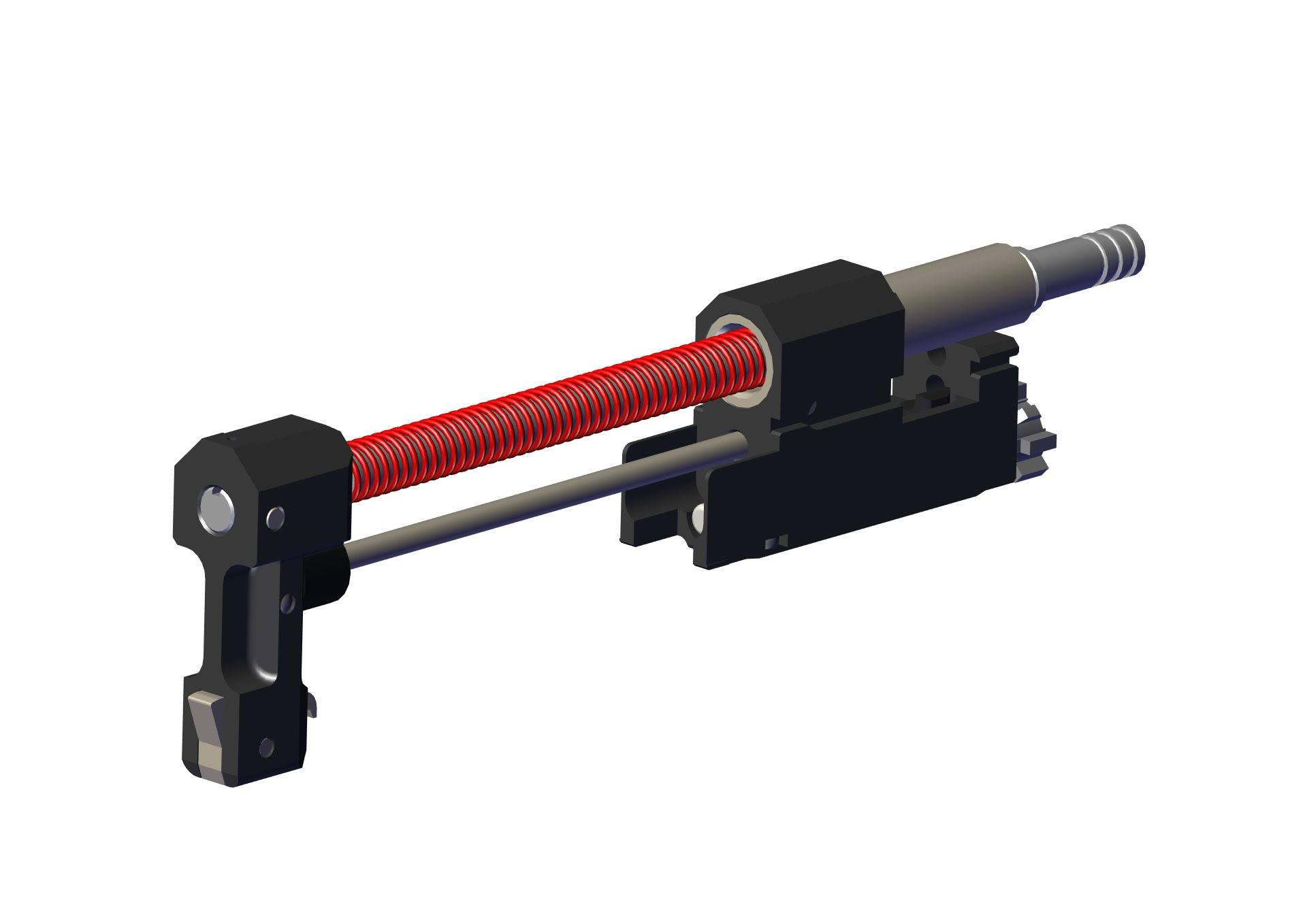

Hey DoD....since we know how you love catering to some abominations at times...may I suggest to you the illegitimate child of the AR and Scar.....
Also--DoD...can you speed the BATFE review up for my importation of this product.
Also can you please explain that since an upper is not considered a firearm via BATFE standards then why do I have to get import license for said upper?
And more important is that IF uppers are not controlled by the BATFE yet they require an import license but yet they do not "Catalog/Test" just uppers why is it that I have to supply them with a full rifle for their catalog/testing?
