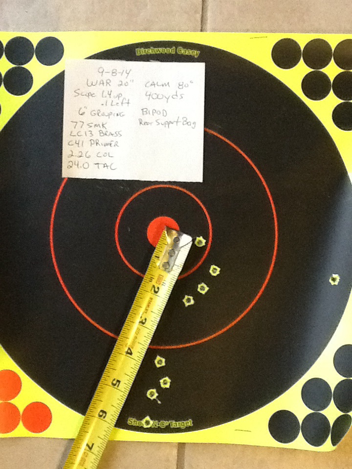

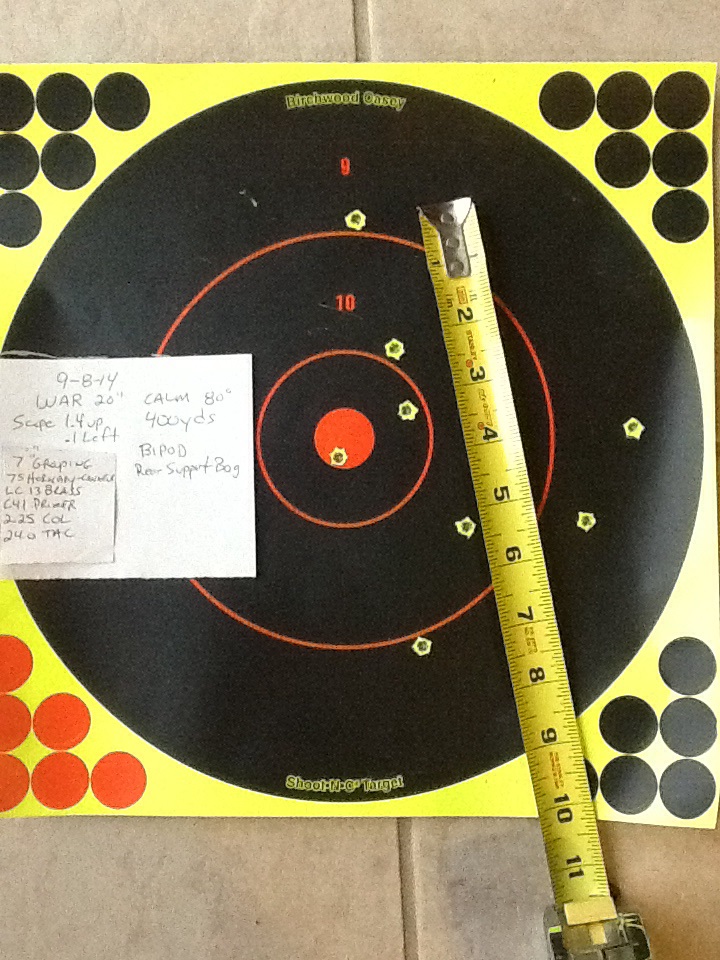

My First Experience with TAC Powder
Here's my results with 24.0 Grains of TAC.
Rifle = Windham Varmint Exterminator 20inch 1x8 twist
Bullets 77 SMK and 75 Hornady with cannelure
CCI 41 Primers
LC13 Brass once fired fullsized
Distance 400 yards
Bipod with rear bag support
80Degrees
Calm winds
77 SMK COL 2.26
75 HC COL 2.25
Note: groups might have been little tighter as I mosquitoes were swarming my face, neck, arms
77 SMK = 6 inch grouping
75 Hornady = 7 inch grouping

attach
http://www.snipershide.com/shooting/images/attach/jpg.gif

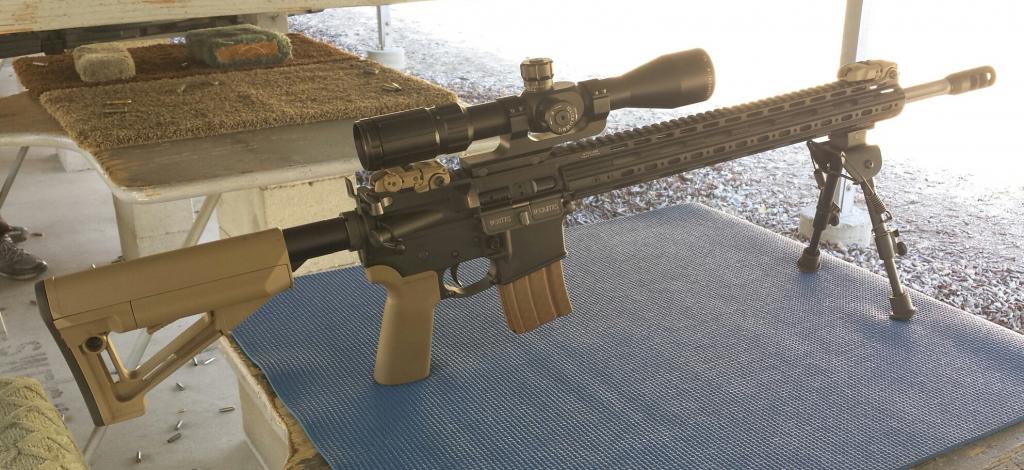

Here is the rifle I am loading for.
