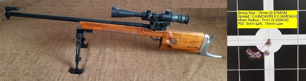

Possible? Absolutely! But it generally takes some work or that occasional batch of luck. How bad do you want it? (AKA what are you willing to spend?)
Shot a 45rd mini-Palma course at 100y this past weekend, missed one point due to wind. :( My smallest 15-rd group was measured at 0.705.
Winner scored 450/450 and we had stock production guns at 444/450.
Note: Using a custom rig with a custom action, benchrest rests, lots of scope magnification and Center-X ammo. No flags (my mistake).

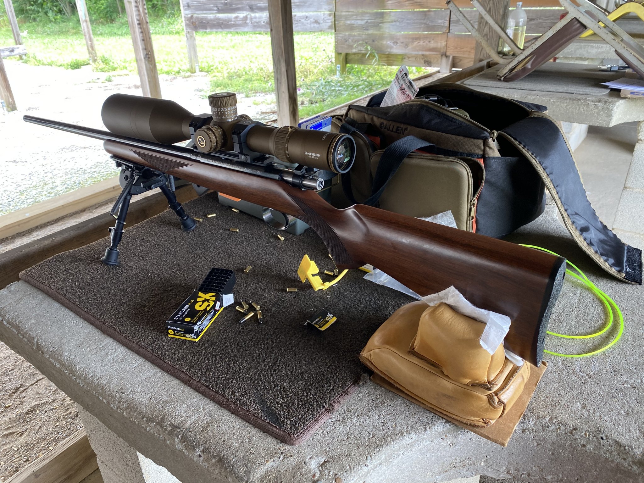

I feel like ammo is the biggest issue for most. My CZ 457 Varmint Chassis MTR with ammo it likes will get close to MOA, or beat it at times. The problem is I always buy a few boxes of some ammo to try, or a new lot to try and by the time I know the gun really likes it, I can't get it in bulk anymore and I'm back to square one.
I have a few boxes of Tac-22 from a year or so ago (new red box) it just LOVES, shoots it better than SK Long Range, Pistol (which it also likes), better than Lapua Long Range etc. Hates Wolf, only 22 I've ever had that did not shoot it reasonably well, doesn't seem to like Eley at all actually. I also had an old lot of SK Long Range when it just came out that it also loved, but newer lots have been disappointing at best.
This is a target from last week, Wolf Match up top, Tac-22 in the middle (5yds). Lapua Long Range bottom Left 10rds, Black square is 1". If I could find more of that lot of Tac-22 I'd buy all I could. Tried a couple newer lots, doesn't shoot nearly as well.

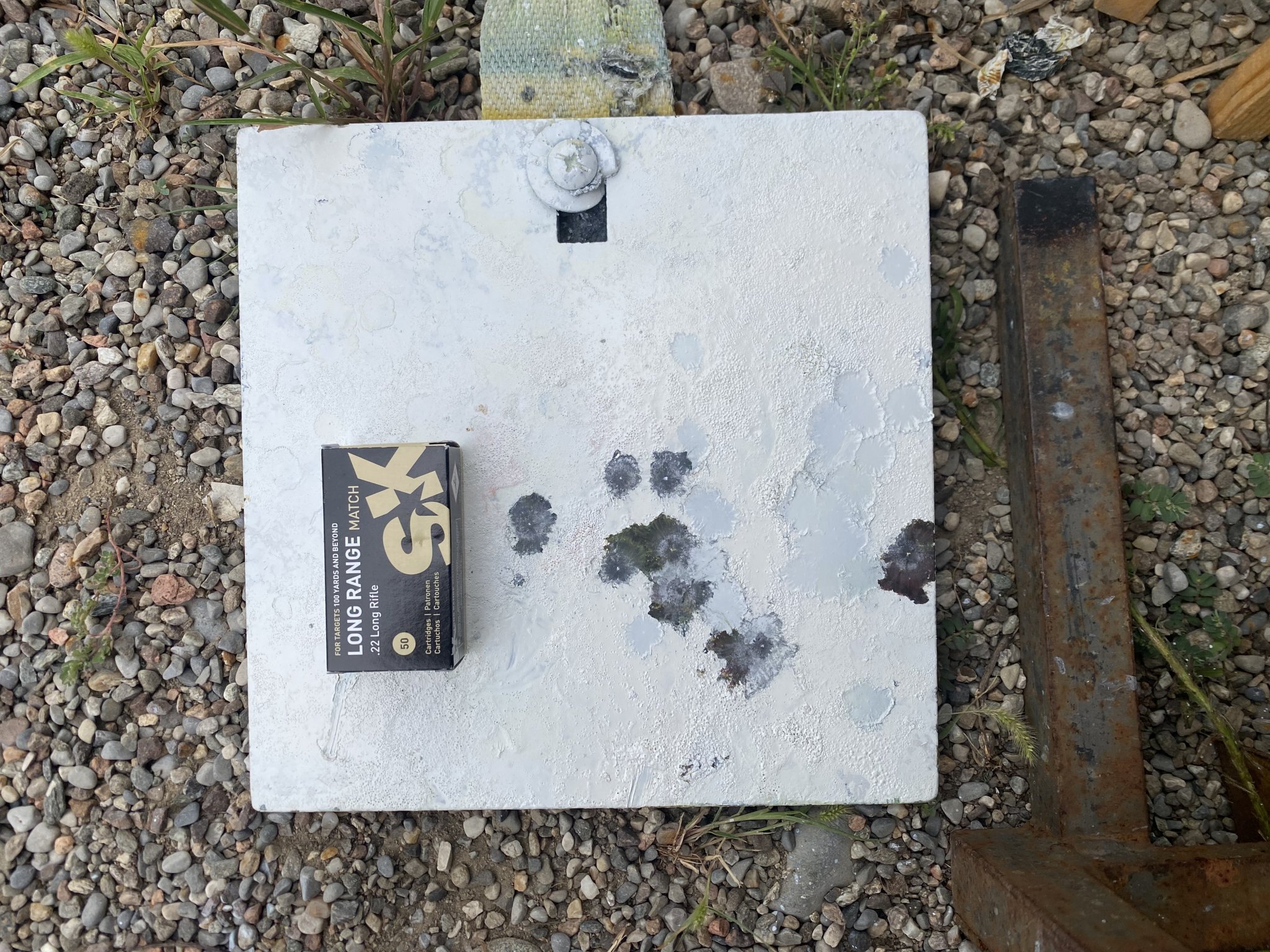

What is the lot of Tac-22?

I'm getting used to it. After a rather poor begining with a plinking ammo - 1,06 MOA Fedral Champion LRN 40gr - the best 5-shots group so far with a better quality ammo- 0,67 MOA [ Eley Match, Lapua SK Match, RWS Special Match ammo are still on the list to test, haven't tried them yet ]
Rifle : Soviet Typhoon-3 ( manufacture year unknown - probably begining of the 70s - so the rifle is most likely my peer :D ),
scope : VOMZ Pilad 10x42 LF
Ammo - Eley Benchrest Precision ( semi-auto ) 40gr
Distance : 100m

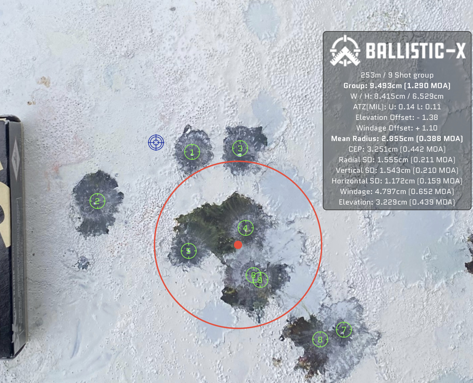

And this is a group at 250 meters, first round on right edge, following 9 rounds very close to the center, with no reference on the target and shooting to the target still moving after the impacts is a nice results
