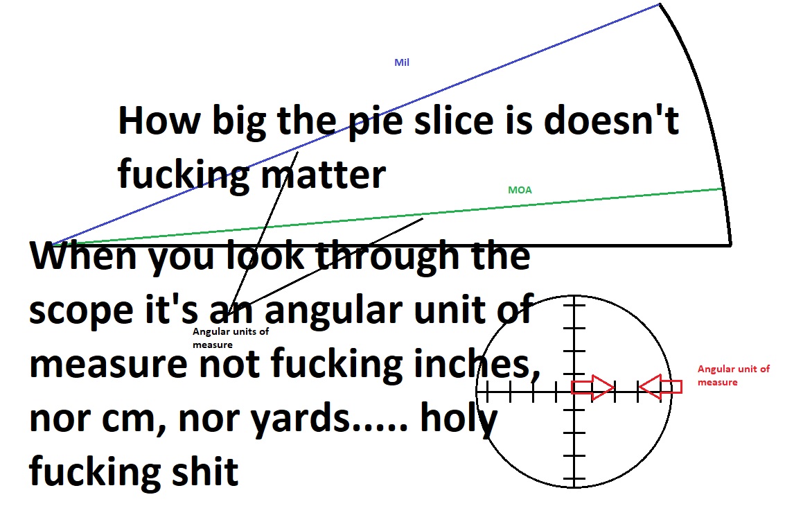

I was just trying to make the simple point that MOA is easier for me to do quickly vs MIL and there is math involved. The formulas are the same, you just have to have a constant value (meters or inches) when applying them. If you want to convert one to the other, then there is more math.No he is not an idiot. I do not think you are either, but it seems that you have ingrained a shortcut into your calculations that is confounding the issue. I have just finished reading this entire thread from start to finish. I can sense your frustration, but I suspect that you are too closely associating meters to MRAD's and MOA to yards. Also, everyone dog piling is probably obfuscating the issue a bit.
Please review starting at the 5:55 mark for a couple of minutes then move to the 8:47 mark in the video link you provided. He is utilizing the MRADs to discuss shooting in yards without converting from MOA's to Mil's.
Then see 15:30 wherein he discusses that mils and MOA's and mils are both being angular units of measurement.
MRAD is a unit of angle. MOA is a unit of angle. The unit of distance that you are measuring is abstract.
Perhaps it will help redefining the terminology.
MRAD = .0572958 degrees <-derived from the Formula (360 /(2 * pi)/1000
MOA = .0166666 degrees <- derived from the formula (1/60)
.0572958 degrees x unit = 1/1000th of the unit in distance.

The only math involved in mils IF you MUST relate it to a linear distance, which you really don’t and shouldn’t ever until you’re measure the group size and then you’re using a linear measuring tool anyway since you don’t measure group size with your scope, is shifting the decimal. I don’t even consider that math.I was just trying to make the simple point that MOA is easier for me to do quickly vs MIL and there is math involved. The formulas are the same, you just have to have a constant value (meters or inches) when applying them. If you want to convert one to the other, then there is more math.
That's it what all this has turned into.. not sure how.. but it did
You are focusing on the definition of the thing and not the practical hands on USEAGE of the thing.
If your dope is written in mils/moa
Your corrections are measured and given in mils/moa
Your leads are held in mils/moa
There is ZERO need to backtrack into inches.

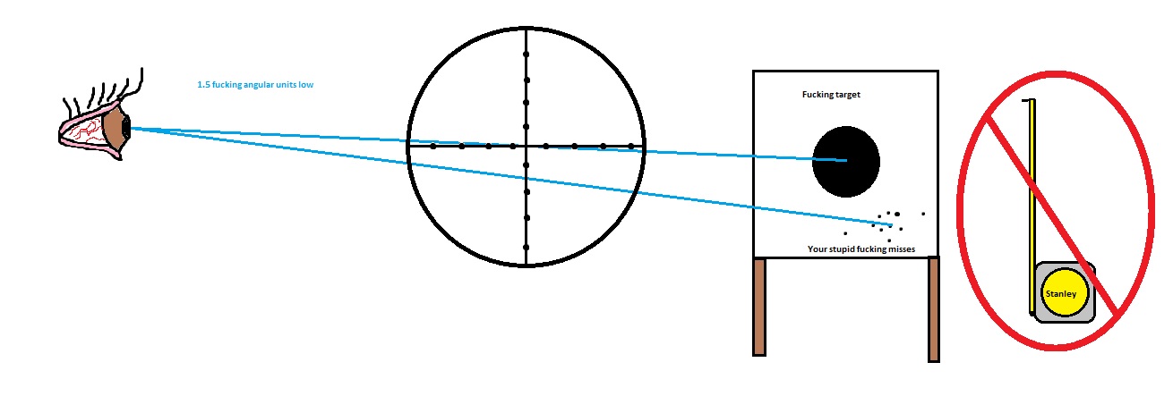

Your reticle is calibrated directly to your dials.
You see a miss and think "that's 2 feet left".
Your supposed to measure with your reticle in real time....your 2.5 mils left....your 9 minutes left.
If you are using feet and inches....YOUR DOING IT WRONG.
Your focused on the definition if a Mil being 3.6".....that information is there for you the layman to visual it. ITS NOT THE USEAGE.
You dont read a speed limit sign and do a bunch of math backtracking inches per second traveled. You speed up till the speedometer reads 35mph for that street and move on.
You have a target at 500 yards/meters. You have your dope in mils/moa for 500 yards/meters. You dial (or hold it). You hit or miss....upon the miss you measure with your reticle in mil/moa and apply it as needed. Done. No inches anywhere.
The gun and scope doesnt care if you call a target 200 meters or 219 yards away. It only cares that you need 0.7 mils to hit it. Done.
