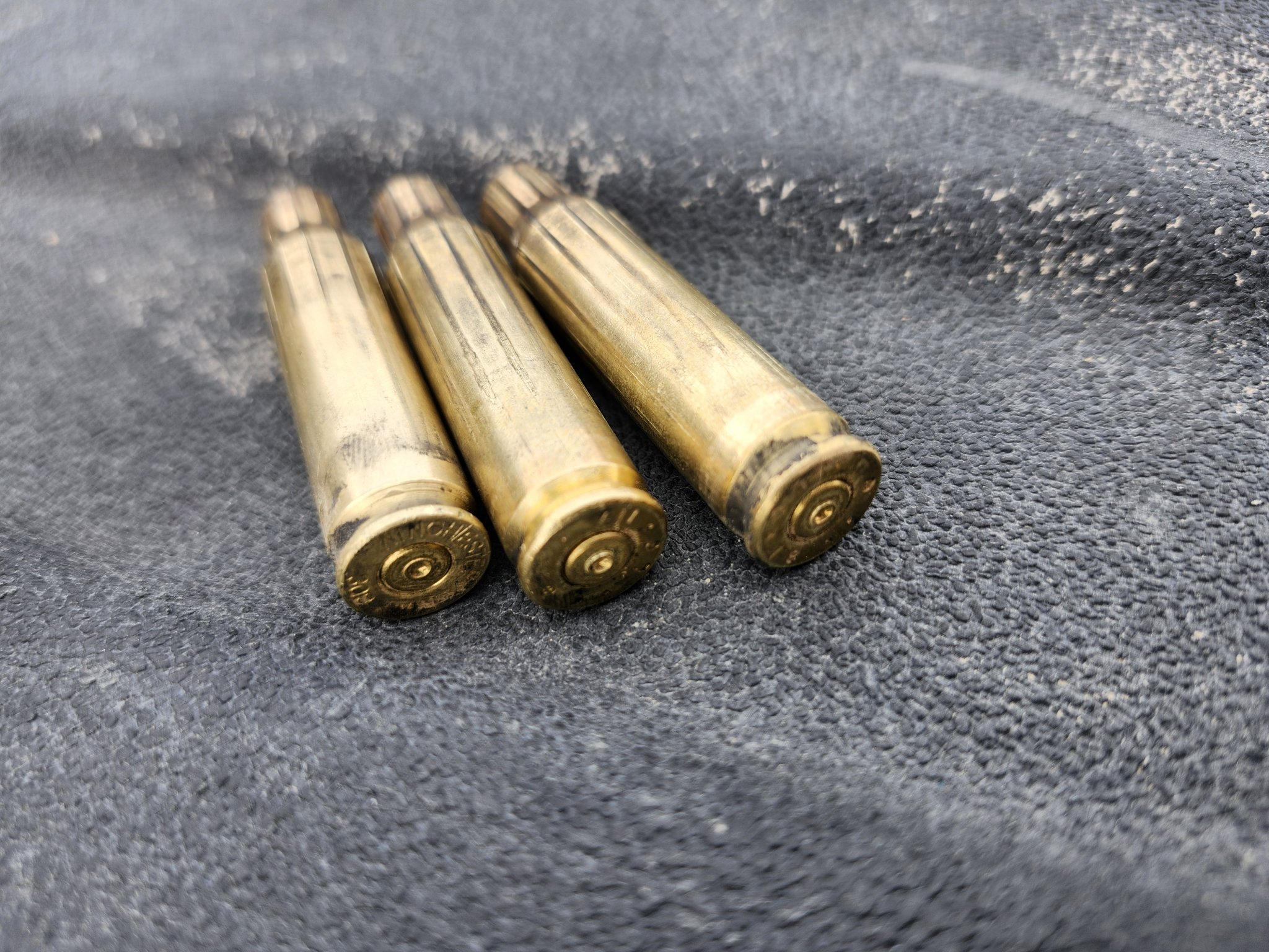

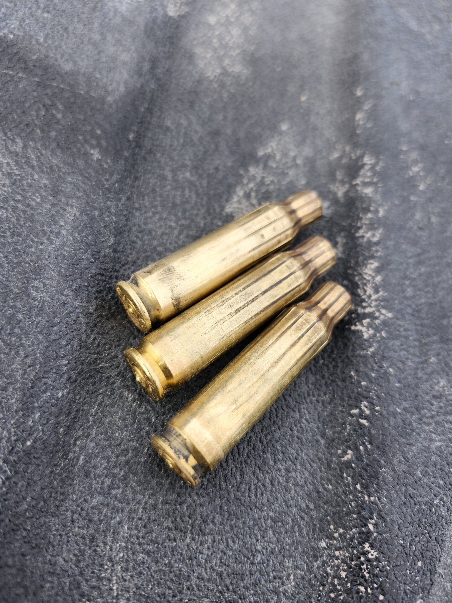

What's scary is there's more than one case that looks that way..............Ya know, I'm no expert, but I think I *may have loaded these'ere things a bit hot. Gonna have to dial this back like 2-3 grains LOL. First time loading semi-auto 308..
... so, yeah... apparently a 155 AMAX and 44.5gr of IMR-4166 isn't the answer in the PTR-91
I've never seen the chamber flutes so clearly![]()
Oops
But, at least the view is nice from the range....
And yes, the casing from the 4th shot is totally stuck in the chamber LOL. Time to go home![]()
Tough to find when they fuck off into low-earth orbit, because G3 ejection pattern generally 20+ feet "over that way".What's scary is there's more than one case that looks that way..............
Looks like a good chamber job…Ya know, I'm no expert, but I think I *may have loaded these'ere things a bit hot. Gonna have to dial this back like 2-3 grains LOL. First time loading semi-auto 308..
Oops
It’s an H&K design and that’s how their chambers were for that time period.Looks like a good chamber job…
They were probably ejecting a half mile away so he didn’t notice until he drove to pick them up.What's scary is there's more than one case that looks that way..............
I had a P7 that ejected cases 15’ away every time. Same striations on the cases. Didn’t love it and moved it in. Shoulda kept it I guess.They were probably ejecting a half mile away so he didn’t notice until he drove to pick them up.

Yeah, apologies. I guess I was kinda being a shitheel about it. I thought about it and I can see where on the fourth round, you would have gone "Ruh Roh". Then, hindsight is 20/20. You kinda have to "admire" HK for being able to fling brass two to three times further than any other manufacturer. Their ability to fling brass to the tree line/weeds is pretty remarkable.Tough to find when they fuck off into low-earth orbit, because G3 ejection pattern generally 20+ feet "over that way".
But, I'm picking up what you're putting down. Lesson learned.
Thank you Sir. @FCS shot me a PM with some guidance. Between your posts and FCS's help, it is truly why I am on this board. Shit talking and helping each other be better and safe.Yeah, apologies. I guess I was kinda being a shitheel about it. I thought about it and I can see where on the fourth round, you would have gone "Ruh Roh". Then, hindsight is 20/20. You kinda have to "admire" HK for being able to fling brass two to three times further than any other manufacturer. Their ability to fling brass to the tree line/weeds is pretty remarkable.
But, as they say, always start at least 10% below max charge and work your way up.
Or, if you don't shoot the G3 that often, maybe factory ammo is the way to go.
Be safe Bud. You have a beautiful Fiancee who really shouldn't have to feed you out of a pudding cup. It's kind of a Cinderella story that we all want the best for the two of you. The two of you have a very bright future together.
All the best.![]()
Your primers are pouting.Ya know, I'm no expert, but I think I *may have loaded these'ere things a bit hot. Gonna have to dial this back like 2-3 grains LOL. First time loading semi-auto 308..
Based on the brass flow... yeah... good chamber job LOLLooks like a good chamber job…
