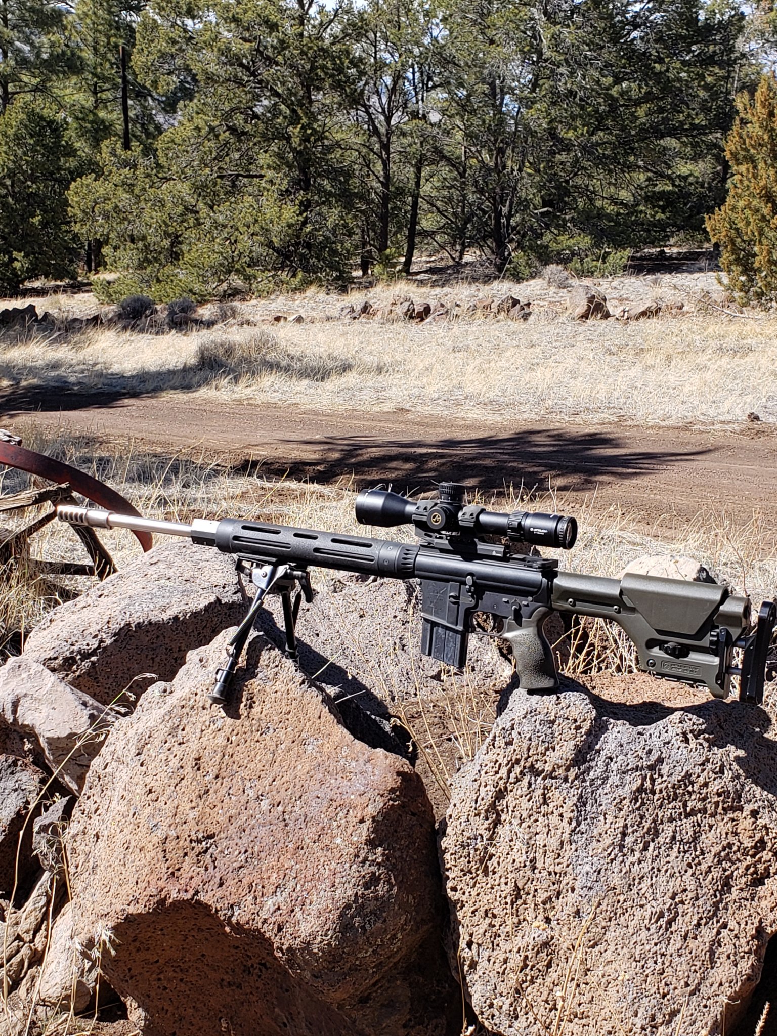

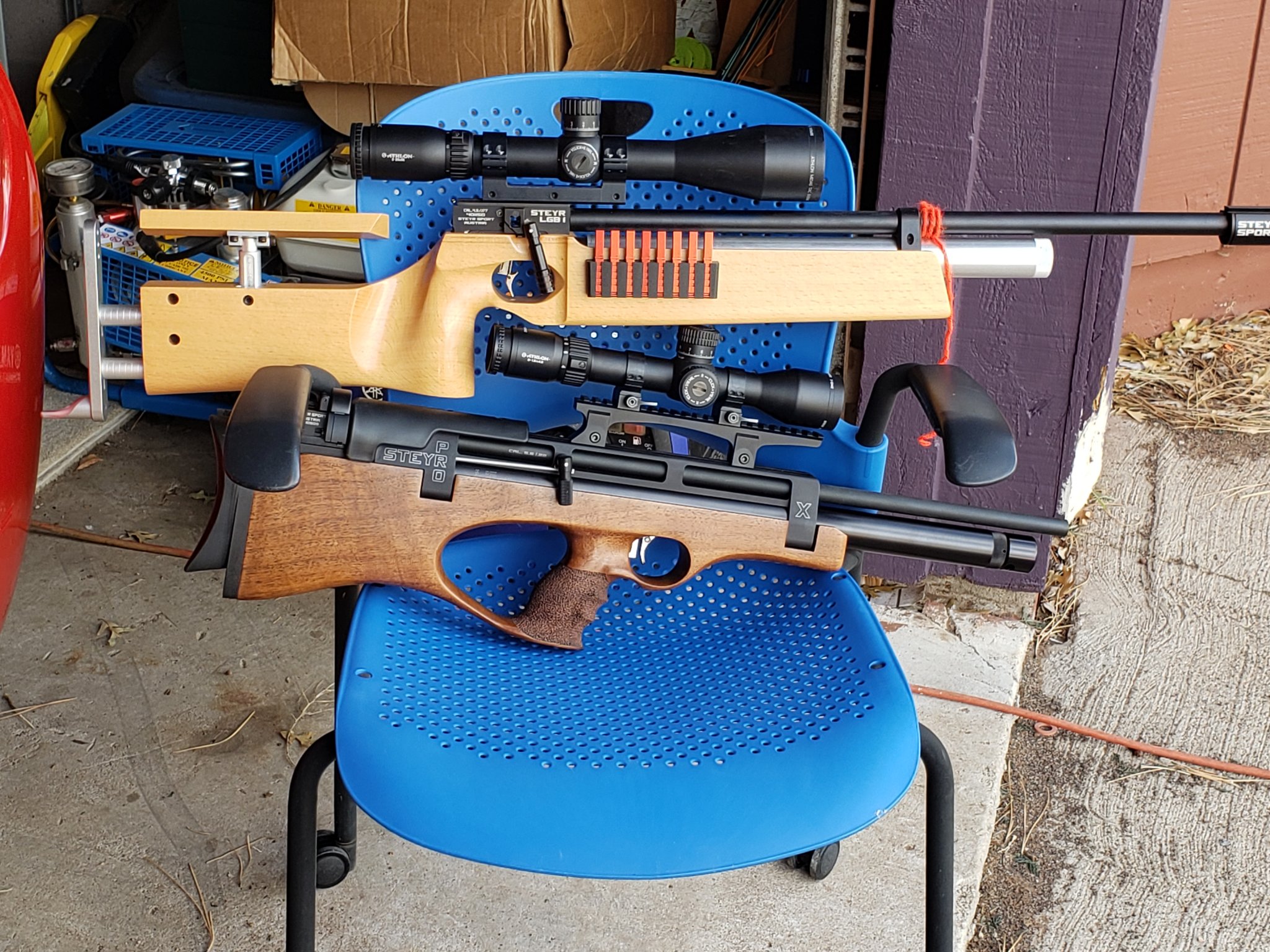

    If its for a fast shot when you need to see the reticle well in a FFP scope then you'd be pleasantly surprised with Athlon's Helos G2 DMR 2-12x42 in mil.
    I have two of them. One is on my 6mmFatRat AR that I use on steel out to 1122Y and one is on a $3000 semi auto pcp air rifle.
    It's a very unique scope and reticle loaded with most of the modern features and with exceptionally distinct feeling locking turrets.
    It's hard to describe the feeling but I find it a fun scope.
    It's on the bottom airgun. The top airgun has Athlon Midas TAC 5-25x56 on it.
