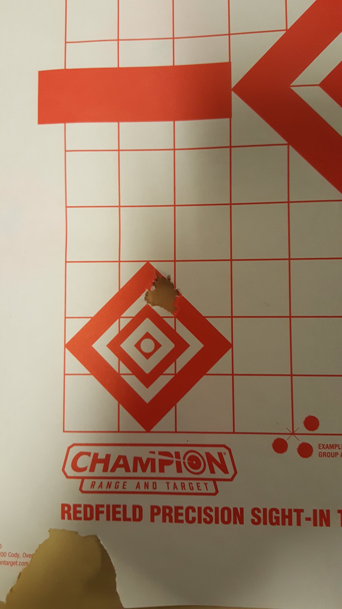

Well boys I found a round the gun likes, It does not like Federal GMM 140gr or Hornady ELD Match 140gr, but it seems to really shoot well with Hornady ELD Match 120gr, kind of surprised me.
Thanks for the replies
5 shot group @ 100yds
