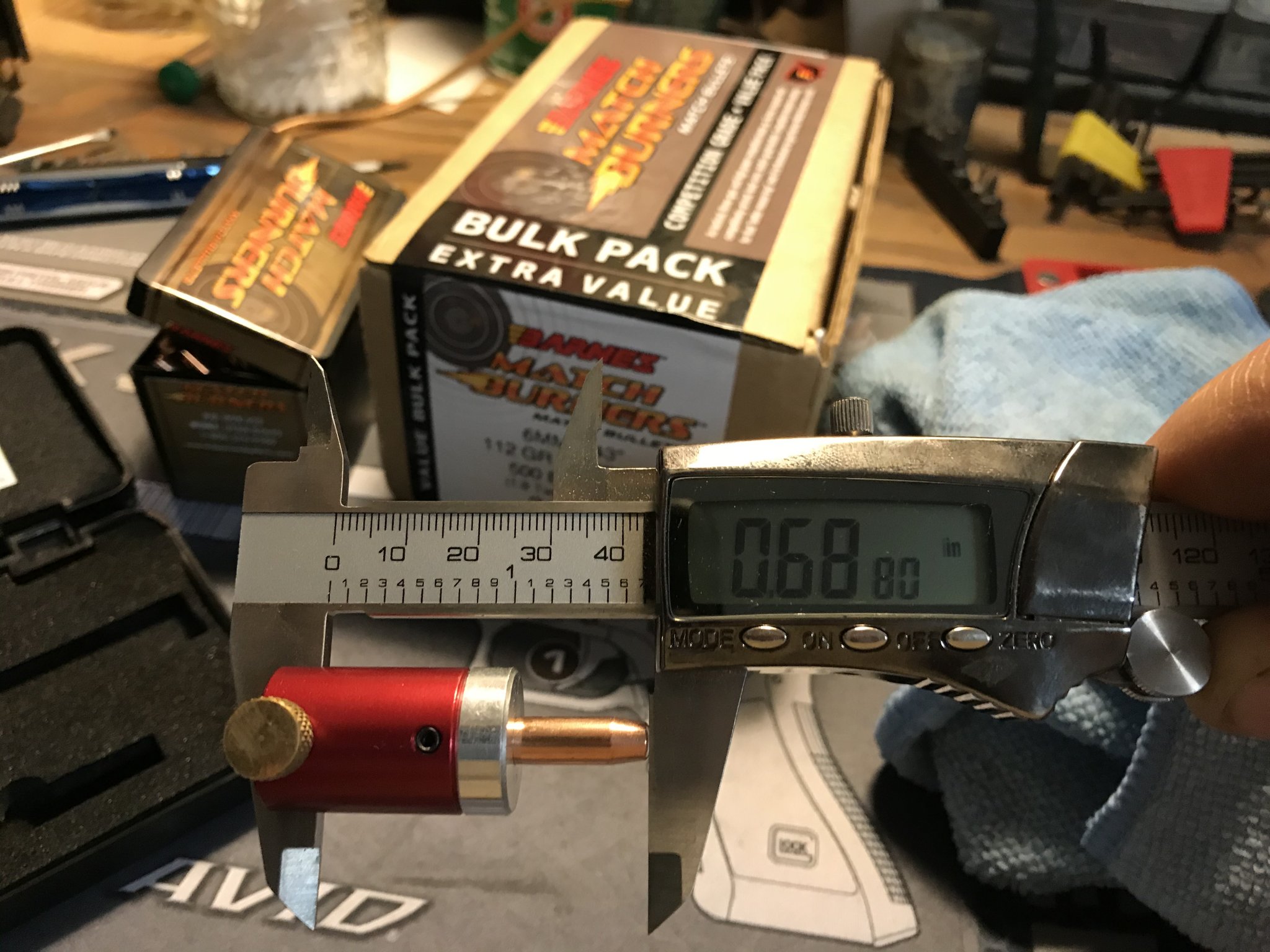

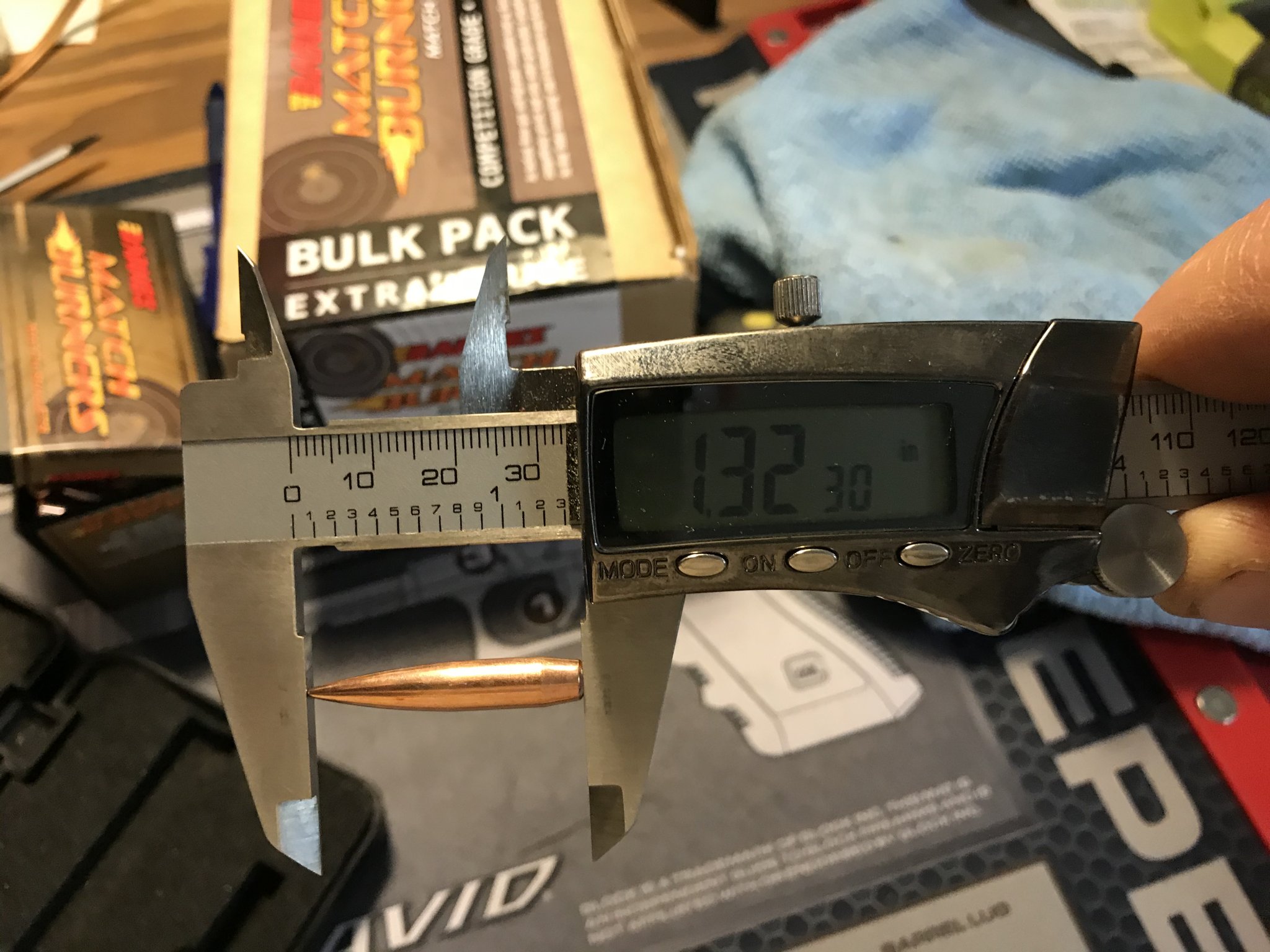

I get a base to ogive of .688”.
Then a OAL of 1.323” if that matters to you.

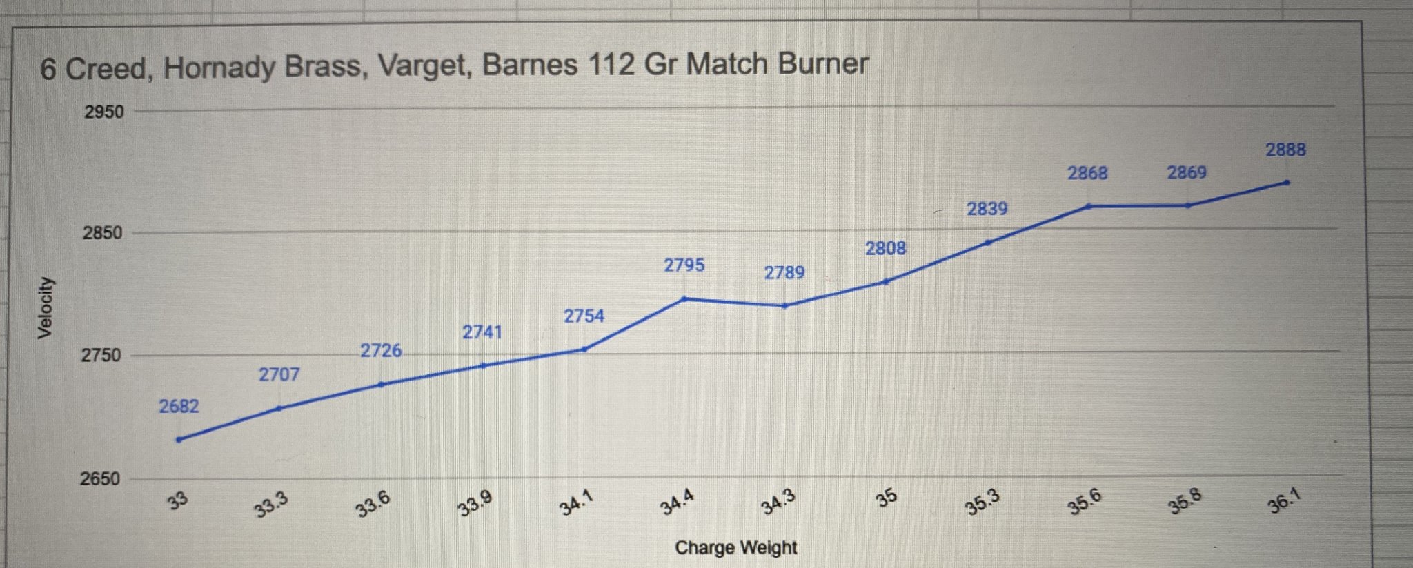

I tried with them Varget.
I couldn’t find any load data so I used the Sierra 110 SMK data however; my CBTO is 2.189”
Started at 33 Gr and went .2/.3 to 36.1 and found a nice velocity flat spot 35.6 and 35.8 with a MV of 2868. No pressure signs.
I’m considering keeping it going until I find pressure.

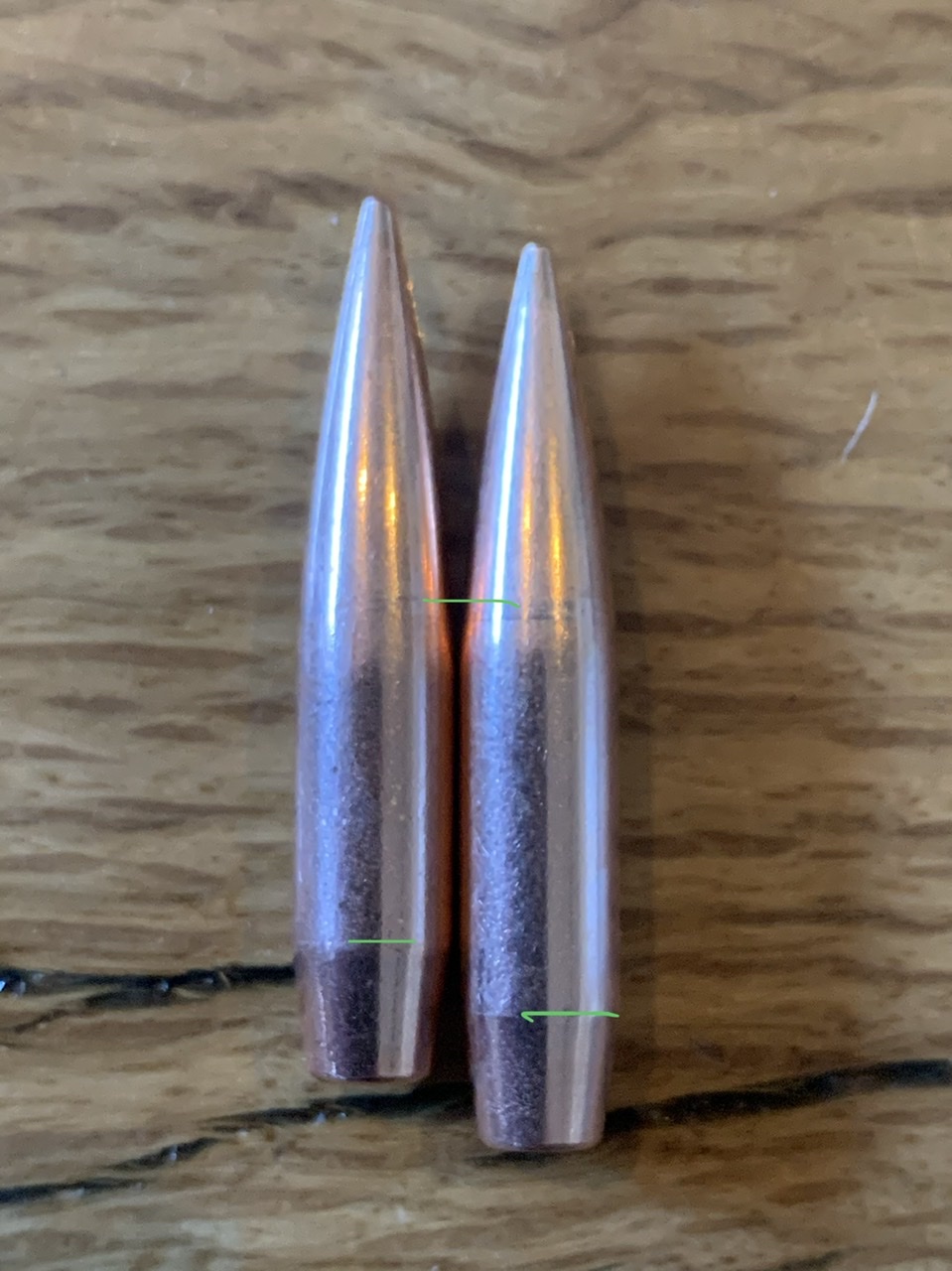

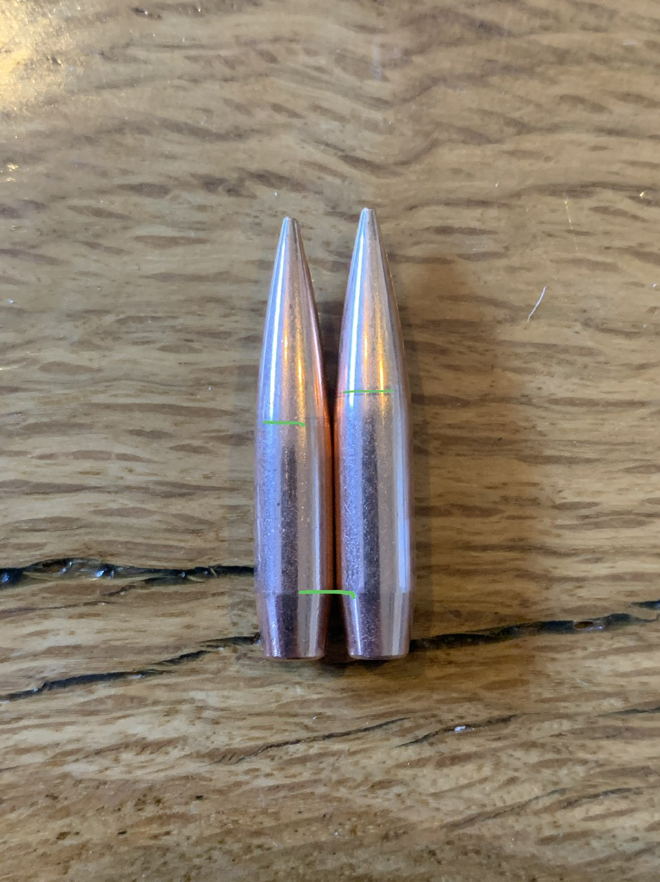

Those of yall with a 6 creed? Would yall be able to share your CBTO or COAL measurements for where you are seated, how far off the lands you are and then especially your chamber freebore if you know it? Or shit, all of that for any reamer if you know your freebore.
I am starting a new barrel and I can set a bullet in the case and press it in with just finger pressure so that its held by the case and close the bolt on it in the chamber and it doesnt touch the lands. I stick a 115 rdf in there like that and it hits waaay early like I would expect it to.
As such Im guessing in going to have to jump these bullets a fucking mile so Id like to have some others verify the measurements or to cross check and see if I have a funky bullet chamber mismatch with pvas standard reamer.
With finger pressure holding it the CBTO is 2.292 and COAL is 2.934
112 barnes on the left, 115 rdf on the right with the point where they hit the hornady comparator twisted and smudged lined up and then the end of the bearing surface difference.
And here wit the bottom of the bearing surface lined up. You can see that the actual start of the bearing surface is further back still than my lines.

Don't worry about the lands seat them at book length an send them. But ill post my ogive measurements when I get home. Ill say I went from 10-60 tho off in 3 tho increments an they fell apart at distance until I seated them at book length
I mean... I am because I have to. Book length is 2.775 which coincidentally is what I came up with when seating them one caliber deep into the necks which comes out to 2.130 cbto.
Id still like to know though whether this bullet would be better suited to a shorter freebore chamber or if mines just fucked up.
