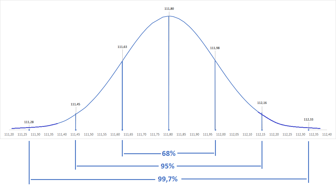

I've bought 1000 of the 112s. I decided to check how uniform they are. I started with weight. I weighted 300 to be around a 95% confidence level with 5% margin of error.
Not bad at all for an inexpensive bullet.

Is a 1.05gr spread kinda normal for rifle bullets? I would have thought 0.5gr would be more normal. I checked a box of my 168gr SMK the other day and they were within 0.3 out of a box of 100.
If you’d increase the sample size you would find some outlier that represent the 32% weirdos.
In that sample 68%(680) are within 0.35gr
