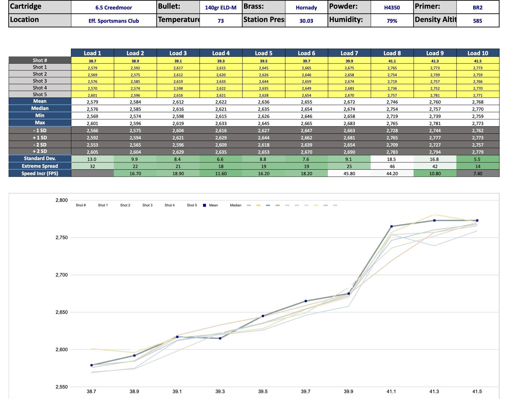

I worked up my first load test of 6.5 Creedmoor starting at 38.7gr and working up to 41.5gr. Barrel was cleaned the night before, I then shot 10 foulers of factory Hornady Match 140gr ELD-M. Started at 38.7gr, shot those 5 rounds, threw in my barrel cooler and waited a few minutes and repeated this with the next charge weight.
I ran 10 loads, at 5 shots each through a chrono. I also tried my best to take my time and examine group sizes but I quickly ran out of daylight last night and started to rush the last few loads. Below is the load data that I got.
My question is does this data look right? That jump in velocity on loads 7-8 seems excessive compared to the other load weights. But maybe this is normal?
I wasn't getting any pressure signs at 41.5 (Max safe load) and was wondering if I should push it a little bit further to see what is there?
It seems that 41.5 is my node that I will be going with from this data, I may go a few more loads further to see how that goes but judging from what you all see does this seem correct?
Here is a link to my load data spreadsheet-
For my next step, I'm assuming I need to mess with seating depth? These rounds I tested were nearly too long to fit in my magazine, they JUST barely worked. I seated them 0.020 off the lands of my rifle at 2.252. When starting my seating depth ladder I start at 2.252 and work my way down? How big of steps would you all recommend?

41.5 should be pretty safe. It's a pretty well known load with your components. I think that is the Hornady load they use to publish on their factory ammo. There is a load that is higher too, but not all rifles and brass can take it. I run 42.5gr with those exact components with both Prime and Lapua LRP brass. Would have to work that load up. If you are happy with the 41.5gr load, I would work the seating depths and see how it goes.
I was running 42.5g of H4350 behind a 142 SMK. This would yield about 2,800fps and no pressure signs.
That said, your data LOOKS correct in that I believe I saw similar results while working up a powder charge.

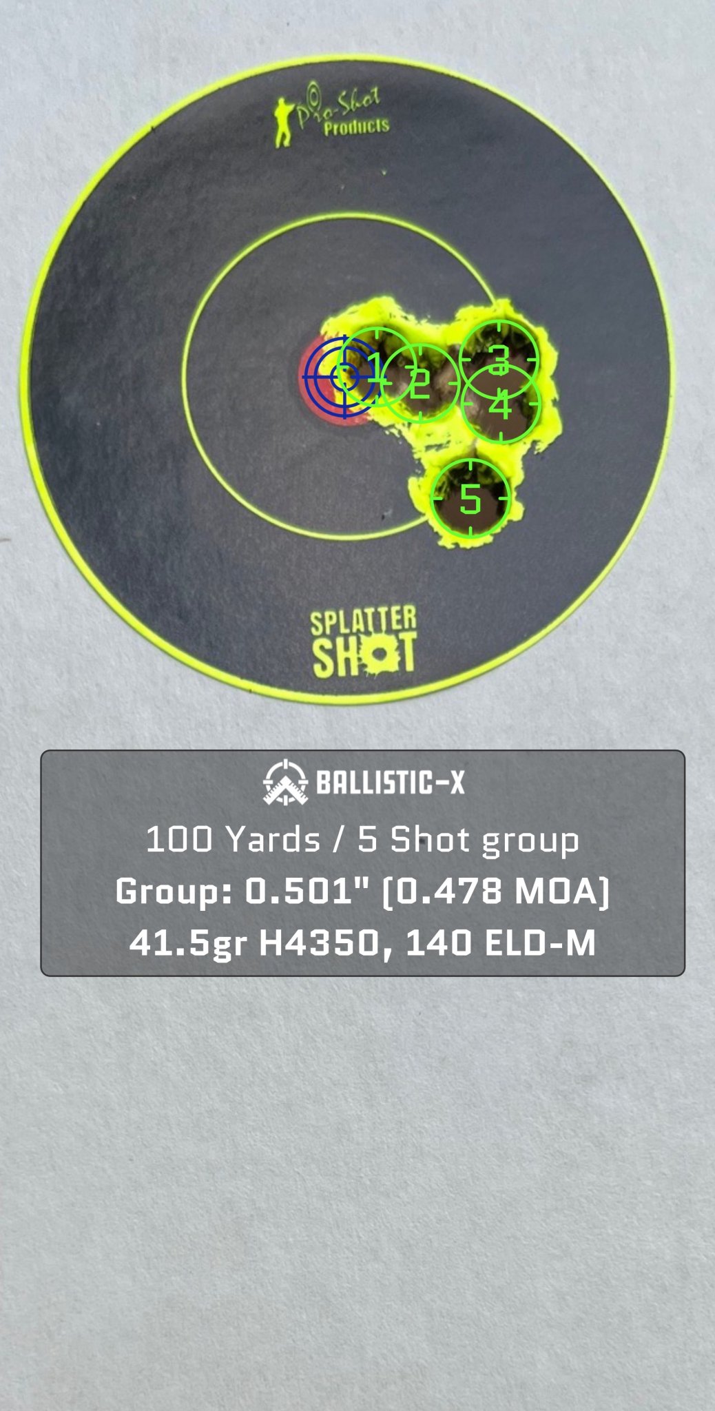

Where are your targets? You put some nice data together but with not knowing rifle barrel length there is nothing to analyze, other than you seem to be able to load pretty consistent ammunition based on most of your loads. If you are looking for flat spots forget it. If they exist it's almost always a result of testing not because of the charge.

What do you mean by where are my targets? As in photos/data of my groups? I left those out as they arent going to be the most reliable, I can if you want me to though. The last 5 load weights I had to rush to get done and im sure I introduced a lot of shooter error.

The ultimate goal is for a tiny five shot group much more so than 5 shots with low ES / SD. I shoot all my test loads over a chronograph for reference but the target is what tells you what you really need to know.
Reactions: FredHammer and Doom
I'd stick with the 41.5gr and tinker with seating depth. I've had multiple 6.5 barrels that all ended up using 41.5gr after testing.
Also tinkered with seating depth on all of them, but essentially factory ELD length of 2.81ish OAL and 2.185 CBTO with 41.5gr of H4350 has always given me sub half inch groups with a good barrel.
This is copied from a post I made earlier today for another new reloader. You are correct; your next step is to tinker with seating depth to achieve optimal accuracy. Don't waste your time, components, and barrel life chasing low velocity spread.
I'll tell you something else from experience: If your rounds are very close to not fitting in your magazine, you may encounter a stuck-round misfeed, and Murphy's Law dictates it will happen at the most inopportune time. Just sayin'.
The concept of velocity nodes relies solely on tiny sample sizes which yield utterly misleading "data."

-loads that produce good sd are usually just an illusion of statistics, at least read that data very critically.
-the best practice is to just do the same load everybody else does (always start low)
-if you want to tinker max (we know you are going to anyway), you have to carefully first test where pressure signs appear. Also first find a reasonable pressured, reliable load that you can test others against.
-Do 1g or half grain tests to see where the nodes are, .3gr are for smaller cartridges

Honestly mostly all of my SD's were pretty good, I would like to see it 10 or below though ideally. But if that doesnt group worth a shit then it doesnt matter.
