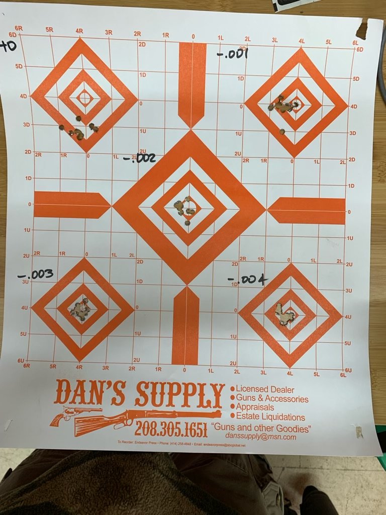

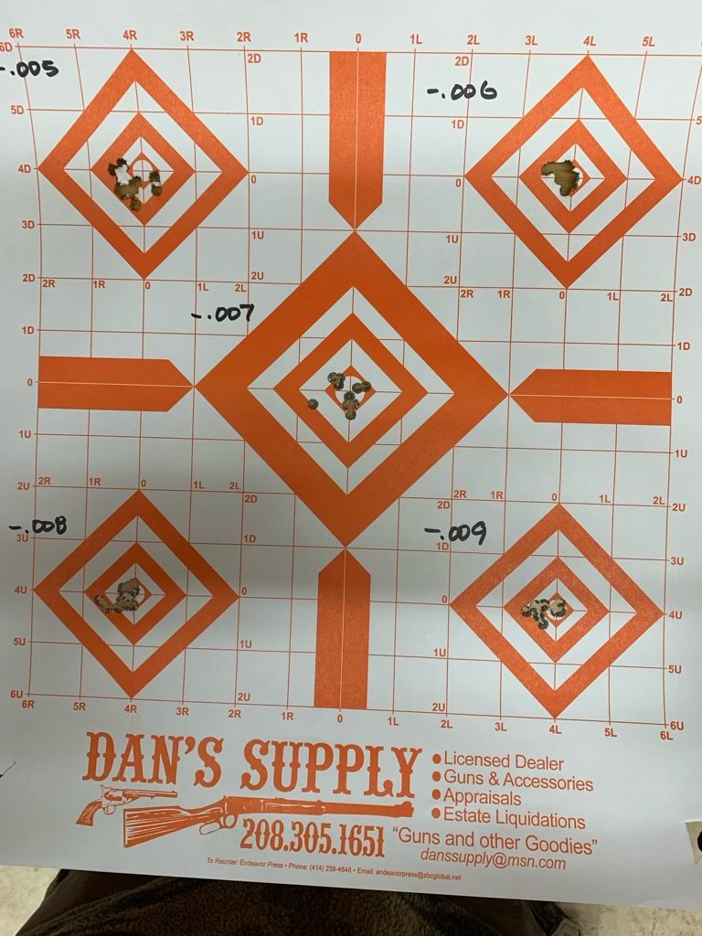

I will include here a set that I did with a 223 Ackley. I shot 10 groups of 10 seating depth changes after finding my max pressure (not velocity but they are hand in hand) with bullet against the lands. All same charge measured to the kernel with my FX120i scale and auto trickler but finished by hand with an hand trickelr.
You see that at touching, I was roughly 1 MOA low, a 1.5MOA group of 10. I meant to dial my scope, just because, but forgot until I shot the first round at -0.001" seating depth, about 1 MOA 9 shot group. I adjusted the scope. At -0.007" there is a flyer that I called. That one is 100% me. Still, group is now about 1 MOA.
There was a slight right to left wind, maybe 3 mph, a few gusts higher, that accounts very slightly for the horizontal stringing.
What seating depth would you choose as being mo betta or are they all good to go?
View attachment 8521767View attachment 8521768
-4 gets my vote. :giggle: Need to repeat to see if it's repeatable.

I will include here a set that I did with a 223 Ackley. I shot 10 groups of 10 seating depth changes after finding my max pressure (not velocity but they are hand in hand) with bullet against the lands. You see that at touching, I was roughly 1 MOA low. I meant to dial my scope, just because, but forgot until I shot the first round at -0.001" seating depth. I adjusted the scope. At -0.007" there is a flyer that I called. That one is 100% me. There was a slight right to left wind, maybe 3 mph, a few gusts higher, that accounts very slightly for the horizontal stringing. What seating depth would you choose as being mo betta or are they all good to go?
I settled on -0.006" and it has proven to be VERY repeatable. Coyotes at 800 plus!! I can ring the 4" steel at my pond boringly at 650 yards. If i miss, it was me missing it. Don't get me wrong, I miss it.
Interesting at -0.007" the cloverleaf pattern of 3 groups.

-6 looks real good to me too, in fact, I was was debating between -6 and -4, but I liked the vertical in -4 discounting the couple that hit at 10 o'clock, simply attributing them to shooter's error. When do that kind of interpretation, it's the following verification test(s) that gives me a better idea if I'm right. :giggle:

I will include here a set that I did with a 223 Ackley. I shot 10 groups of 10 seating depth changes after finding my max pressure (not velocity but they are hand in hand) with bullet against the lands. All same charge measured to the kernel with my FX120i scale and auto trickler but finished by hand with a hand trickler.
Edit to say: These groups were fired 45 minutes apart with a thorough cleaning of the rifle after each group of 10. I shot LOTS of 22LR in my Bergara figuring out what it liked on this same day. I also did some verifying with one of my 300 WINMAGS. I wasn't just sitting there waiting for my timer to ding.

Thanks for the input. Of course, these loads were developed about 4 years ago....so....
I am quite sure that when I wrote 0.000" the bullets were just BARELY touching and not jammed at all. I use a stripped bolt and dry erase marker to find that point.
As far as obliterating the aiming point....well, it may appear as that is the case but if you notice the targets are oriented in such a way as to be able to use your scope crosshairs to line the corners of the target up. Horizontal points of the target aligned with the horizontal crosshair while the vertical points of the target are aligned with the vertical crosshair. I'm not even looking at the "bullseye". Smart, huh? FAR more reliable than trying to aim at the center of a little box.
I have a BS Math and a MS in engineering. I am not real interested in reading more about statistics. In fact, other than reading what my chronograph spits out as SD, I don't give 2 shits about statistics while I am pulling the trigger. Gregor ate peas, I am a carnivore.
Honestly, any of these groups from -0.003" to -0.009" (measured as away from the lands, there were no jammed bullets) could probably have been used. I chose -0.006" just in case I wanted to chase the throat erosion, I might have some prolonged time with this barrel. I have never done that, chase that throat erosion, but why would I want to shoot myself in the foot?

That's fine with me. You do you.
That being said....which one?
Any.
