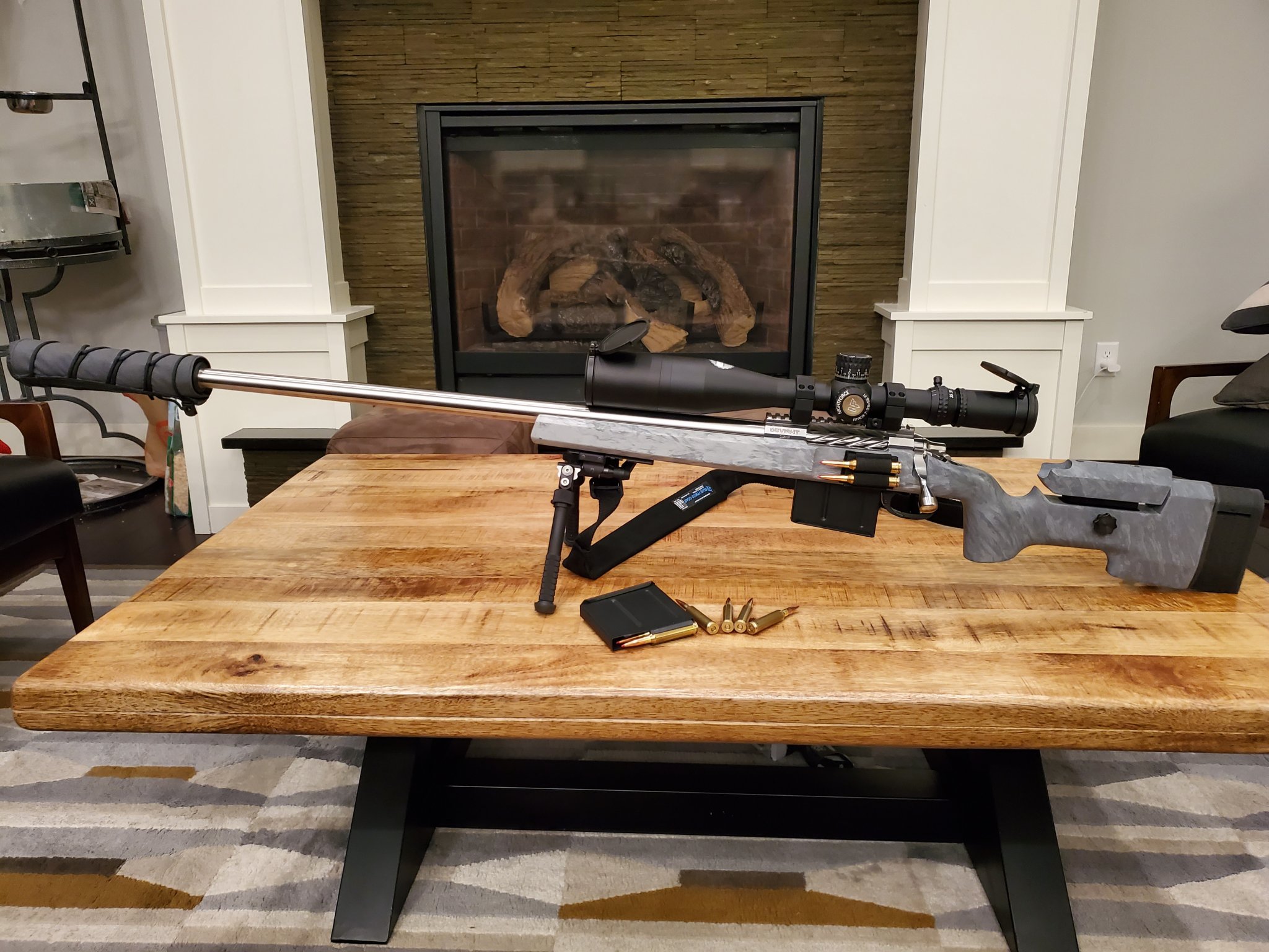

After an agonizing wait, my stock finally came in yesterday on my first LR build, and I was able to put everything together. This is the result:
Defiance Deviant Tactical LH in 7RM w/ 30MOA rail
McMillan ADJ-A6 w/ ghost flame pattern
Nightforce ATACR F1 7-35 MIL-XT
Krieger 28” bbl 1:8.5/M24
Bix n' Andy TacSport Pro trigger @ 14oz
APA RTG bottom metal w/ CIP length mag well/mags
Atlas-CAL
SAS Arbiter (9”) w/ Rifles Only MAD
How did she do?

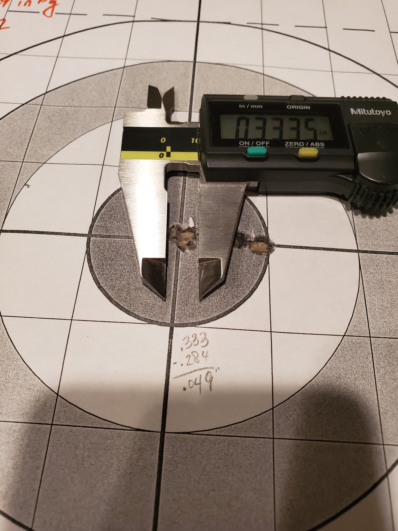

Just walked back in the door. It outshot me, that's for sure. I was testing loads, so naturally some grouped better than others. I'll post pics of some of the better groups by tomorrow, which (unfortunately) will include a couple of oopsies that were on me.
Well, here they are. My first and last groups of the day (I tested 10 loads, running RL-33).
This thing will do its part, even if I didn't do mine. The first two off to the right were my first two shots of the day, after zeroing with a load from another gun... which sorta wrecked this one, although I think I can safely say that's me since the next three keyholed:

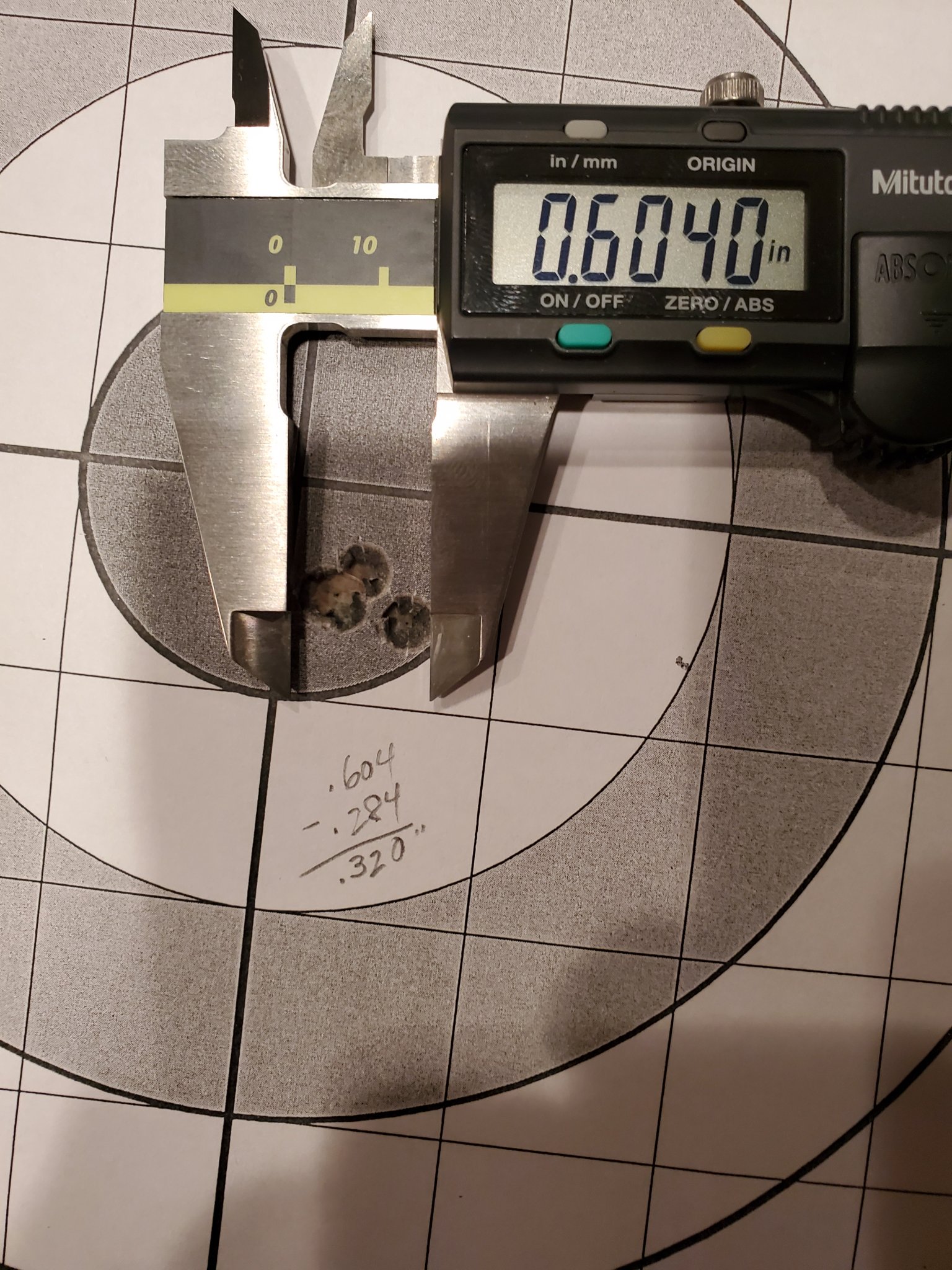

I did a little better on the last test group (although in fairness, it was only 4):
