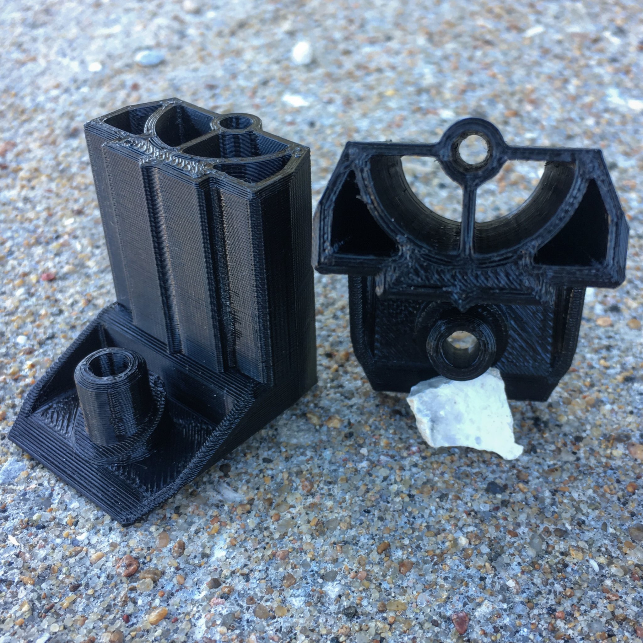

After seeing a thread in another subforum regarding 3d printed Labradar sights, I've refined the design for durability, minimal material use, and a slim approach to fit in the case which I'm told does not have a lot of extra room.
Here is my latest prototypes right off the printer, came out great. These are made from a strong, modified PETG, although I have also made some from polycarbonate (tougher yet), and our own blend of carbon fiber/nylon we get extruded which is very durable and has a damn cool look to it.
I'll give a handful away as testers, with the prerequisite you pay shipping and give me a timely report back on fit and function.

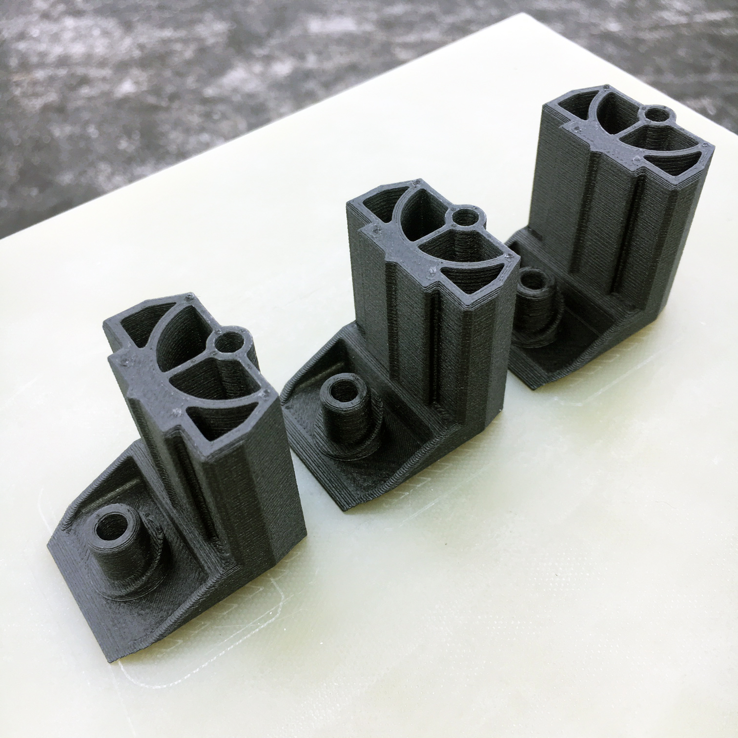

They're perfect. Gonna be mid-$20s from our custom Carbon Fiber material, which I believe you'll find not only extremely strong but aesthetically pleasing as well. Unless folks are familiar with printing, they usually have no idea how the parts are made from this material. $17.49 intro price, will make another post once I take some better pics, available here:

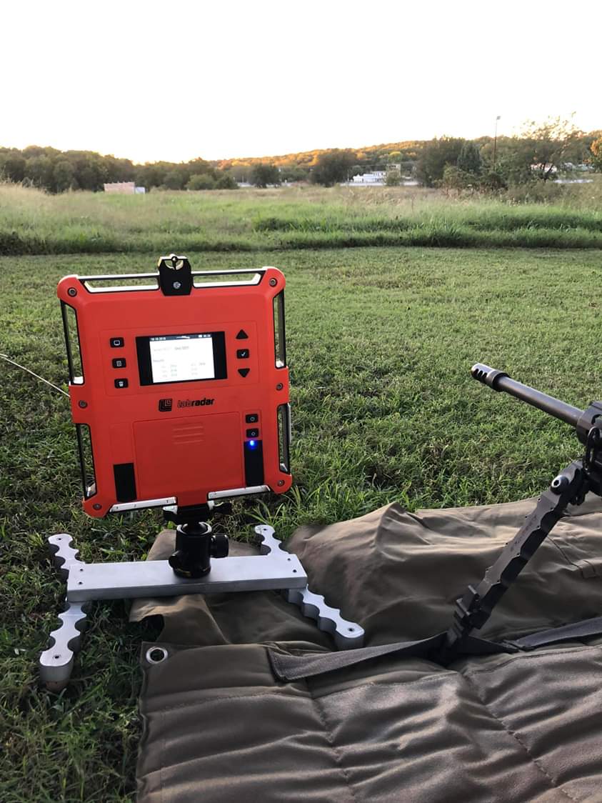

This is a final prototype I had sent to a member on here for testing. These will ship with the correct bolt style, rather than the hex head you see in this pic. Also, prototype picture is polycarbonate rather than the carbon fiber material, the carbon fiber stuff is a nice matte/satin finish and real slick looking.

Sweet! Does the whole unit still fit in the padded case with the 'sight' attached?
I wish I could answer if it fits, but I cannot. A customer delivered his Labradar to me in his own padded case that was not a Labradar one. Worst case you can pop it off in about ten seconds max.

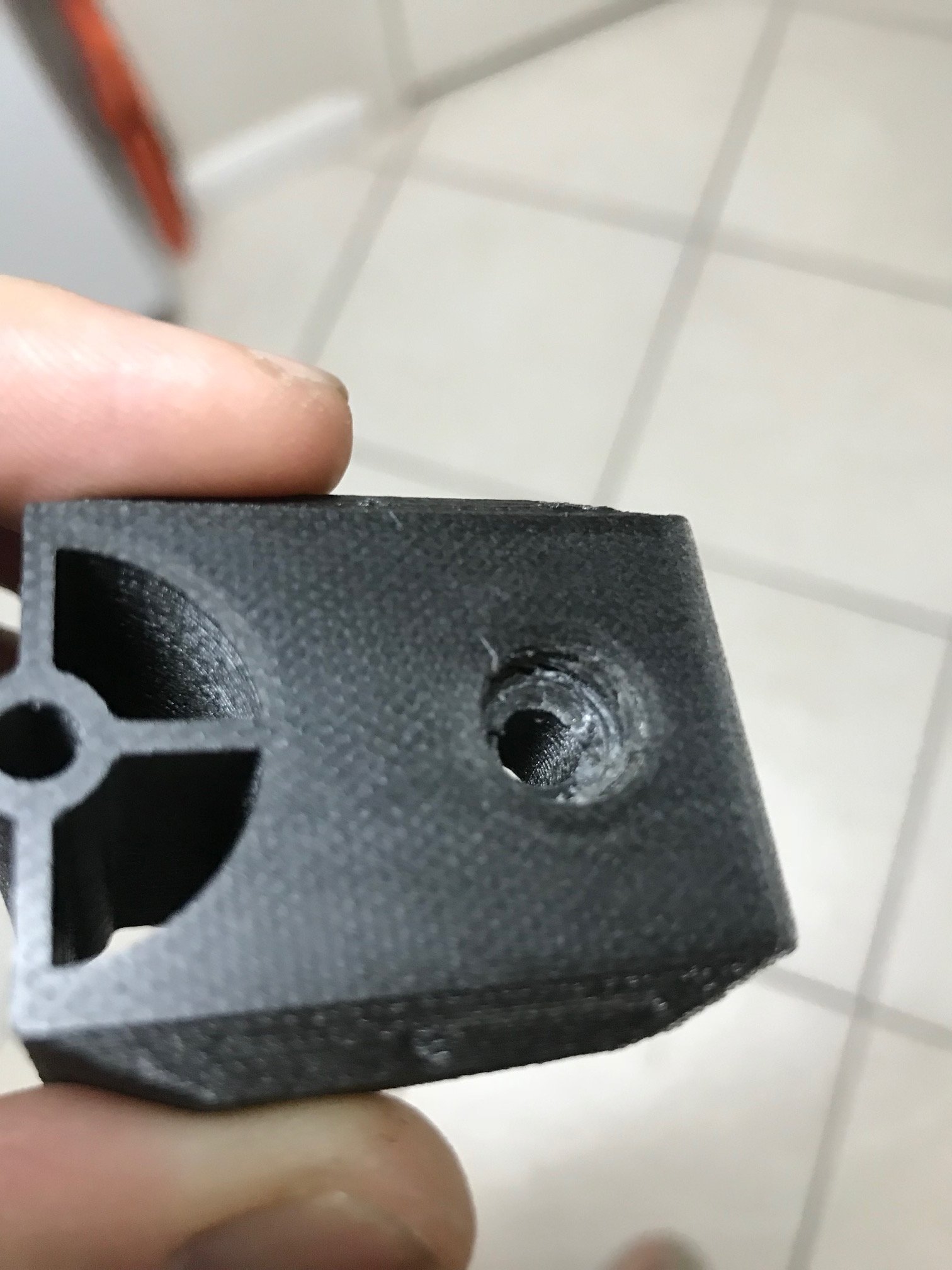

Got mine in today and just one issue so far. My supplied fastener wouldn't reach the threaded insert in the LabRadar. I had to deepen the channel a little bit on the sight to allow the bolt to reach. It was super shallow. Hit it with a drill bit.. Not sure if it was just my sample of one with excess buildup of material. Easy fix nonetheless. Just giving you a heads up if this small issue is across the board.
Interesting, the m5x35 bolted into my "tester" labradar a customer dropped off. How much depth did you add to that counterbore? Will either add a longer bolt or make that deeper! I assume there is plenty of threads or space behind them.
I also had to counterbore by ~3mm for the tall/ arched non MK-LR sight using the longer m5x35 bolt. Also no biggie.

The sight is neat, let’s discuss the base in this picture.
I had to do the same thing.
I'll make the counterbore deeper. Sounds like the labradar I was using for a tester is the odd man out!

Couldn't wait for the Black Friday sale @Tyler Kemp ... Just placed my order. Will the products from here on out have the counterbore deeper?
We've been sending a 5mm longer bolt ever since the first batch. The bolt heads sits just a hair proud, but it leaves the sight much beefier in that counterbore region so it was preferable for me.
