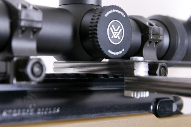

RevZ - I read through your description of using feeler gauges and maybe I'm just misunderstanding your process. But you make it sound like you insert the feeler gauge ON END (blade vertical) through the slot in the pic rail. Am I reading that right? If so, that seems a really odd way to do it.
This is how I've always used the feeler gauges:

The problem with feeler gauge is the scope is leveled based on the bottom of the scope..... What if the bottom of the scooe isnt perfect 90degree to the crosshair elevation?
Second, IMO, if you level / mount your scope by what feels natural and level, then its absolutely impossible to repeat that process when you take your shot after the scope is mounted..... Same goes for the method in my OP, its impossible unless you have a scope level which is too distracting and takes up too much time IMO..... If thats the case, then id rather have my set up dead nuts level as in my OP....
