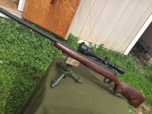

My M40 Tribute rifle
usmcchet9296

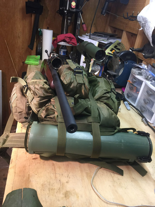

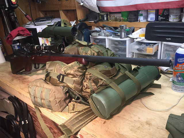

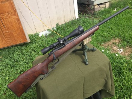

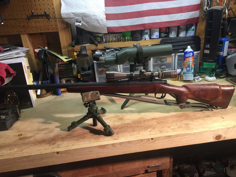

This is my M40 tribute rifle
Wanted something relatively affordable but with a wood stock so being a Marine I decided on a M40
The rifle started off a Remington 5R in .308 that was coated to look like it was parkerized
I added a Timney trigger set to 2.5 LBS
The stock is a Dep Taylor CNC's M40 stock with period correct buttpad and sling swivels
The scope is a Redfield/Leopold M40 3-9x40 sitting in a Badger M40 base
Added a period correct sling and did the finish work and staining myself
had the action pillared and bedded
I do have a Mark AR 6-18x40 that will have .308 calibrated elevation turret's that I will use to fully test the rifle out but when I shoot vintage matches ill swap out the Leopold for the Redfield
This is my return to bolt gun shooting after a long absence (kid needed tuition so I sold my bolt guns) and the pictures don't do her justice.....she is dead sexy

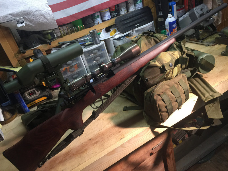

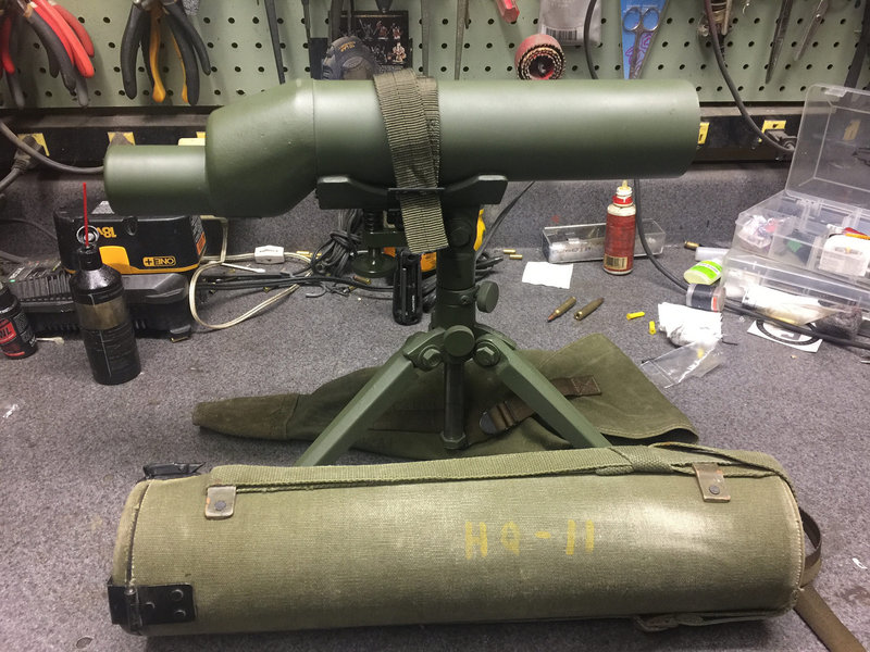

Here is my M49 spotting scope and M15 tripod
when I first got them they were pretty raw so I restored them
the scope case is apparently a real old one and the spotter is old because it has a brass id plate not the tin ones I've seen on newer ones
missing the front cap but hopefully one day I can find one or have one made

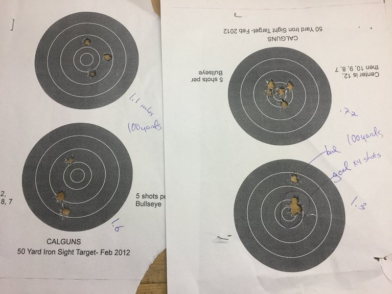

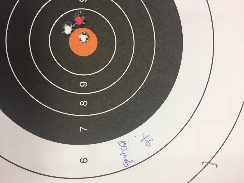

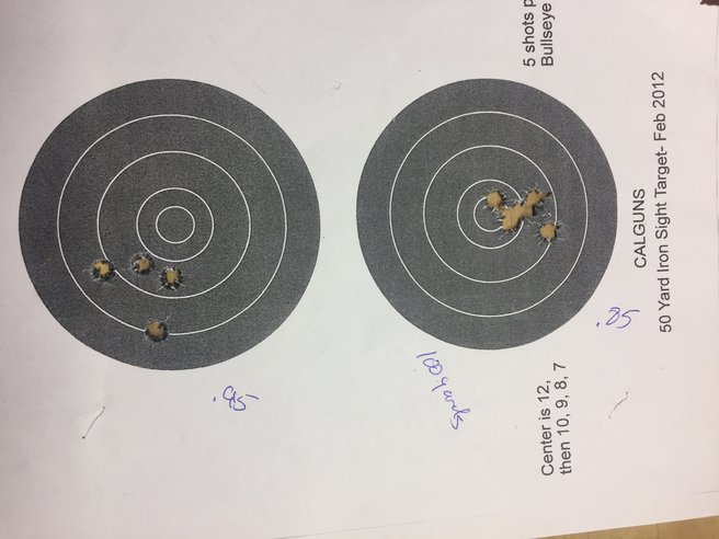

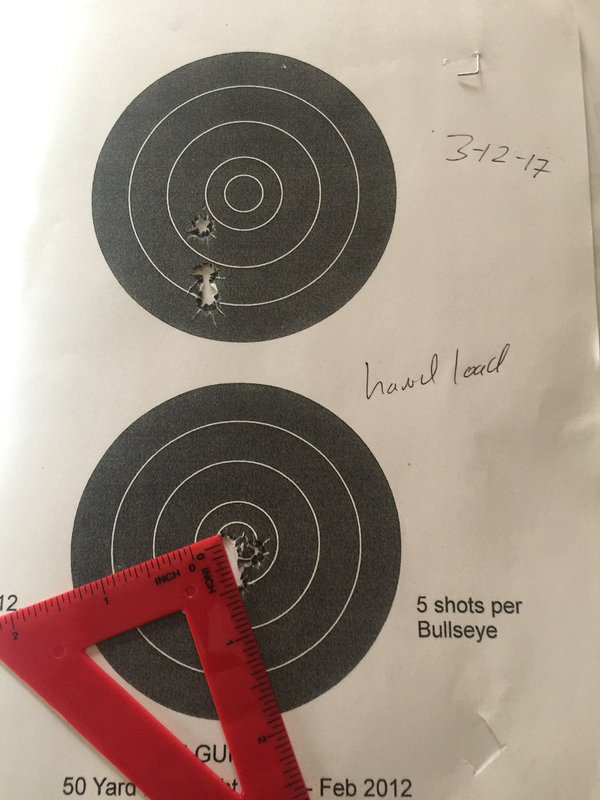

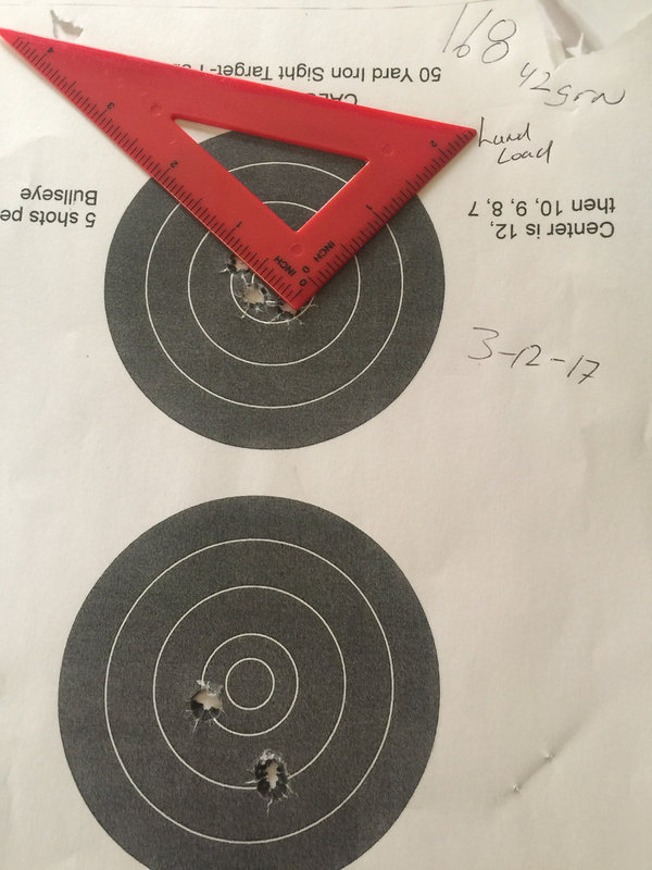

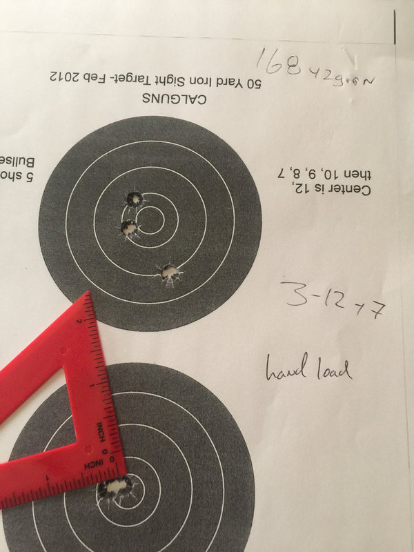

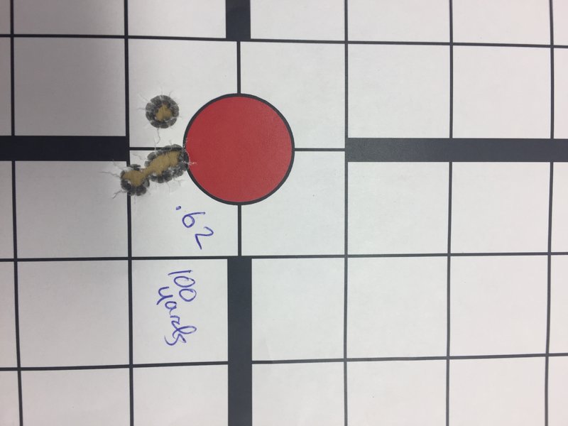

My first shots with my rifle
shot off a ALICE pack and rear bag
these are my hand loads
I would say as it sits this rifle is a 1/2 to 3/4 inch shooter maybe more if shot from a stable bench rest

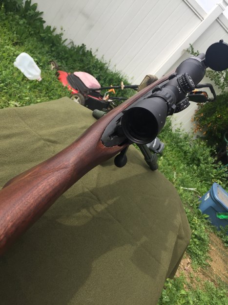

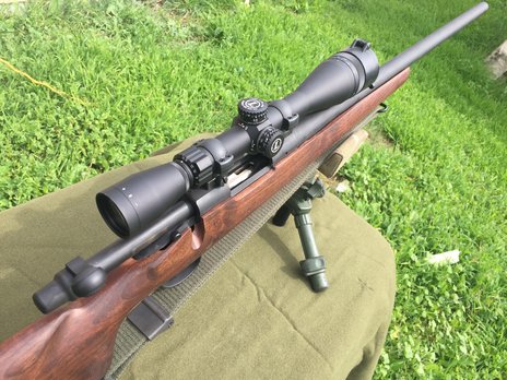

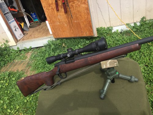

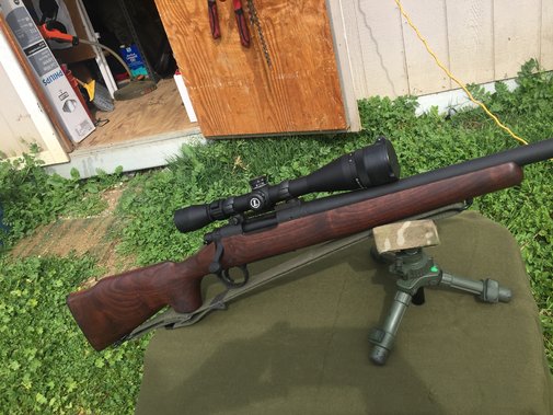

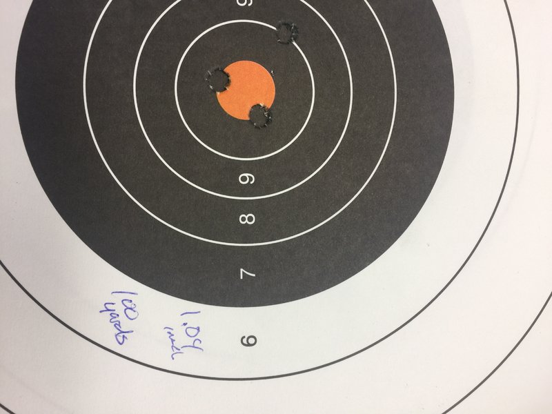

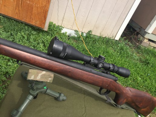

Some daylight pictures with the Leopold 6-18x40
