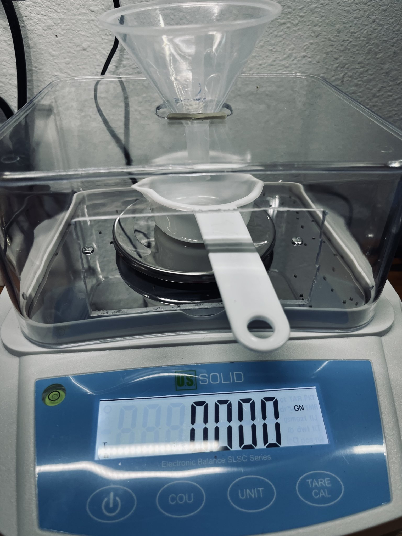

I had to make an extension for my Frankford Arsenal trickler. The US Solid scale has cut my SD in half.

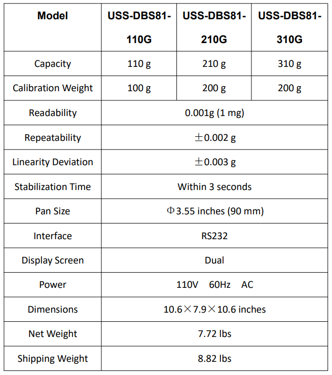

I wasn't familiar with that scale so I had to look it up. How do you like it in terms of response rate, does it respond to trickles or do you have to wait for it?
It looks very inexpensive compared to other scales.
https://ussolid.com/u-s-solid-0-001...b_-5zST_-drE34HtP5iFocO_MzoG_yBcaAqQNEALw_wcB
I only load currently for 308. It works well for me I normally wait a few seconds and go slower when I am approaching my target number. It goes out 3 decimal points and sometimes I think maybe 2 would have been better but I am happy with it.
I bought a piece of plexiglass at home depot and drill a hole for the trickler. Waiting on supplies and will be loading up again. Going to try lapua 167 gr Scenars.
This is how I modified my existing plastic cover, I use tweezers so no need for trickled tube
Reactions: Sniper6Creedmoor
Is everyone throwing then trickling up with these? My intellidropper is about to get on my nerves, so this might hold me over until I find a V3. I might just grab a fx and use it the way it is while I wait also.
