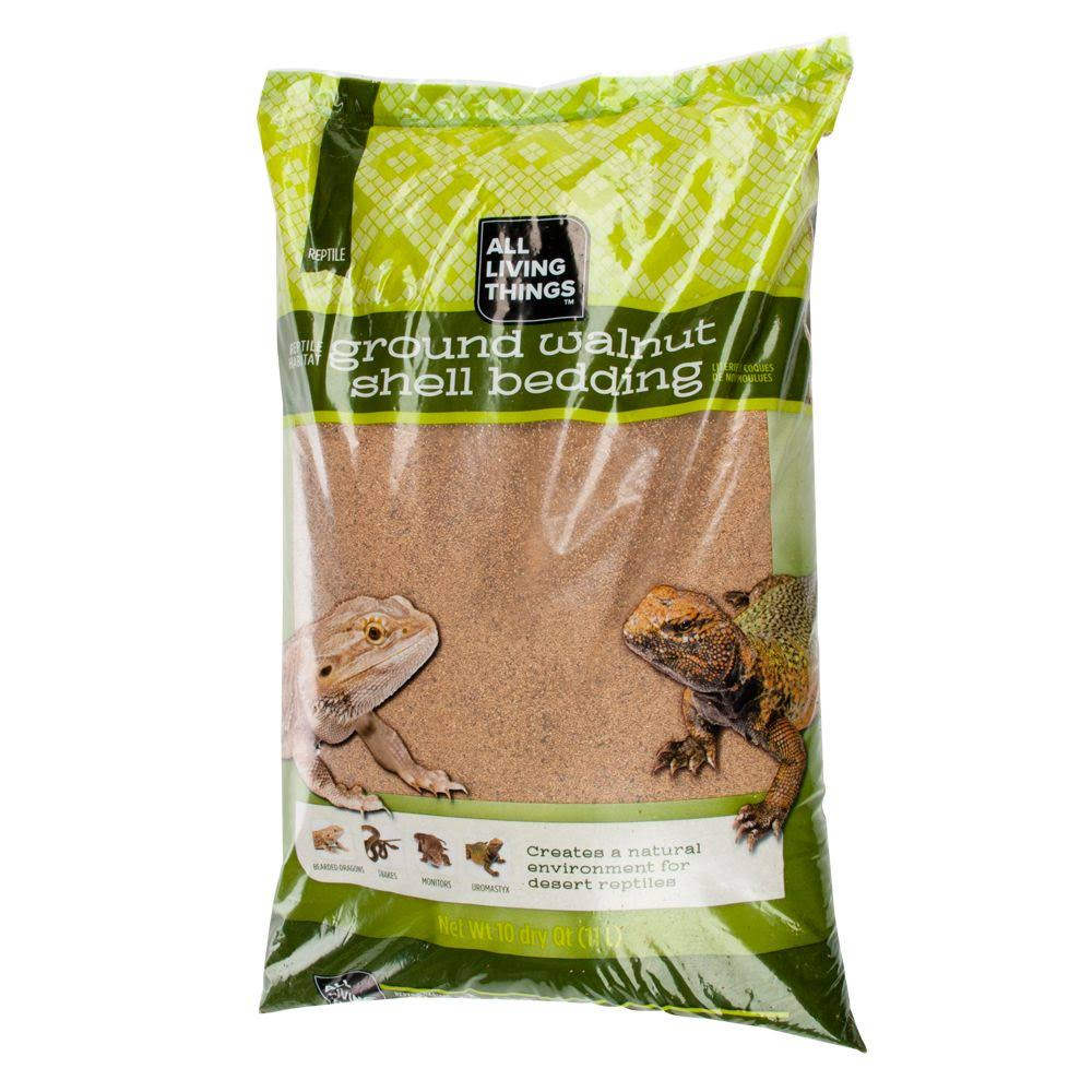

    I just use a lyman 1200 vibratory tumbler that I got on sale and its been fine, 100 308 sized cases isnt a problem with it. I got the solid lid for another 9 bucks from lyman directly to eliminate any dust coming through their default sifter lid. You dont need a super expensive tumbler. I would tumble the once fired brass unless you know it was cleaned before. You spent a bunch of money on some nice dies, dont feed them dirty brass and scratch up the finish on the die internals. I deprime and scrape the primer pockets but scraping the pockets can go either way, some do an some dont. I already have each piece of brass in my hands decapping, scraping isnt that much extra time to me.
    For the new lapua it doesnt need to be cleaned. It could stand to have the necks run over a mandrel as the factory neck tension will be a bit varied and way excessive but I have been known to just load 100 for forming to my chamber and not really give a shit about it not being exactly perfect (actually load them straight out of the box just about every time actually LOL, the difference between knowing how to do it right and just good enough).

    Not just that, but the grains of rice are so big, they are going to get dirty and need replaced much sooner than fine ground corn or walnut medium, and the last bag of rice I bought was more expensive than corn media.
    Yeah agree - maybe it's just the fact that I am more aware of how dirty the rice media is since it starts out so white, but I have tried it a few time over the years and always get pissed at myself for buying more rice- since you got to get the special kind and still looking at about 5 bucks worth of rice for maybe 10 batches of brass.
    Yea, I got a container of the Lyman corn media. The grains were much smaller than rice, but much bigger than what I was used to. It pissed me off when it clogger up so fast. I tumbled brass for two days, then realized the gunk was just being spread around. I think its the Frankfort arsenal corn media I use, but the smaller the particle, the more surface area, the longer it will last.
    My rice does get dirty and caked in black residue but I havent noticed it doing so any quicker than how long it took the cob media to turn black. And even when the rice is 90% coated my brass still came out just as clean as when the rice was new. Maybe I need to pay better attention or get some new cob and see side by side myself but I will say I like how much less dust there is with rice compared to cob and that I dont have to clear 50% of the primer pockets, rice has me down to maybe only 5% being blocked.
    Sounds like your corn cob media is too big. Find something with a finer grind. I am not talking about color change, I am talking about the point the media becomes so caked it no longer cleans the brass. I don't get more than 5% flash hole blockage with the corn media I use. I did with the Lyman media though. It had about twice the surface area of rice. Obviously the media used for tumbling is not pivotal in making good ammo. Each one has its advantages and draw backs. I like a fine ground media because it lasts for a very long time. I like to use what is cheapest in non important functions.
    Thats exactly what it was, the lyman jug green cob.
    Ill try and locate some finer cob when I run out of rice but that might be a year or more. Wish I hadnt dumped it into the old range brass storage carbon dusted container other wise I could eat my way through it much faster
