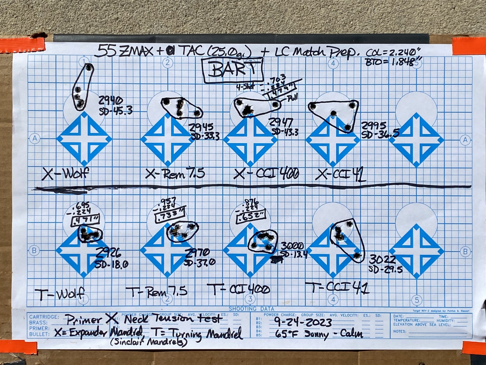

Decided to test one of my best loads with neck tension and primers as the variables instead of powder charge or seating depth.
Cases were all the same year of LC, annealed, trimmed, flash hole deburred, resized, then neck tension set with my Sinclair expander & turning mandrels mandrels. The turning mandrel is .001” smaller in OD than the expander mandrel, so it gives more neck tension.
The primers are what I had on hand…. Wolf SRP (original load development done with this one), CCI 400, CCI 41 and my favorite REM 7.5.
Accuracy was definitely better with the turning mandrel, mainly eliminating flyers. I’ve also noticed the same with other load developments with other powders and bullets over time. Slightly higher velocities were also pretty consistent with the higher neck tension. As for the primers, other than CCI 41’s being hotter than the rest, not sure if there is a real pattern…
I may run this test again sometime with one of my good loads that use a stick powder vs. primers and do 10 rounds each and see if there is any difference.

I did one with 223 and win primer vs cci 400 and got absolutely zero difference in group or speed. Never tested wolf or rem against it but I did the same test with lrp in 6.5cm and got the same results. That ended my testing. That said, I only use cci primers and the same version for whatever the load was feveloped with. I would definitely switch if I ran out though
I think this post was good. Keeping himself honest, while learning.
Ill add that 5 groups of 5 shots, would be MUCH stronger, statistically. Still, well done for wanting to learn.
This simple test confirmed what I already knew about neck tension in my AR rifles, more is better.
I agree with the “not enough data points“ on the primer testing though, but this sort of testing is very low priority to me.
