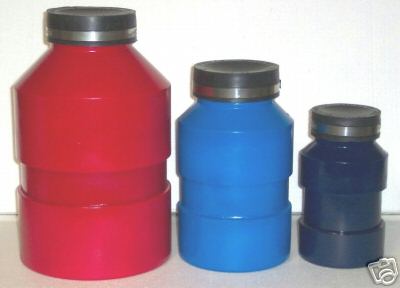

There is a reason that drum tumblers have flat surfaces in the ID of the drum. If you do pick a drum that is going to be round inside you'll need to fabricate some kind of baffles or the like to give you at least a few flat surfaces or something to that effect within the drum. Without the flat surfaces, the media/brass will just slide along as the drum turns and will never actually tumble. In other words, if you don't have some kind of baffle in the drum to stir the media up your tumbling time will be many times that of a properly designed drum.
Notice how the below drums have flat surfaces? The intersection of the flat surfaces caused the media to tumble. You need to either find a drum like on of these or add something internal to your homemade drum to interfere with the media. Personally, I would do the PVC idea and then cement in ~5-8 (depending on the OD) 1" tall full length ribs. I like your idea but in the end it'll probably end up having been cheaper to just buy a Thumblers Tumbler ( I have one and love it).

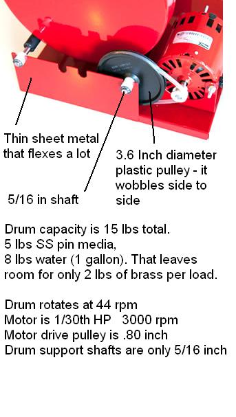

Look at the red Thumler's Tumbler Model B photo for reference.
One shaft drives the drum from the motor, the other just idles along.
I have a Thumler's Tumbler Model B. It works very well, but is limited to only 2 lbs of brass per load.
Normally, that may be enough, but I have many thousands of saved .223 brass I wish to process and I want a much larger capacity.
The Thumler's Model B is limited by its motor and the thin sheet metal construction

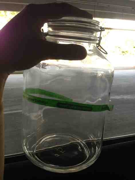

UPDATE: CAUTION USING GLASS!!! I have not had any time to reload or play in my shop for quite some time now, but I just got to filling my tumbler with a few hundred rounds of 223 and water for a test run. THE GLASS CRACKED within about 15 minutes of me staring at it. Too much stress from the brass smacking the glass.
