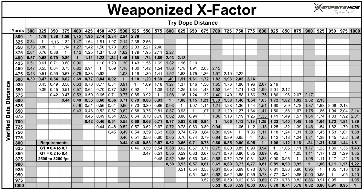

    How does one figure out a different distance which is not listed. Lets say i doped my data out to 800m, as Chris did in the video. He then wants to hit a target at 487m. Do you have a defined process or method ?
    This example would have verified dope for 400 and 500m distances.
    Thanks !
    Yep, we just need to know what the constants are for metres.
    Paging someone smarter than me .... @Jack Master?
    Please see the post linked below. The constants are the same for Meters as Yards. We do not need new ones for meters.
    If you REEEEALLLYY wanted them they are shown below in the metric "Multiplier" column but the change is so small its within the error limits.
    I've checked if we need a Metric Version. Below is a short table to show you that if you use Meters rather than Yards for distance the multipliers do not change (or change enough to matter) If you use our standard poster/table and system and just use Meters rather then Yards for distance, it will work.
    This makes sense if you think about the system. The Multiplier is a relationship of flight time and distance and is unitless.

    If we put in 200 Yard or meters increments (200-400-600-800...) from 0-2000yds the Multipliers change by less then 5% (0.05) At these ranges this is pretty darn close for a guess at doping your rifle out.

    This is a list of the X-Factor to go from range to range. In your example you would take yout 400m dope and multiply by 1.4. (interpolated from between 1.34-1.45 show in the table below)

    Hello Everyone. I'm a metric shooter (MIL, mt) and about multipliers I found this: from value in MIL at 200 mt - to find 300 mt use 2,40 as constant to multiply for; for 300-400 use 1,83; 400-500 use 1,45; 500-600 use1,38; 600-700 use 1,30; 700-800 use 1,25; 800-900 use 1,24; 900-1000 use 1,22; 1000-1100 mt use 1,20. I try them on my 308Win and 6,5 Creedmoor, and with ballistics they work. I will try on shooting range, but I'm quite sure that will be the same (-/+ 0.1 as said). I hope this could be useful.
    Thanks but this wheel doesn’t need reinventing.
    .1 or 1/3 MOA is meaningless but thanks for your input.
    The sheet, as designed, will serve you well and has the verification of hundreds of students’ data.
    Press - Break - Freeze
    Taylor

    @Enough Said - Hi Marc, hope you are well.
    I rather like the table that Jack Master posted above and I have your updated worksheet for the Sep clinic at Mifflin.
    As we know, we shoot uphill at Mifflin, in particularly from what...about 700 yards and out??... therefore our dope from the math were a bit high.
    But, if we LRF and get the horizontal distance (like most LRF can do) and use Jack's sheet for multipliers at ranges other than on the even 100, if that would work out. Be interesting to at least compare the straight weaponized math results with those based on horizontal ranges.
    Cheers and travel safe. I'm very much looking forward to another great time in PA.
