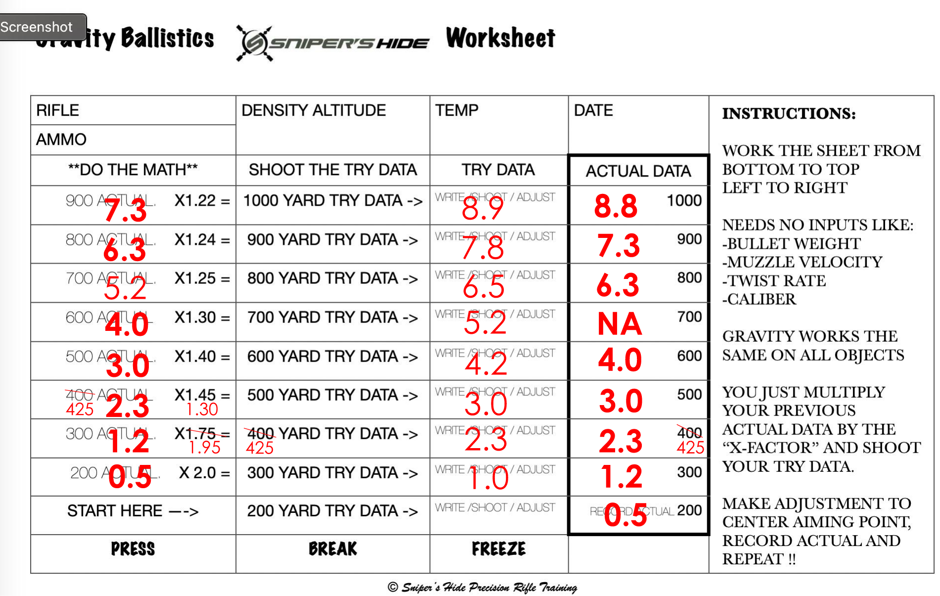

Advanced Marksmanship My "Weaponized Math" now called "GRAVITY BALLISTICS". NEW Worksheet Attached.
It’s used to dope a rifle, not act like an App, although an App is coming so you can use it that way with it.
you have a starting dope, the try, then you have an actual. You are walking it in but it’s less than .3 if you do it righT.
then that new actual is multiplied, when you are done, you have numbers to True your computer because they are PreTrued in one shot.
in a pinch you can use the multiplier but I would not at 1000 yards without some idea of your ballistics, especially using just a 300 yard number. If you were running 2850fps or higher you could trust the numbers better but not 2700fps numbers, they start to fall off inside 1000 so it will require more curve, the numbers aren’t that, but in the App coming you can change it for your rifle if you want.
we change the numbers for angles too, like in PA they have a 17 degree angle to 1000, gravity ballistics won’t work without changing the numbers to account for the change in gravity because of the angle.
it’s about context,

TRASOL says MV at 1,000 yards for that given DA is 1460 fps and try-dope should be 9.06. The ACTUAL dope I needed to hit my target was 8.8.
You can’t even answer the question I asked, which was, what is the MV at 1000 yards, the left over number, you already posted your dope, 9 is not fast. Hell, Sparky her just doped her rifle with it and it was 6.2, that fast.
My muzzle velocity is the same at 1,000 yards as it is at 100 yards. What are you asking? Do you want to know my muzzle velocity? Or are you asking what my bullet's velocity is at 1,000 yards? It makes no sense to ask what muzzle velocity is at 1,000 yards or muzzle velocity at 700 yards. Or muzzle velocity at 865 yards.
My muzzle velocity is 2669 fps.

Here, look at your numbers if you did it correctly
7.3 x 1.22 = 8.9
you would have been .1 high
Right. I said that already.
You answered the question—you're releasing an app that will allows you to estimate/project DOPE using this method. But the worksheet isn't meant for that. Got it.
You are not a smart man, your muzzle velocity bleeds off,
2669 is not fast, at 1000 yards that around 1200fps, maybe less, hence the road to subsonic, where you begin to drop quicker so the math is not the same with a load like that past 800. That is what I am trying to convey so I can explain why you are seeing an issue past 800 if you don’t do the math each yard line with an actual hit number, vs a predicted number

200 Yards / DA: 1140 — 0.48 (0.5)
300 Yards / DA: 1300 — 1.2 (1.2)
425 Yards / DA: 1600 — 2.26 (2.3)
500 Yards / DA: 1200 — 2.97 (3)
600 Yards / DA: 1640 — 3.98 (4)
800 Yards / DA: 1900 — 6.31 (6)
900 Yards / DA: 2300 — 7.61 (7.3)
1000 Yards / DA: 2400 — 9.06 (8.8)
Put the electronics away. You will mess with that after you leave the firing line.
Follow the process.
You take your ACTUAL 800 yard dope, which is 6 correct?
Multiply that by the 8-9 hundred multiplier, which is 1.24.
So 6x1.24=7.4 TRY DOPE for 900.
You hit .1 high with an actual dope of 7.3
Take the 900 yard actual data of 7.3 times the next multiplier of 1.22.
7.3x1.22=8.9 TRY DOPE for 1000.
Your actual 1000 yard dope is 8.8
Like Frank said you would be .1 off.

Dude it’s literally a way (like rule of thumb between yard lines) to take any of the common precision rifle cartridges and get good hard dope to 1k with a box or two of ammo.
Shoot, adjust a tenth or two to true up actual, run the next yard line X-factor for try dope to get you on steel, adjust to actual and repeat.
No shit it doesn’t line up the way you did it, there’s a small error per yard line you’re supposed to correct for along the way.

I want you to understand how this system works - so here is what your work sheet should have looked like. Red is your Pen on paper at the range. Gravity ballistics was very close to what you needed and worked exactly like it shoot if we use it correctly. Adjusting for the 425 target is important. Skipping the 700yd target will double the error but still within 0.5mil.
