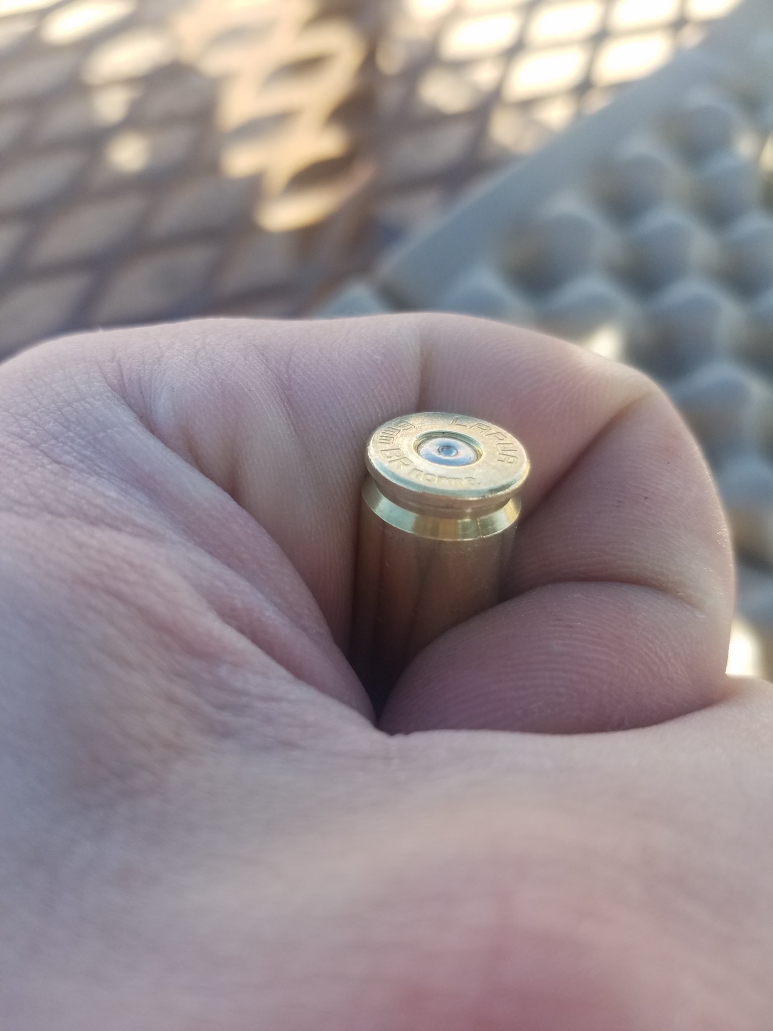

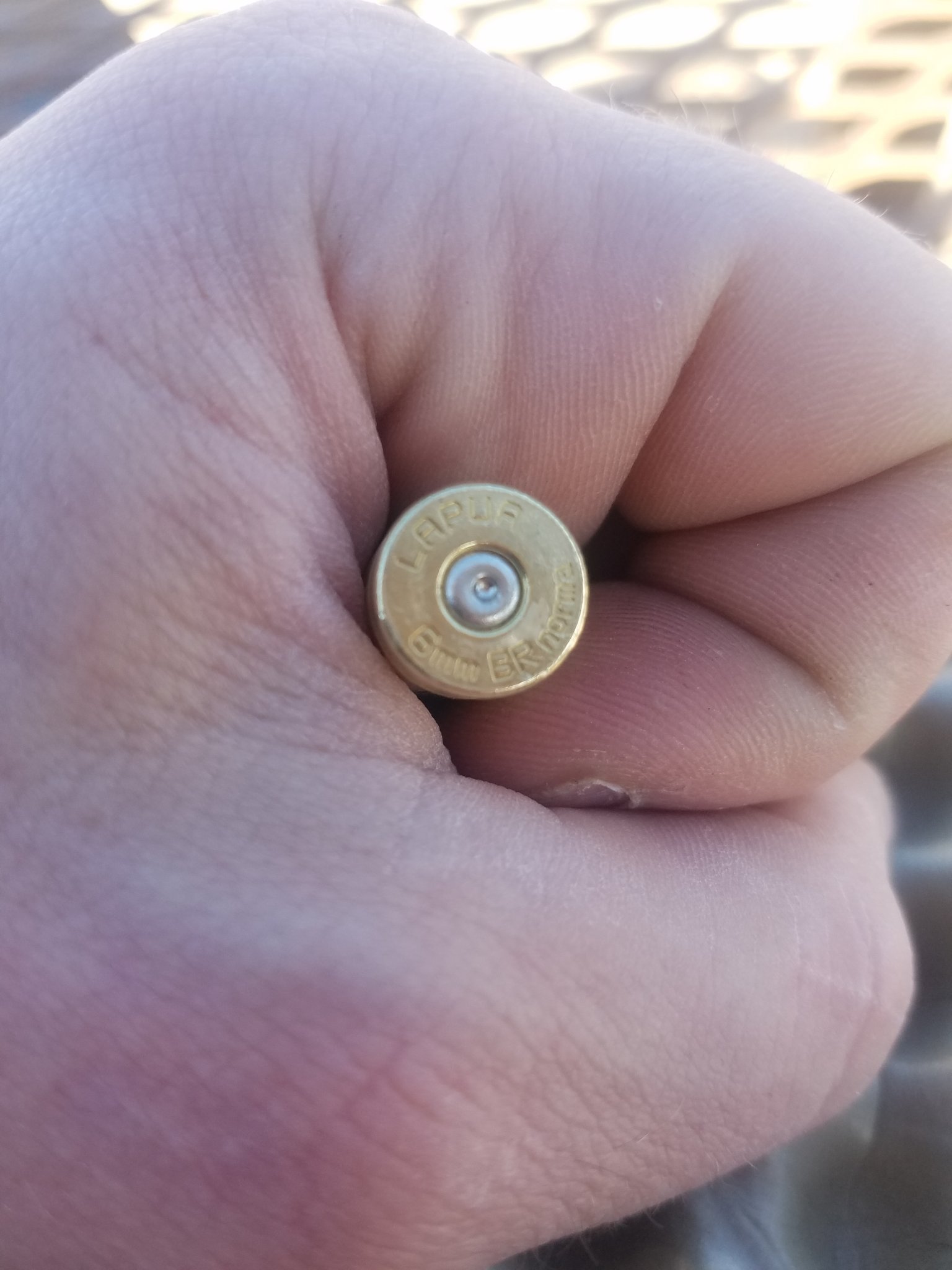

Found this thread problem-solving my TL3 as well. Have tried CCI 450s and BR4s in my 6 Dasher and same issues as OP.
50% won't fire. 90% of them will fire on a second or third trigger pull. Brass is new brass, hydroformed, and I didn't touch the primer pockets prior to loading. I have taken the bolt apart and there is no issue there. I seat primers will the Lee hand tool and all are slightly below flush. Here are some pictures of FTF rounds that won't go off no matter how many strikes.
