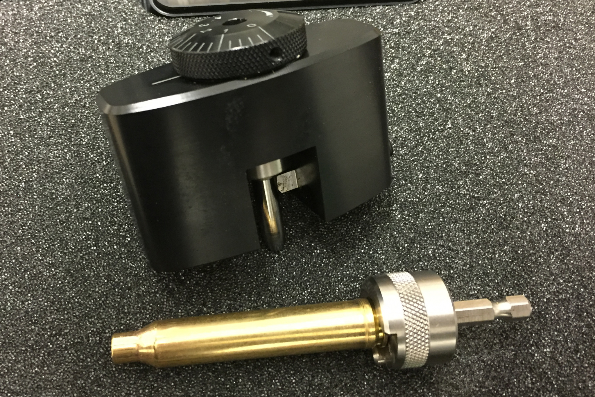

In this picture might be what you're lookin for:
7112363
R

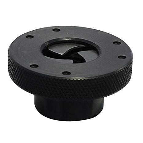

It's a Lee case trimmer chuck. I use it to push the cases onto the mandrel and back it off before turning. When they are done I wind it in, lock it onto the case and pull them off. The chuck is pretty light duty but there's not a lot of tension between the case neck and mandrel so it works fine.
7112493
