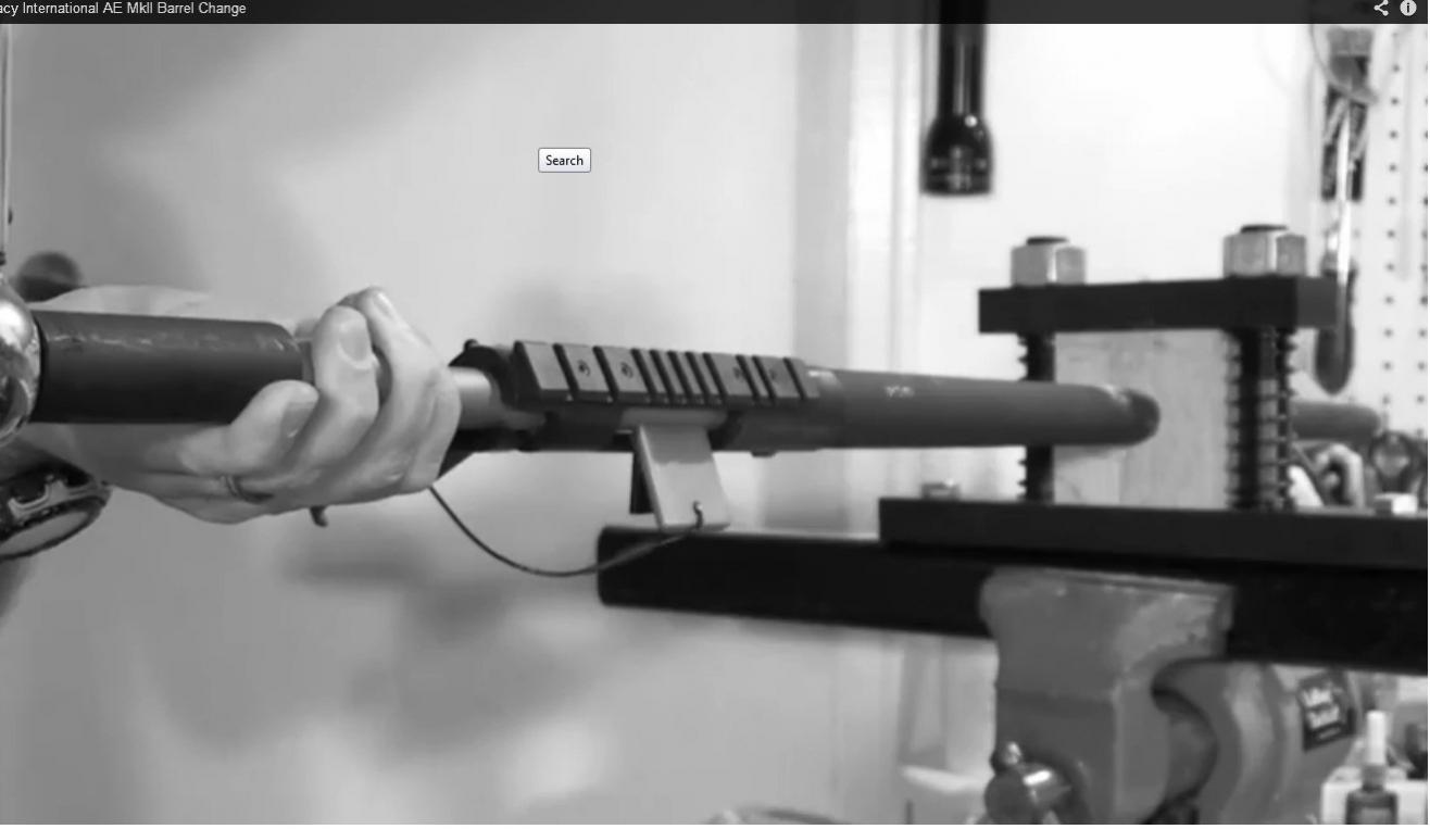

Here is my attempt to clear up this thread for all involved, disregarding the start of this thread on 09/12 which may be why the op has not responded.
- The weapon system on discussion is a accuracy international AE which is undergoing a barrel change process. To undergo a barrel change you will need a torque wrench for two steps in the process:
1. Installing new barrel to action: new barrel is in blocks, tightening action to barrel - this process requires a action wrench in he action and tightening the action to the barrel: this step requires a torque wrench capable of 100 ft./lbs. also per my action wrench it is easily accomplished with a 1/2in. Drive "click style" torque wrench with a deep well socket
2. Installing barreled action into the chassis. This step requires a torque wrench capable of 89 in./lbs. to tighten to ai's specs. The borka kit is not rated for this. I use a 3/8 in. Cdi "click style" torque wrench for this step.
Video for reference made by 8541 tactical: http://www.youtube.com/watch?v=tkz6M0ObSbY, also note photo is from the video
So when it comes to a barrel change on an aiae the borka kit is not applicable for the job at hand. However when it comes to mounting the scope it comes in handy and is the kit I would recommend for optics installation.
