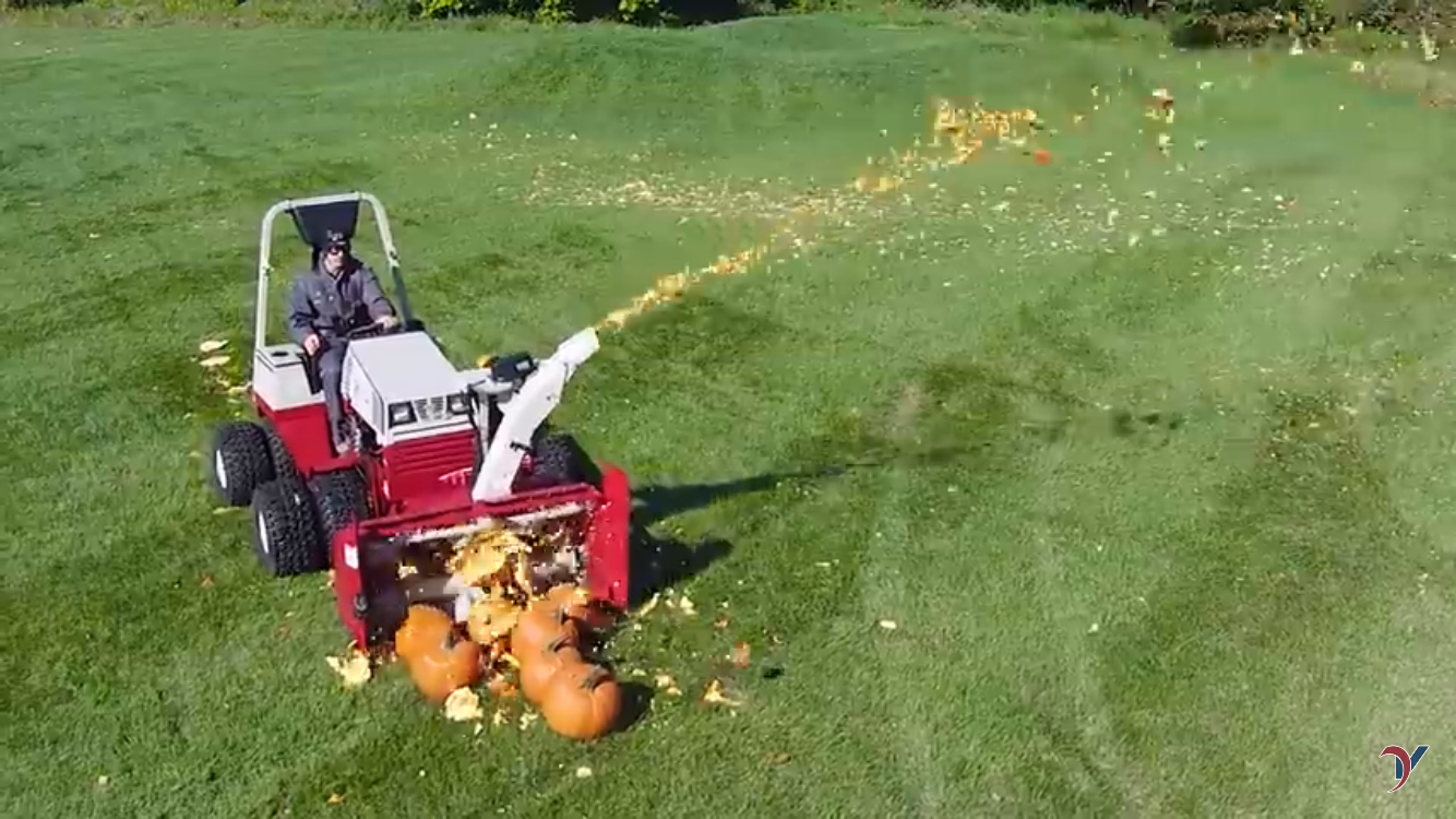

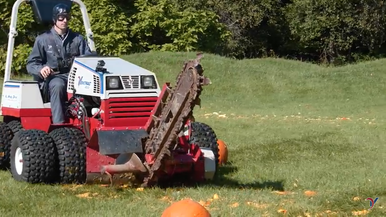

If you have to mow under or around trees or do any hills or slopes then get a Ventrac or a 4wd Toro Groundsmaster. Groundsmaster's show up on the https://machinerytrader.com/ site which is a good starting place. They also occasionally show up on local Craigslist but if they are in good shape they go fast. Ventrac's have a much smaller dealer base.
You can also checkout https://www.lawnsite.com/ for good reviews of commercial equipment.
ZTR's are great for flat smooth spaces but your ass cheeks will pucker on the hills and slopes. ZTR's also suck for mowing under things like trees or bushes because that usually involves the operator getting scratched or smacked up.
