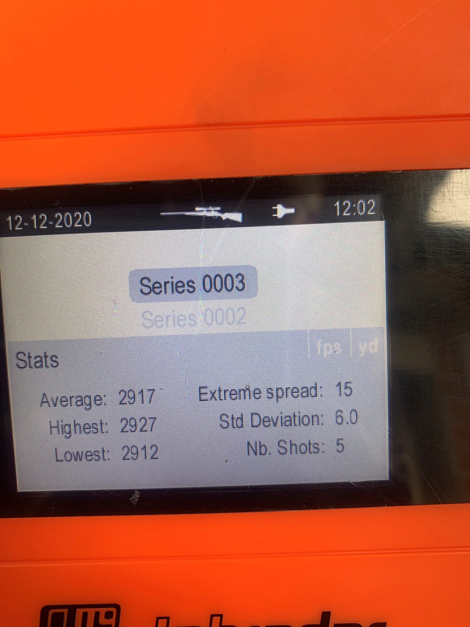

First off. The rifle actually shot well. It was shooting .2 inch groups at 100y. And the SD was 6.

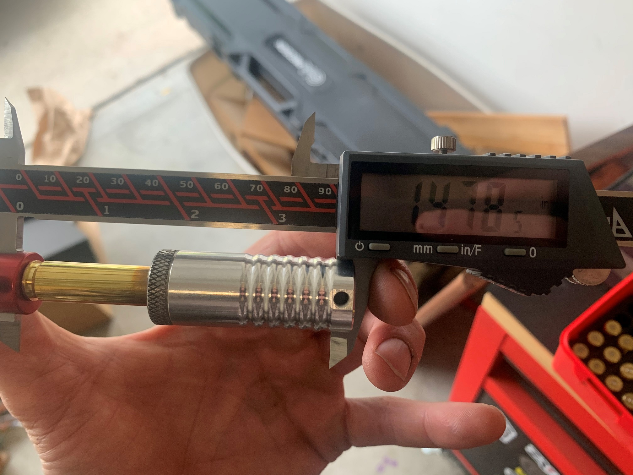

This is my virgin brass:
1.478

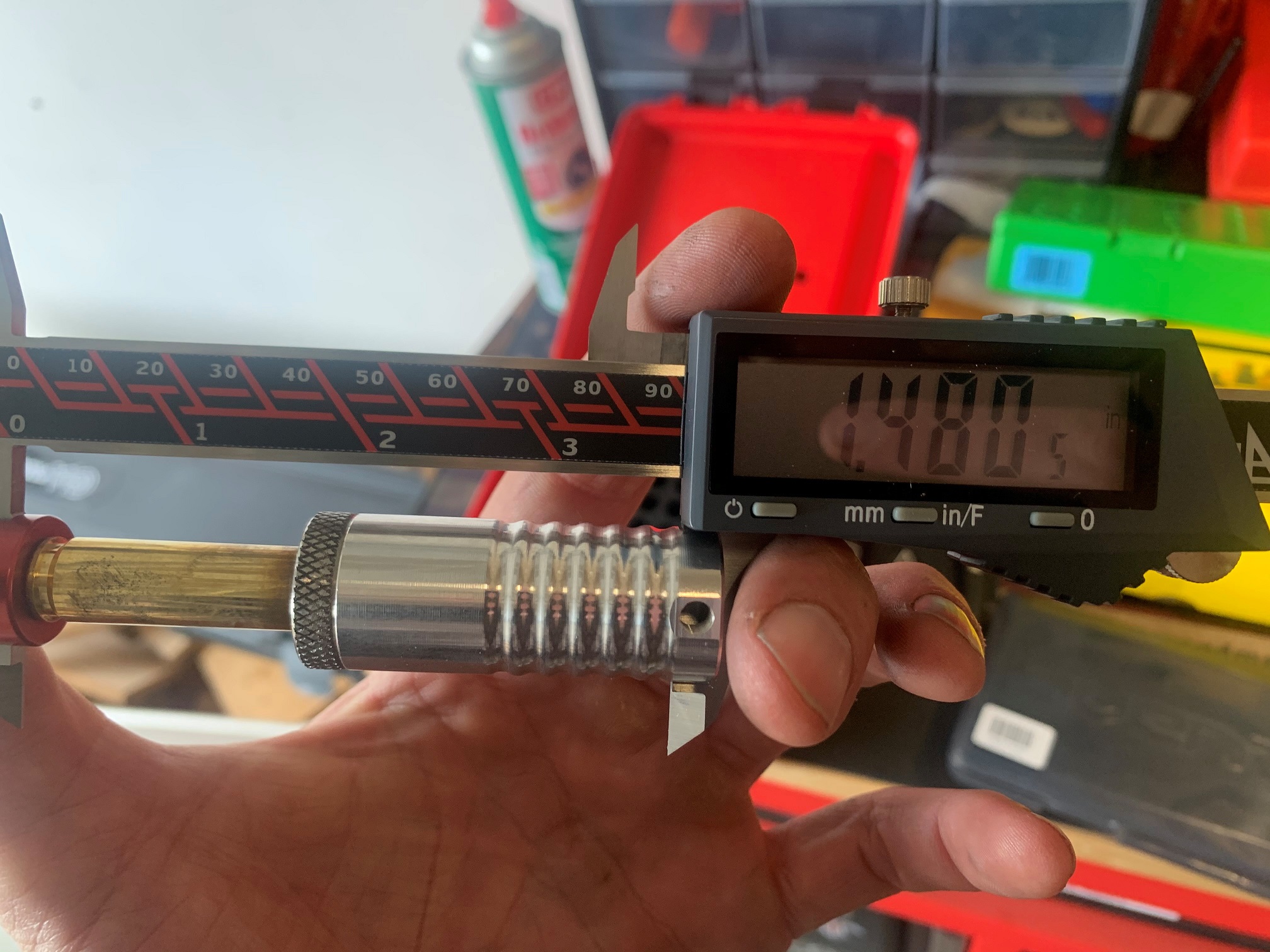

This is a fired case with a carbon build up on the shoulder and a little on the case body:
1.480 / .002 expanded over virgin brass

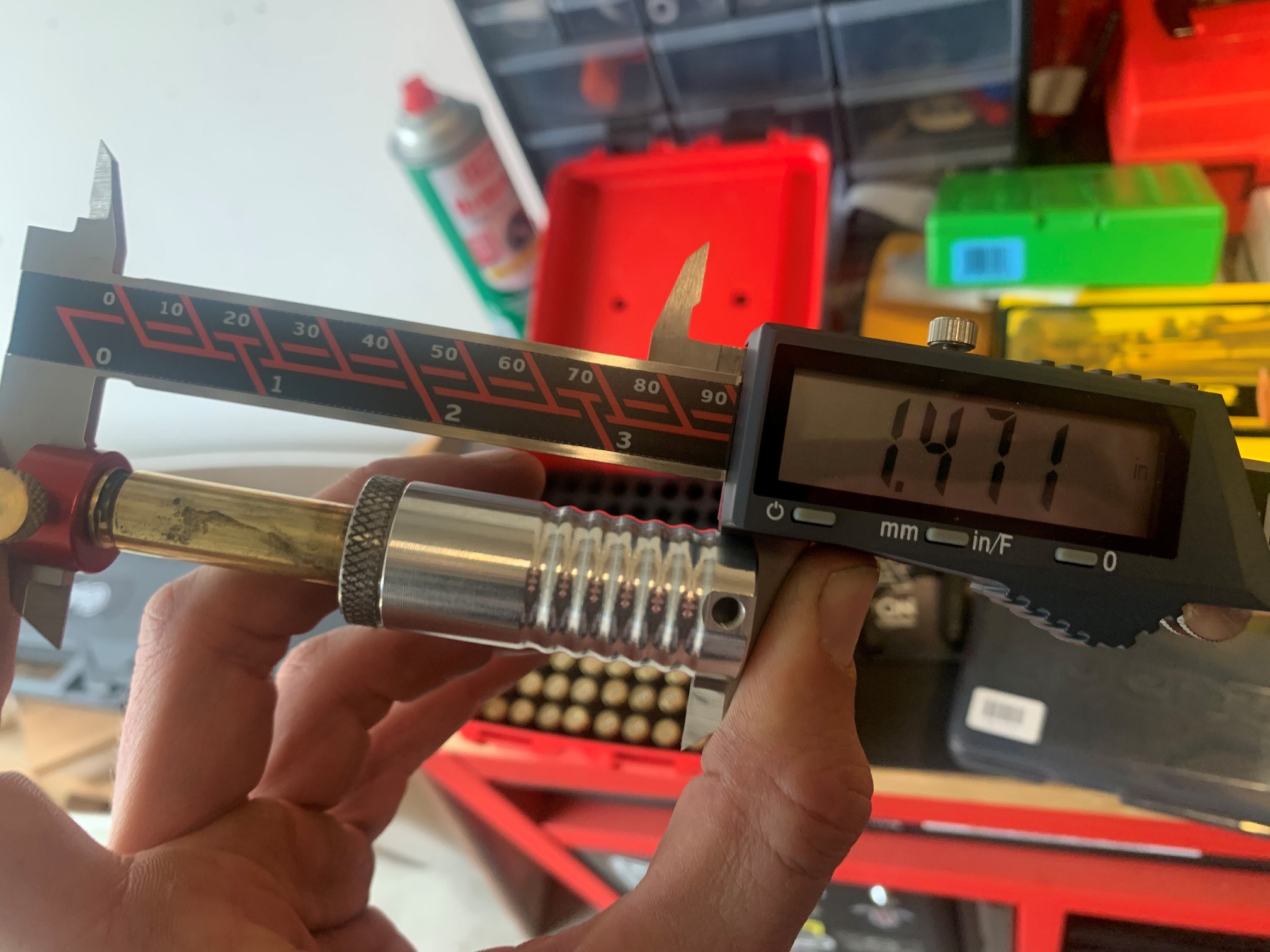

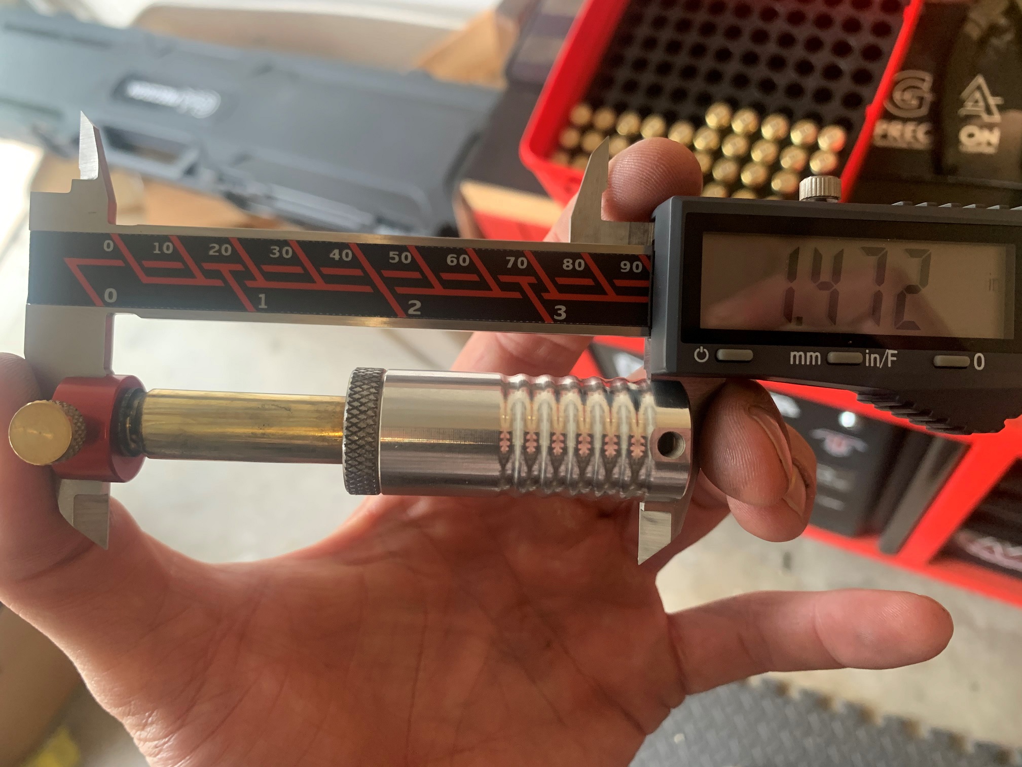

This is a fired case with carbon build up all over the case, even heavy on the extractor ring:
1.471 / .007 under the virgin case

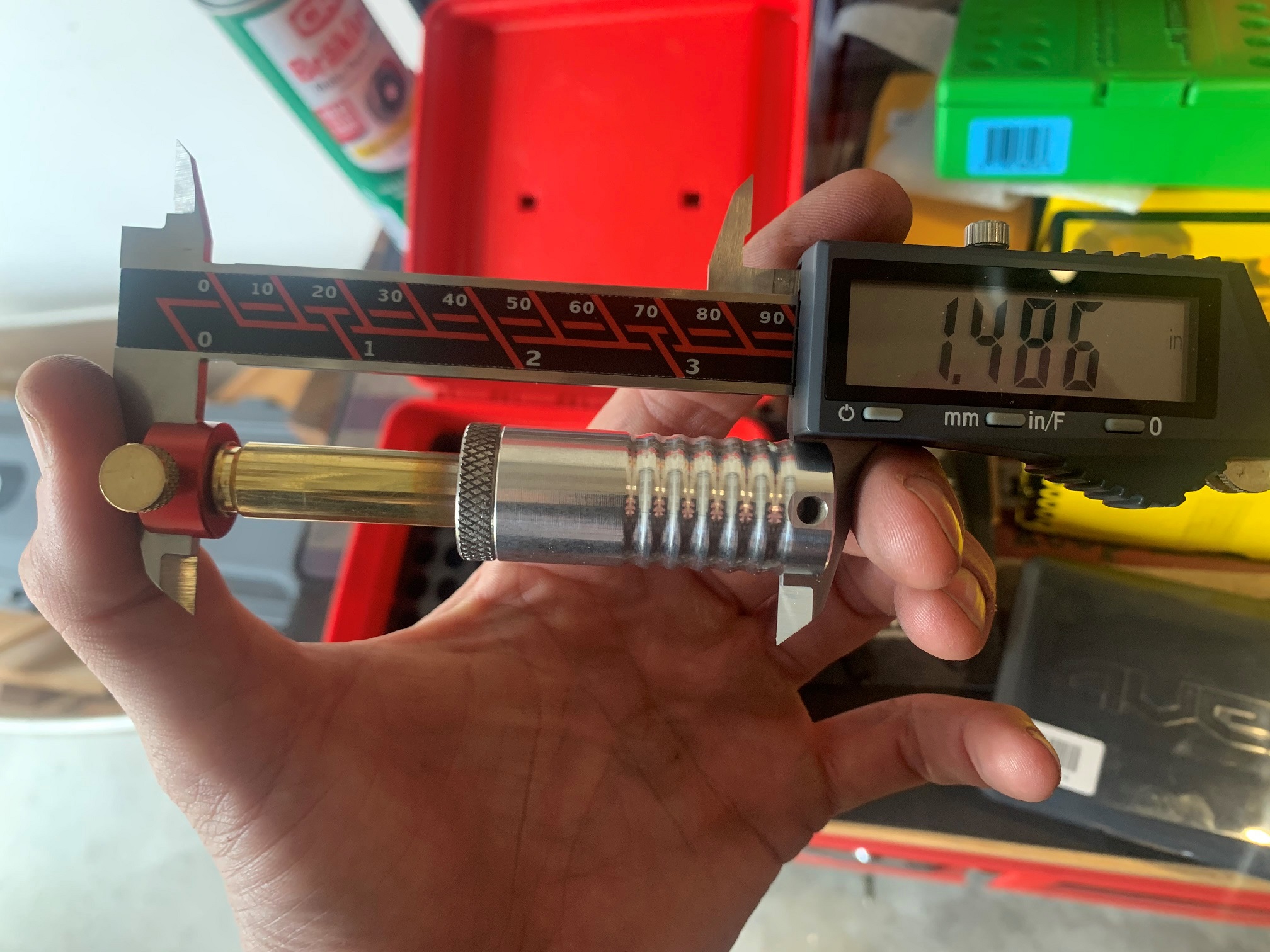

This is a fired case that came out clean:
1.486 / .008 over the virgin case
