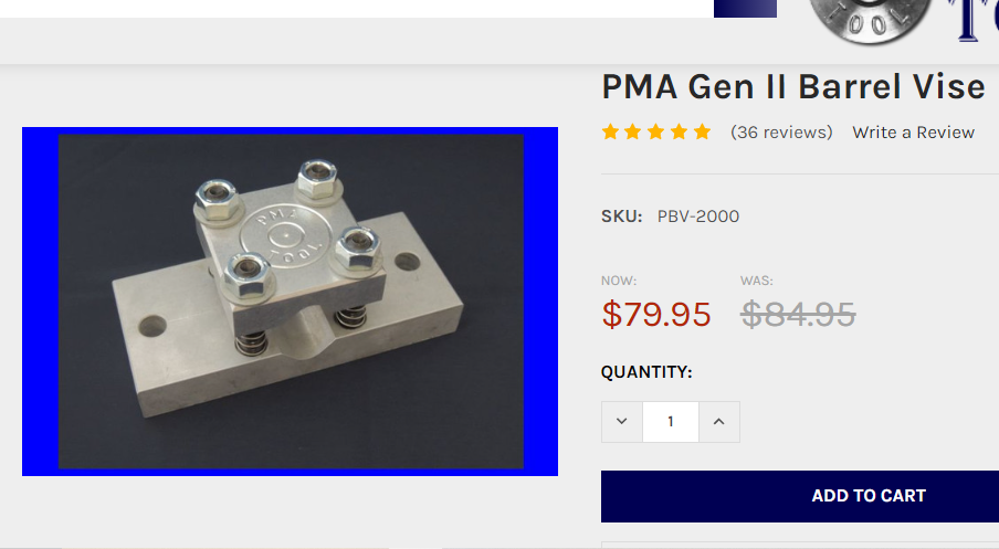

I use this vise as a portable unit with a c-clamp .It will hold factory barrels for removal without a problem.
