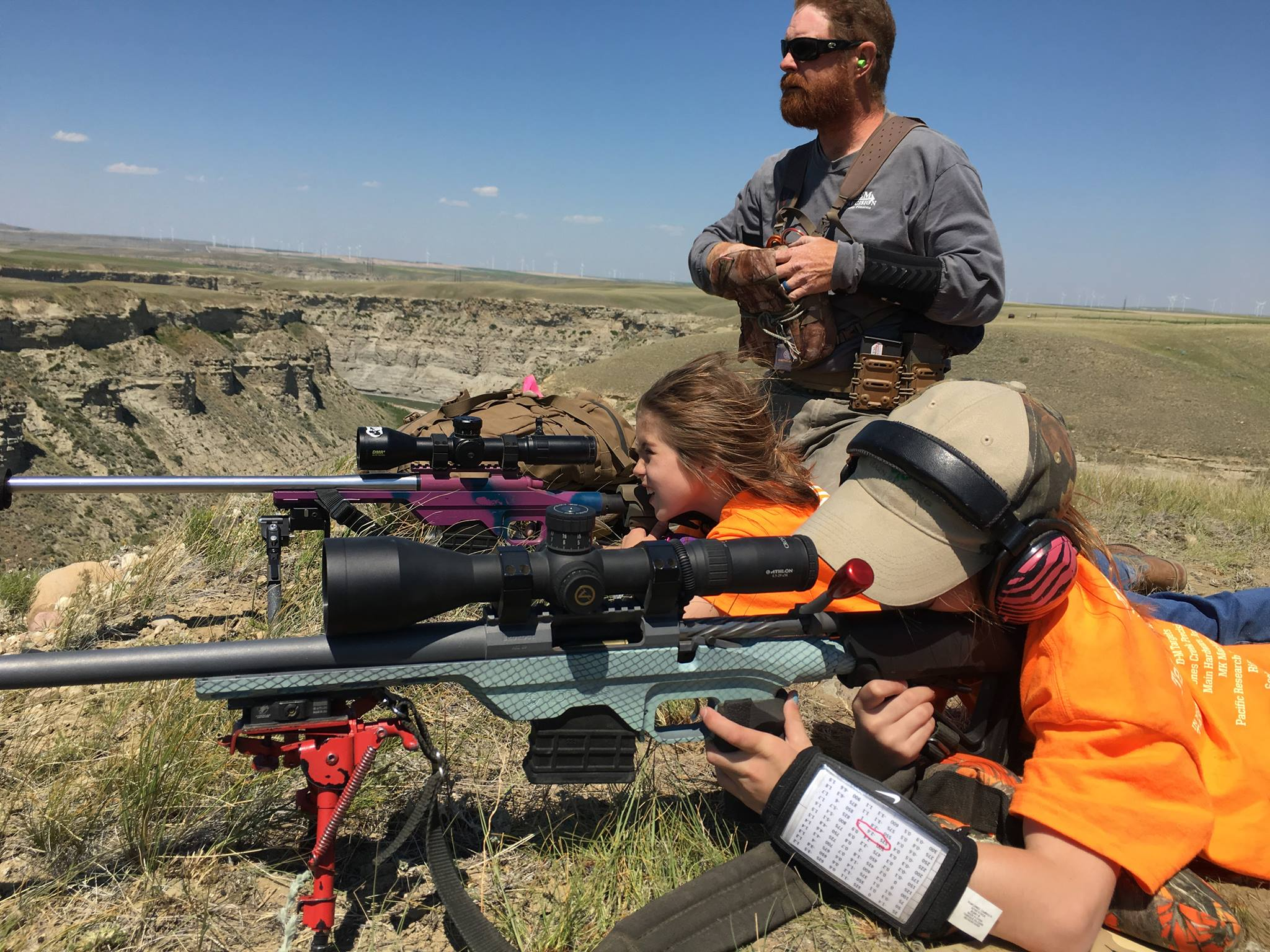

Our 2 girls each have what you are working on. They started at 7 and 8 with 223 custom bolt rifles.
One rifle has a medium palma, 1 has a light palma. To redo I would have used 5 contours and cut them short. Both have short Ti cans on them...
Stocks. Both started with MDT LS chassis with magpul CTR extension and cheek risers.
Older daughter has since moved to the XLR Element...
Both use the Masterpiece arms vertical pistol grip, the thumb shelf and shorter distance to the trigger are very beneficial. The girls really like the shelf, so much so we modified a MP grip to fit the XLR because the daughter really liked the shelf....
One prefers a 2 stage trigger, it was a huge help, the other likes a crisp 2.5 pound single stage. Both want to feel the trigger before it goes bang...
NOW
What we learned, and are still addressing at 9 and 10...
The guns still weight 13 and 14 pounds all ready to go... so they have a hell of a time packing them, even with short bbls they are almost as tall as the kid. They started to use Biathlon slings last fall.
They must sit up to reposition the rifles if they are shooting prone and if they are not balanced well on a prop, they can have issues keeping the rifle in place.
When you put the XLR on the rifle, it adds 1.5 pounds to the overall weight above the MDT.
Both daughters will have CF bbls on their rifles for the coming year, it took some weight off, but they are still a handful.
Make damn sure the bolts are smooth, and that ammo is short enough they don't need to add any pressure when closing the bolt. Lighter loads with zero pressure so the bolt always runs smoothly is huge
With help from the folks, our girls are very comfortable with the rifles and have had great success competing several times with them. They also pack them coyote hunting, but again the weight is an issue...
All things perfect, a final rifle that was 9 pounds ready to roll...

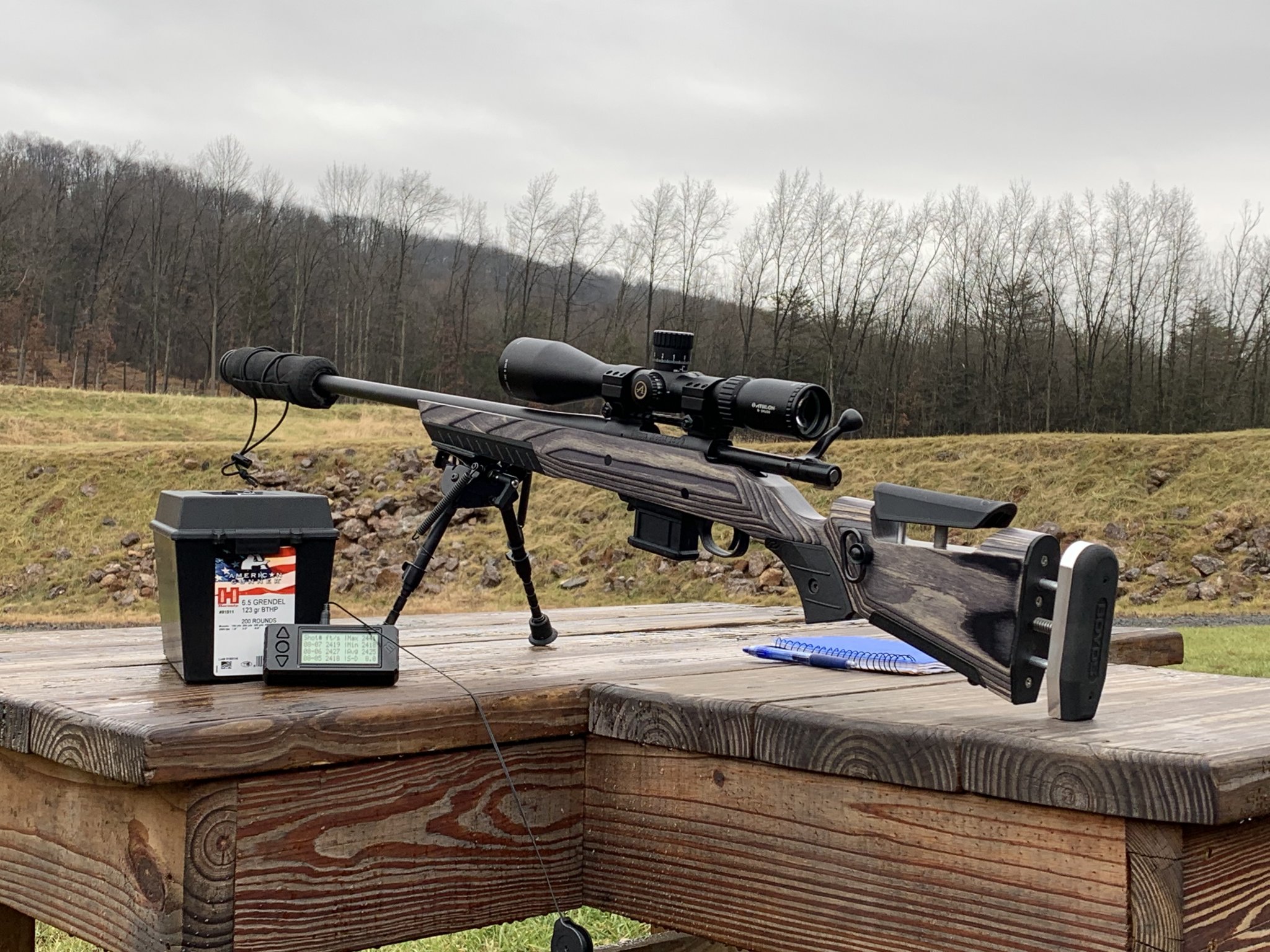

I built my son's .223 on an MPA Lite. Med Palma contour. The barrel was originally my trainer for my TL3, so it's same size & weight as my Dasher barrel; 26".
He will compete next year with a 24" long 6BR, which should make it a tad lighter and easier to weild. No can next year for him either. ?
The MPA Lite fits him well. He's 12 now. YMMV. Let me know if you have any questions.
