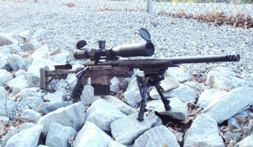

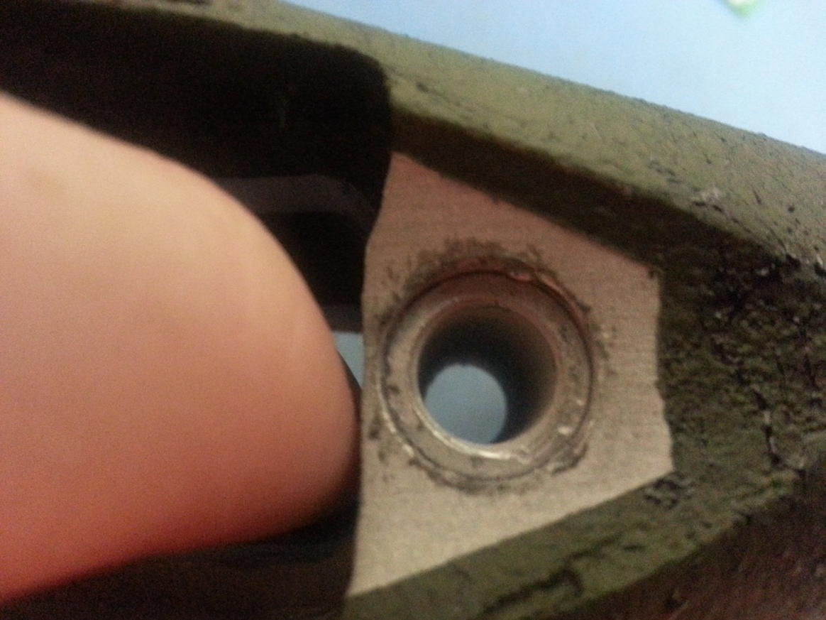

i just put my Remington 700 aac-sd in a b&c 1000 stock. dropped right in. the stock i received i was not all that happy with. ill attach a photo. i called bell and carlson and was told it would be about a 6 month wait to get a replacement. idk if i will buy another one of their stocks to be honest after this tho. haven't shot it yet. its not completely free floating either at the moment. i have to use quite a bit of force to get the paper all the way down the barrel. think i need to remove some material. the good news is the timney trigger dropped right in. absolutely no fitting required. set it at 2lbs and couldn't be happier with that. im hoping i get a chance to sight in the rifle this weekend. ill report back how she shoots with the new stock. ive never bedded a rifle before. maybe ill give it a go if im not happy with the groups. i have to admit. the stock sure looks good
good luck on your build!!

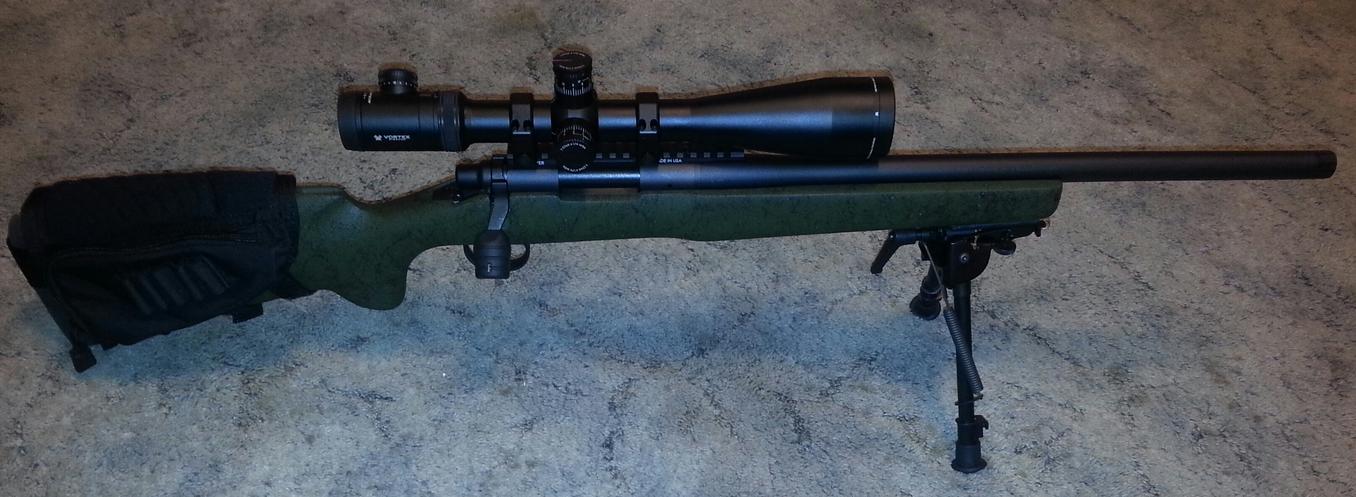

I have a Choate stock and liked it. Like others have said its not light, but felt very sturdy. It was a good stock to use while you are doing other modifications to the rifle so you can afford more ammo.
My one dislike on it (and only having one dislike on such a cheap stock is a huge plus in my book) is the sliding sling stud mine had for attacking a bipod. no matter how tight I cranked the bipod that stud would always drift as the rifle was shot, slowly moving forward do to the recoil. Finally I just drilled the slider and put a allen head setscrew in it and that seemed to do the trick. Also the model I had was very flat bottomed, which made the bipod not have alot of contact area.
For the life of me I dont remember which model my Choate was, I think it was the "tactical" not the "Sniper".
All in all for the price, I liked the stock. I used it to shoot while I saved up money and bought an AICS. If you ever want detachable mags, just keep in mind a good stock with bottom metal, and in-letting will cost you about as much as a chassis system. With the chassis system you buy it all at once and are done. With a stock you can absorb the cost in stages but might have the rifle down for months while the smith is doing the in-letting. So where the costs are almost equal, go with what you like, or what fits your timeline.

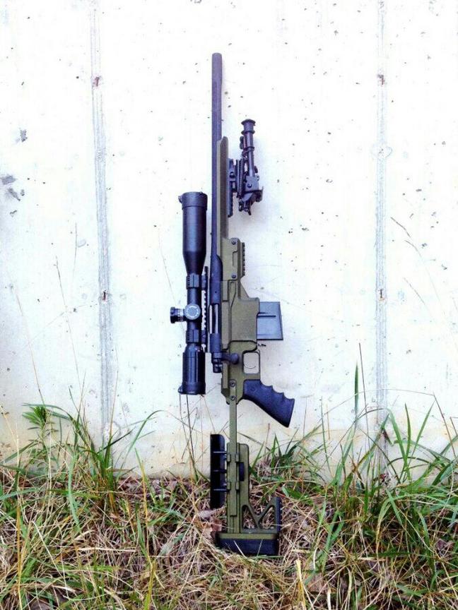

Applied weapons tech. My chassis is on order. Can't wait!
Sent from my SCH-I535 using Tapatalk 4
