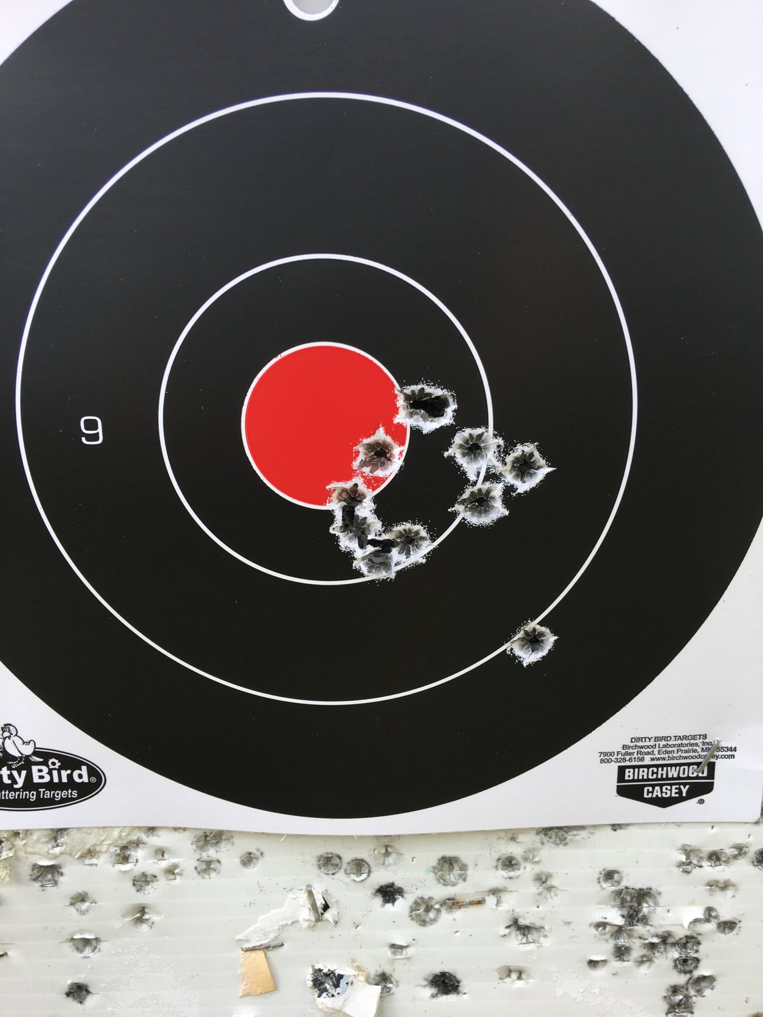

Ok ! Im really trying here .

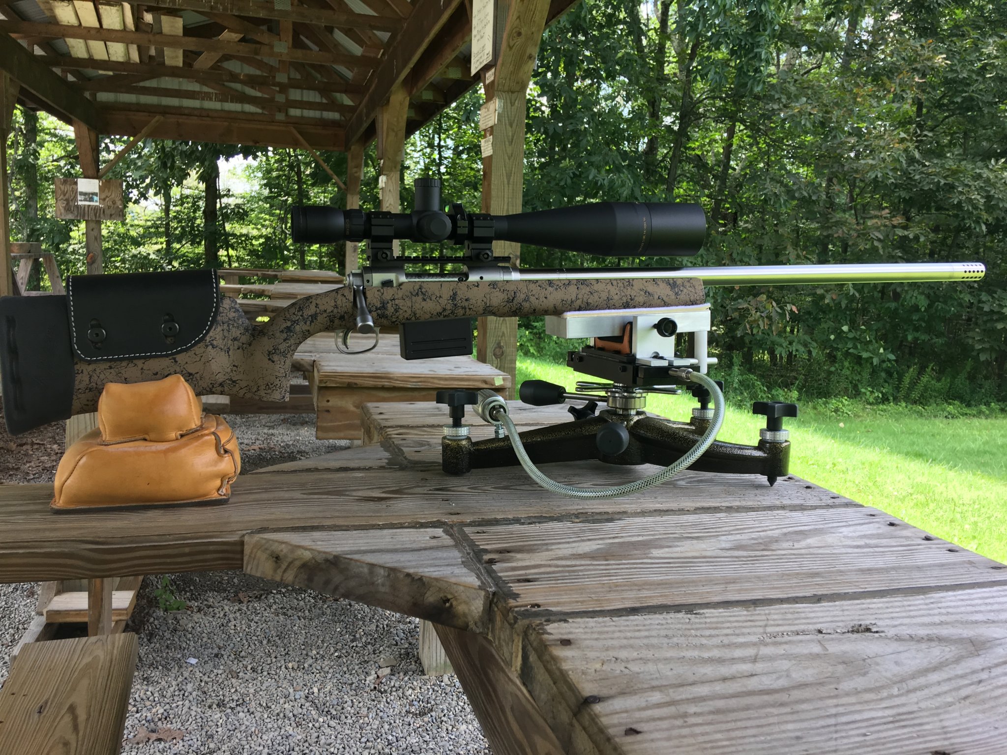

Savage 10 action
Bedded HS stock
28” Criterion bull
Muzzle brake
Bald Eagle front rest , protector rear bag
168 FGMM
300 yards
Very very light hold
Shooting on bench
13 shots
Main group is 1.6”
Add damn flier group goes to 2.6
And any opinions on flier ? It felt just like all the other shots . I’ve seen gross runout on some FGMM rounds and I didn’t check this time . Could a lot of runout cause this ? Im thinking no .

I’ll try to help a little. 13 shots is VERY hard to maintain perfection at 300 yds. There are a boatload of tiny things it “coulda been”. ANYONE here that tries to help is just spitballin’. The gist is: you had a flyer. It happens.
My suggestion, and I’m not trying to be flippant, shoot a smaller # of rounds in your group. People can argue till the end of the inter web about 3 shot, 5 shot, 10 shot groups. My take is this: 3 you can get lucky. I’ve shot ALOT of 3 shot one hole groups. 5 is really testing you and the gun, too many shots for luck. 10 shots is TOO LONG to be that perfect. Many things come to play here. Muscle fatigue, eye strain, barrel heat, anything.
I like to shoot multiple 5 shot groups. Say 5 5 shot groups and come up with an average. There are plenty of guys that’ll say 5 shots don’t give you a large enough statistical average. My response is “ it does for me.” If you shoot 5-6 5 shot groups, you can damn well tell what your gun is capable of. For ME, holding everything perfect for 10 shots at 300 isn’t feasible. 5 shots is. I get less flyers and a much clearer idea of what’s me and what’s gun when I go multiple 5 shot groups.
If I shot multiple 5 shot 1.5” groups at 300, I’d be very happy with that! That sub .5 MOA.
Some may disagree but I have never had much luck shooting a 308win with a light hold or free recoil off of a bipod or front rest with rear bag.
If you are set on running with the front rest and rear bag I would definitely pin it and I bet you will see a change for the better.

I put 12 in an 1.6 at 300 yards and figured the one flier was me . I was thinking that should be consistent enough for F class .
The other day with regular bipod on bench I loaded crap out of rifle and just about put 5 in one hole at 100 yards . Wish I knew if it was me or ammo that’s off . Im thinking me !

Fair enough, with that being said the best course of action I could think of if you aren't allready is buy atleast a case of it and sort it by BTO and concentricity.
And I would definitely try loading the rifle, that is about a 30lb front rest lean into a little bit and see what that does.
