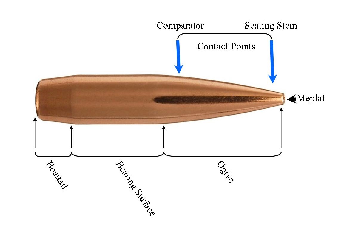

First, it's common to have bullet OAL variances, like anywhere from .004 to .010 depending on the quality of the bullets you're using. Unless you shooting ELR, bullet OAL is not really much of a big deal. But, seating depth consistency is a big deal and that's often measured by the CBTO (Cartridge Base To Ogive). I've found the best way to get consistent seating depth, is to sort my bullets by BTO (Base To Ogive) using a comparator that has the same diameter (or contact point) as the seating stem in the seating die. There are variances between where the typical comparator contacts the ogive and where the seating stem makes contact with the ogive. Sorting this way assures very little variance in seating if your press is capable of seating consistently.

For the OP: it might be worth checking where the seating stem is actually touching the bullet. You can either color the ogive with a sharpie and see if the die leaves some marks on the bullet towards the tip (see the pic above for where). Alternatively, you can disassemble the die, take the seating stem and see how it fits the bullet. If the bullet sits down in the stem evenly, the problem isn't there (probably). If it wobbles and is only touching at the point, not back along the ogive... then you need to either modify or replace the stem with one more appropriate for the bullet being used.
