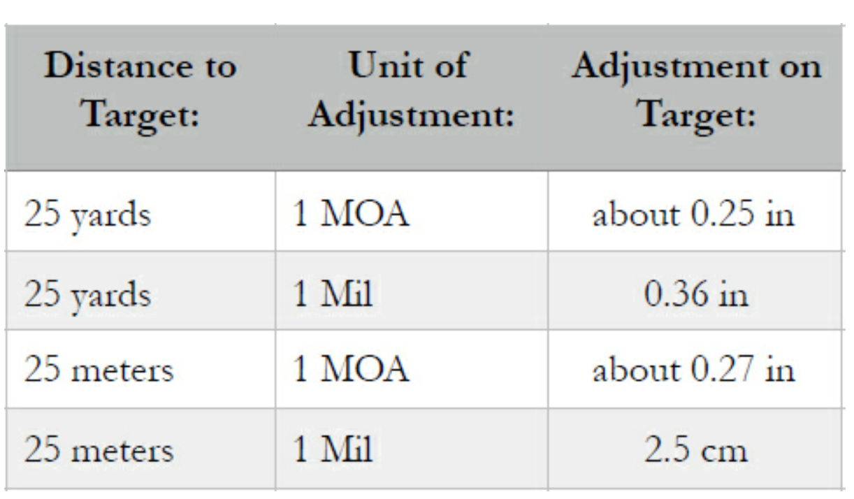

Also wanted to double check this graph from the book. The math on the mils at 25 yards seems wrong, either that or I don't understand what i have read so far as well as i thought I did.
The chart is correct. At 100 yards, 1 MOA is 1.047”. At a quarter of the distance, it’s a quarter of the movement on the target.
Wish I could help you on the book, I’m an engineer and have no interest in going down that rabbit hole when there are plenty of programs and apps to do it for you haha.
ETA: Whoops, only looked at the MOA. My bad. Agreed that 1 Mil at 25 yards is 0.9”.

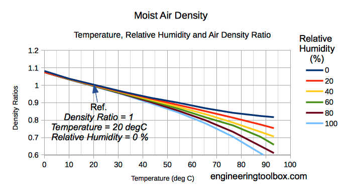

The problem is that pen-and-paper navigation is 7th-grade geometry, so it’s reasonable to expect a person new to the subject to grasp it reasonably quickly. External ballistics is the purview of PhD theses and DoD grants. I don’t know how air density is mathematically related to ballistic drag, but I can tell you that air density changes with temperature according to the following equation:
Density = Pressure / [Gas Constant * Temperature]
This is a derivation of the ideal gas law, that states PV = nRT where P is pressure, V is volume, n is number of moles of gas, R is the universal gas constant, and T is absolute temperature (Kelvin or Rankine, you can’t use Fahrenheit or Celsius). Density is moles per volume (moles and mass are proportional to each other assuming constant chemical composition), so n/V = P/RT. Even more simply, you can manipulate the ideal gas law to show that density at T2 can be calculated from density at T1 by the equation Den2 = Den1 * T1 / T2. So if temp goes up, density goes down.
Relative humidity’s effects are harder to show with an equation, but put simply, water vapor weighs less than dry air. So for every bit of water that is evaporated into dry air at a given pressure, the density of that air at the same pressure will go down, leading to less drag. Sorry, don’t have a great book reference for this either, but Google should get you a better explanation. For now, a graph:
External ballistics is freaking complicated at a mathematical level, but I hope I explained the temp and humidity effects well enough to at least get you a gut feel for which direction they move the ballistics: if either temp or humidity go up, drag goes down (same story for altitude/pressure).
