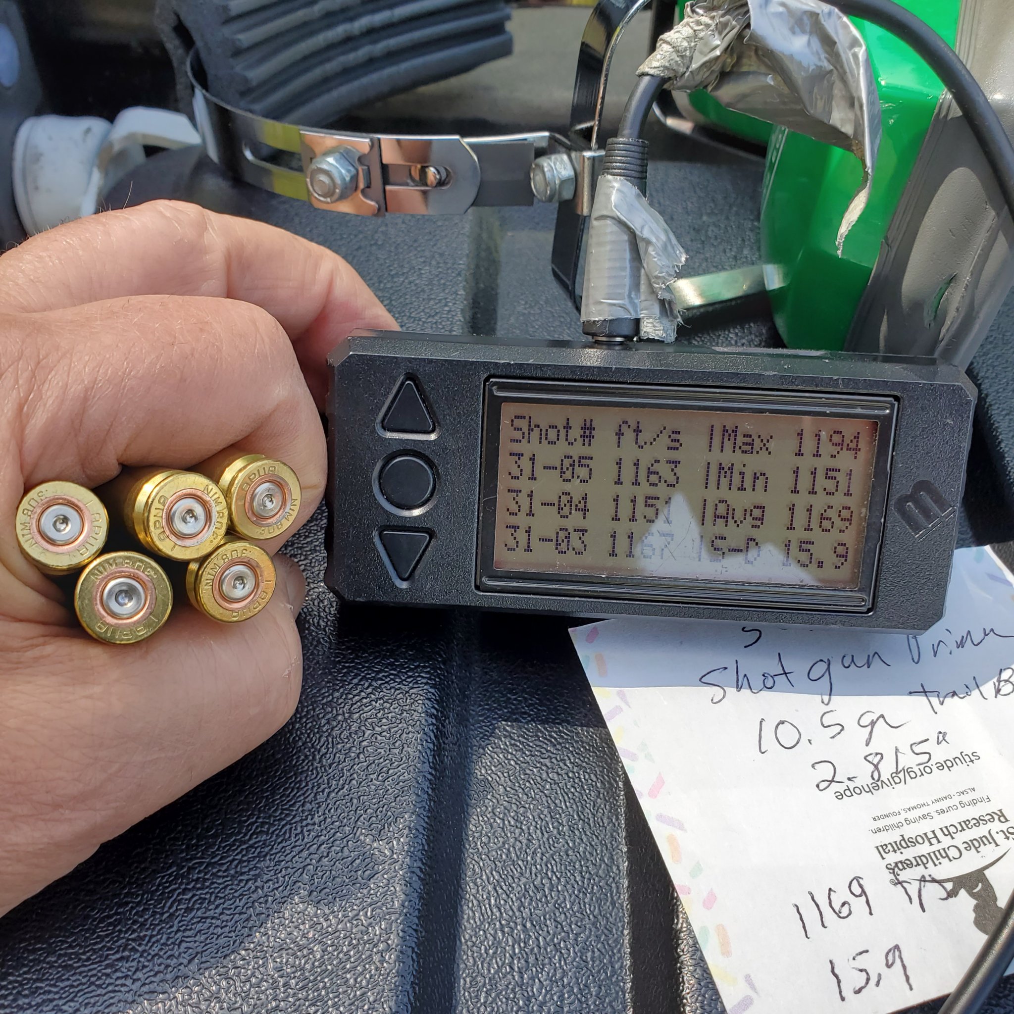

I still have some Trail Boss, so thats what I used with shotgun primers in a 308 case.
Around 11 grains will probably get ya close.

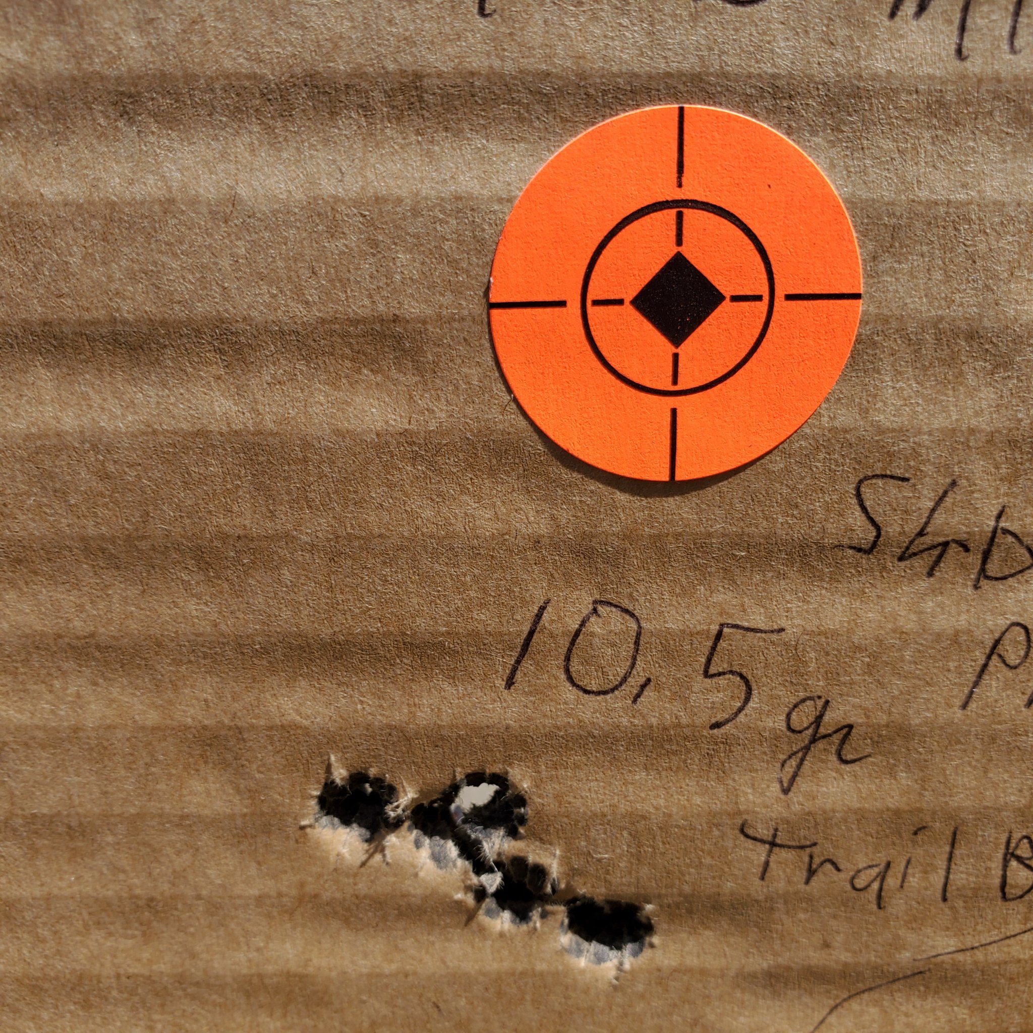

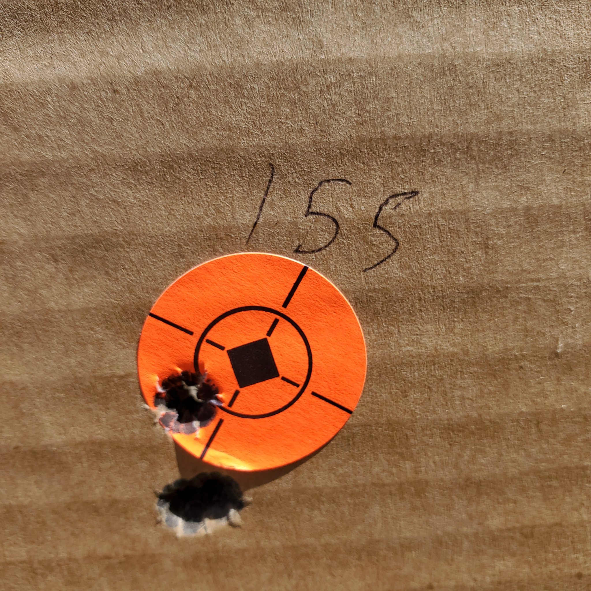

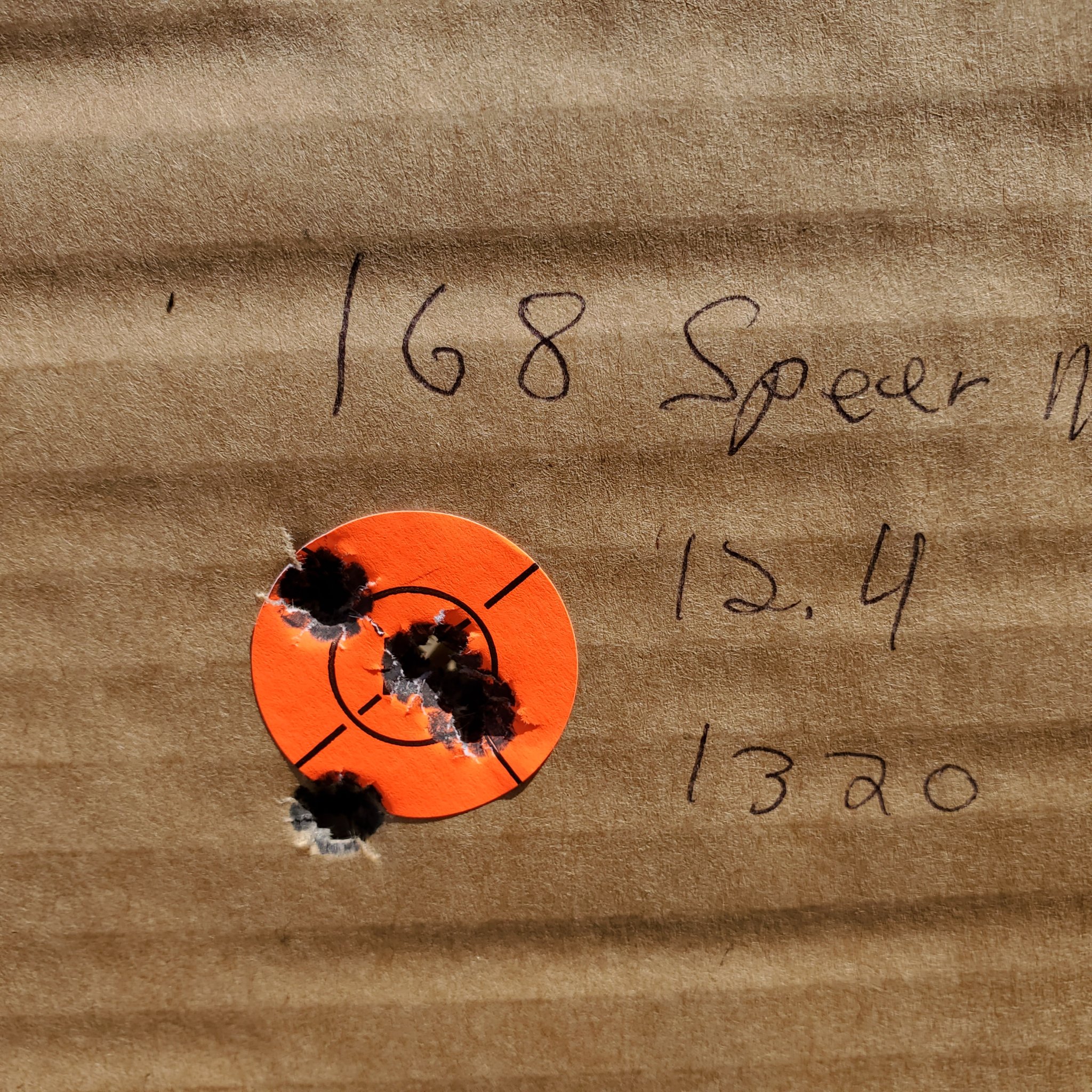

I found it varmint accurate at 50 yds with a variety of bullets except the 200 grs went sideways in the target, in a 12 twist.
But 155 through 175 gr bullets were accurate and fairly consistent velocities, some were a little high in velocity when I started but easy to adjust down.
Fun to shoot...
