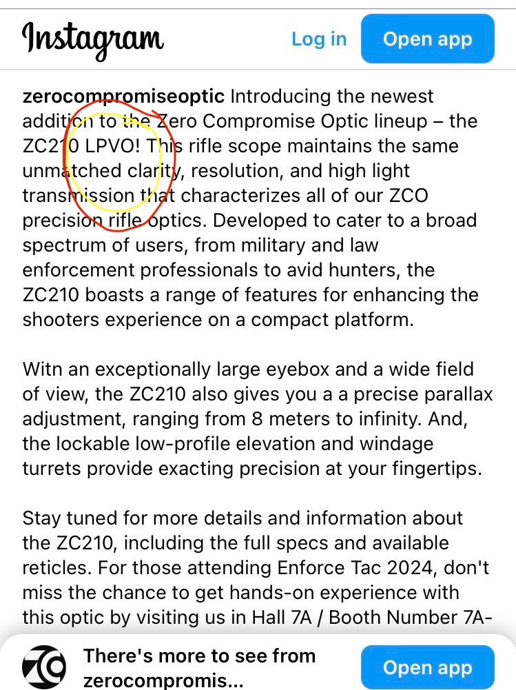

An “LPVO” in a thread about MPVO?
There is no clear set industry definition of LPVO or MPVO. The majority of the shooting community sees LPVO starting at 1x or very close to it. MPVO was coined to meet a particular need that was more than LPVO but not quite mid-range either. ZCO can call their 2-10x30 an LPVO but most will see 2x at the bottom and not categorize this way, it fills the niche of an MPVO moreso than LPVO. I expect the ZCO 2-10x30 to do extremely well optically and we’ll likely see many use cases of 2-10x30 with an offeset RDS which is essentially what many seeking MPVO are looking for. Thankfully ZCO decided to use LPVO style reticles which is what we’ve been asking for in the FFP scopes that fit the MPVO category. A FFP reticle that is useful at the bottom mag of an MPVO may negate the need for offset RDS while still providing good close quarters performance along with excellent distance performance, either way it is the users choice but the idea behind the MPVO is that we don’t have to compromise at the top end of the mag range like so many LPVO’s do.

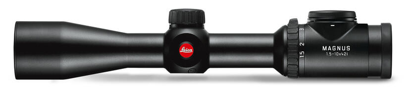

Could put illum flat on eyepiece’s top, sorta like Leica Magnus has, only flatter or curved. They could also use the bottom of the turret “bulge” for a control, like a flat-ish dial for something, like the wind turret. Maybe that’d be a mechanical linkage nightmare.

Learned a new slang term today, debbil lol!
I was talking about the eyepiece tho’, not the ocular bell.
Like above, only way flatter or curved to follow the eyepiece’s shape.
Power systems…interesting.
You know man, after looking at your posts throughout the years, you should do some consulting work. If you haven’t already. I’m serious.
That whole back end of the scope is the bell and ocular piece. That Leica illumination from their LPVOs (that weren’t imported to the US when I saw them in Europe in the late 2000s-early 2010s) is exactly what I’ve been thinking about for an MRDS base. Those LPVOs had probably the clearest FOV and forgiving exit pupil in the optics industry at the time.
iu
But that illumination location is where the MRDS needs to be for reasons.
I have done consulting work, but it isn’t the path forward.
Ahhh, I see. I was mixing up the terms ocular and objective, my bad.
iu
I have one on my driven hunt rifle.
After using a 1-6 Meopta for some years it was mindblowing using the Leica.
As if you are sitting in a cinema, watching wildlife films, I couldn´t believe it.
Unfortunately Leica does only one sporting / tactical scope, the PRS 5-30, with BDC reticles, all others are hunting reticles (similiar to the German #4).
