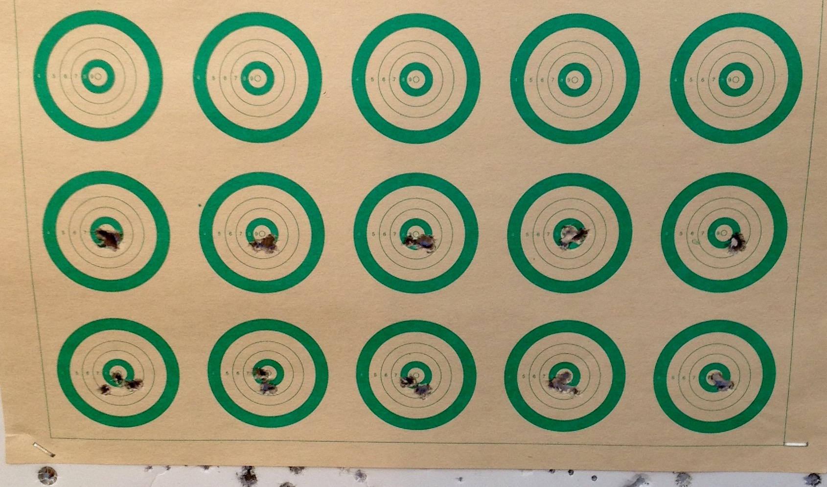

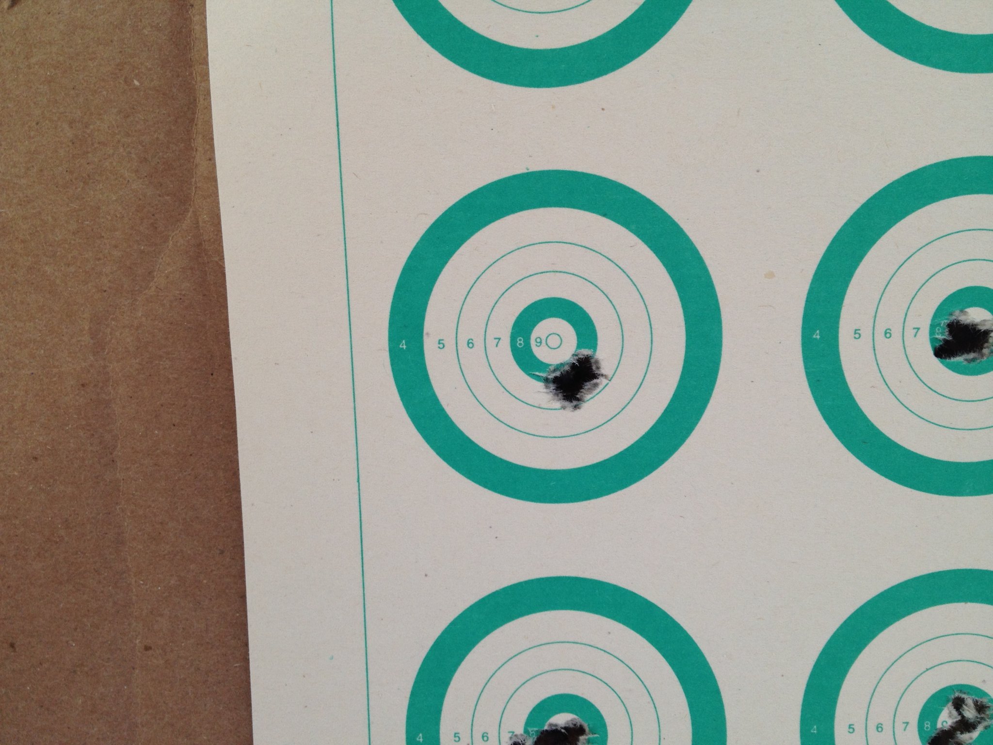

JJ1 - this is a lot to process and you are getting some great advice. 22lr accuracy is not magic. There is a process of minimizing all of the variables that are within your control. The speed and consistency of the ammo in one. For example: All Lapua ammo has a speed code. It is the first two numbers of the lot number. 22, 23, 24,...28, 29, 30 etc. If your lot number is 24 that means that the tested speed of that lot is 324 meters/s. I use Lapua ammo almost exclusively. Why? Because it works best in most of my rifles. Eley is also good. Nothing else compares. There are three main grades of Lapua excluding the biathlon ammo for cold weather. They range from good to best with Center X, Midas+, and X-Act. You can find good lots of each. If you test lots, you will find that for a specific rifle about 3 or 4 out of 10 fo CX will shoot well, 4-6 for Midas and 6-8 of X-Act. When I lot test a rifle, I will start with a slow lot, like 22 speed and then move progressively faster until I find one that groups best.
Now, cleaning is critical. Get a good rod and rod guide and remember that CZ factory bbls have bores slightly smaller in diam than most 22's and many 22 sized rods will scrape the inside of the bbl. Use a .20 or .17 or 4mm rod with a 22 cal jag and small patches or 20cal jag with larger patches. You can test Lapua & SK lots back to back without cleaning because they are all made with the same bullets and lube but if you go to RWS or Eley, you must clean the bbl first or spend many rounds reseasoning the bbl. This is a variable you can control. A properly cleaned bbl will settle in after about 5-15 rds. When I shoot matches I clean after each card and then fire 10rds min to season the bbl before shooting for score.
Wind. You do not control it but it can be managed. Test only in calm conditions at first. Get flags. 3-4 of them. A simple 3 ft steel rod driven in the ground with an empty cartridge on top that fits loosely will work. Epoxy a small wire hook or fishing swivel onto the top of the cartridge and to that hook a 18" piece of plastic engineers tape. Drive these into the ground starting about 10-15y from your bench and in 10y increments. They are sensitive enough to show you direction and relative velocity. You will learn how much wind is too much. I tested a new rifle this week and was getting random flyers until I noticed that the wind had picked up but was on and then off again.
Test at 50y or 50m until you find your best lot. Why? Several reasons. Wind has more effect at longer ranges so, it helps to minimize its affect. Test indoors if you can get to a 50y indoor range. If it is smaller you just get one hole groups from everything. Be sure to hold the rifle the same way all time but don't grip it too tight unless you find that the rifle shoots better that way. The strong hand thumb should be lightly gripping the rifle or better yet pointed up. Recoil is no an issue with a 22 so no need to hold them too tight.
Use a solid bench and sandbags or bipod. No folding bench or improvised rest can beat a good concrete bench except.... Prone. If you shoot prone from bipod or bags, that is solid. You said you had a Yo-Dave trigger spring. That is good that you have it adjusted so it is not too hard. I do not use super light triggers but they still need to be crisp with no slack on the front and little to no over travel. Focus on making each shot count and don't hurry. If you get tired or are hurting, stop and take a break. Keep a positive mental attitude and enjoy the process which can sometimes be frustrating but it is part of the challenge. Precision rimfire is a blast. Once you have it singing at 50y, reach out to 100m or longer. The attached pics were all shot with Lapua CX at 50y from a bench.
