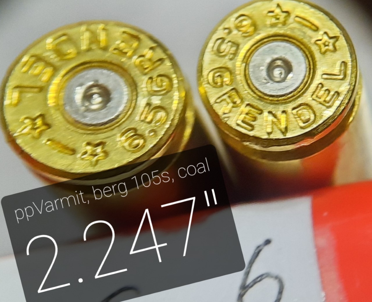

Having said that, here is some of my most recent results - all with reformed Starline brass, CCI 400 primers, berger 105s HTs seated to 2.230" out of 20" CMMG barrel:
  • Shot 8 round groups of ppVarmit - meh group of ~1MOA - I'm still getting used to rifle, could have been a tad better shooting on my part
  • Leverloution Ladder loads - pairs loaded in .5 increments from 25.0 - 28.5 grains - saw slight swipes at 28.5 so stopped there. No chrono data (I forgot my Tripod head and left it on the camera at home)
  • I have the SA adj gas block and just left it at same setting that was used for the 224 wyle build. I may start tweaking it a bit more as described above (used that same process when I set it up for the 224 wylde). If I end up closing the gas block a bit more, would that not equate to a bit more velocity or no?
  • I just added a nice seekins precision 30 cal muzzle brake and wow what a difference! Before I was just running it bare threads and was not impressed with how soft it shot. I was having trouble spotting shots at 5/600 even 7x power. Now it just sits there ready for the next in line.
  • I also added a bipod that attaches to the sides of the handguard and that also helped quite a bit. These 2 upgrades really did seem to help more than I had expected.
  • I'm getting some weird cratering on the primers even at moderate loads. It may be something on the bolt face or primer pin protrusion. I took a loupe and looked and it seems that the very center of the crater has a tiny nipple at the very center/bottom - almost like its about to be pierced. I DID have 1 peirced primer when I tried first Hornady ladder loads. The primers look the same as the other rounds in that group that did not pierce.
  • comparing my brass to the hornady range scrap I used, the H brass is has noticeable ejector marks and much flatter primers compared to the same loads in Starline Brass - BUT, I don't remember if the H brass had any ejector marks previously. Still, the primers alone tell me the Starline is better in that respect.
  • I'm glad to hear that neck turning is a waste of time in gas guns. I was wondering if converting the grendle brass to ARC would make the necks a tad thicker and having no way to turn down, is this increasing neck tension to an amount that would increase pressure sign or not.
  • My loading plan going forward is to make some more ppVarmit rounds, try to take them to 750 or mayyyybe more. I will also load some LeverLoution in .3 grain increments around my max ladder load and try them out too. I will take the chrono this time for sure!

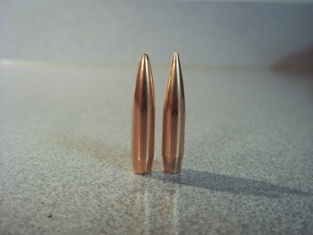

I don't use the Match Kings but do use the Nosler 105 gr RDF's. Similar bullet and I pretty much use them exclusivly, they shoot way better than the Hornady 105's and their 108 offerings. I get the Noslers when they are on sale for about .26 each, and have paid as little as .20 each. They are very accurate and shoot very well at distance out to 800 yards, that's as far as I have shot them to date. Just had another 500 dropped off today.
Hornady on left Nosler on the right

Your primer issues are because you're using CCI400. Step up to the CCI450 (good luck finding them now though) and those issues will most likely go away.
Your Leverevolution load was not at max. Your swipes are from the rifle being overgassed; no reason to expect a gas block setting from a different rifle to be correct. Lever produces a lot of gas and if a rifle is tuned right for the common appropriate stick powders, a full charge of Lever will usually make it overgassed. Get that gas system tuned right so the swipes go away, and you can push the velocity a bit higher with Lever than anything else.
Starline and Lapua brass are both significantly better than Hornady.
Neck turning is definitely not a waste of time in ARs, especially if you're necking down brass.
