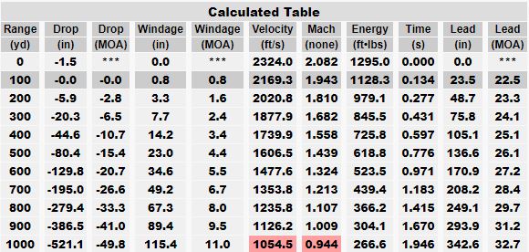

6mm Grendel-based cartridges and 6.5 Grendel easily reach past 600yds with high hit probability out to 700-1200yds, depending on the conditions, bullet used, etc.
The 107-108gr class of 6mm bullets will stay supersonic at standard atmospheric conditions even from a 16" barrel past 1000yds, with really flat trajectory and minimal wind drift.

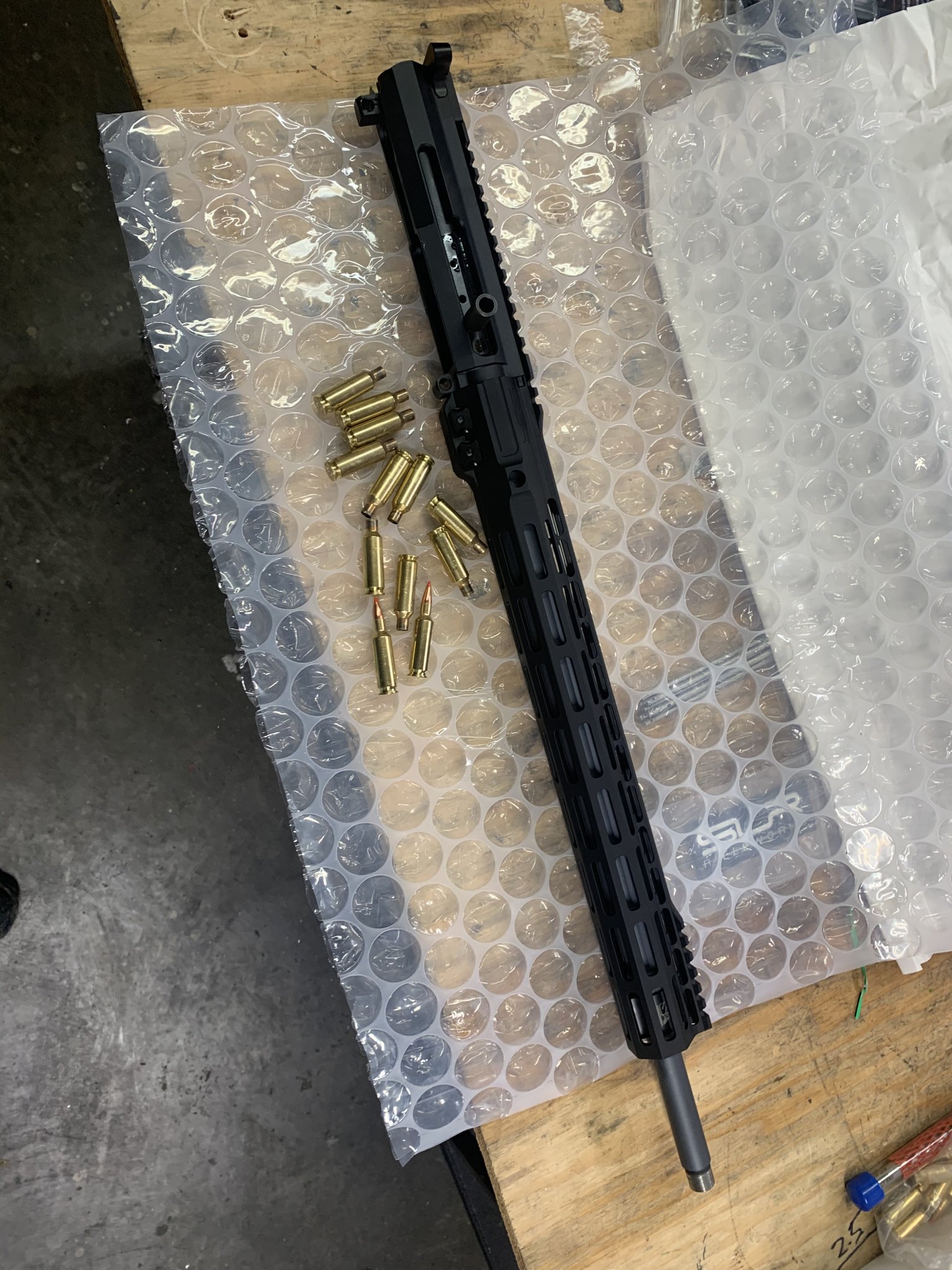

To clarify - I was specifically referring to an AR-15. I'm well aware that the BR and GT sized cases will work in an AR-10.
These are on the AR-15 platform . The upper is a 6GT and the rifle is a 22BR
I have been wondering about a gt in an AR for the last two months. Nice!

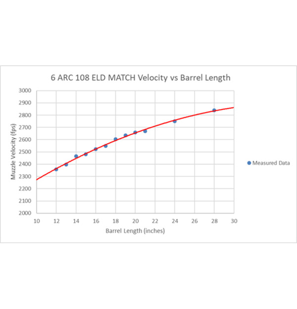

Okay got some more info, use at your own risk this is preliminary data. 103-110gr. These are Max loads, Drop 2gr or so to start.
8208xbr: 25.3gr
H4895: 25.5gr
LeverEvolution: 29.7gr (Best velocity)
AA2520: 28gr
RL-15: 27.8gr

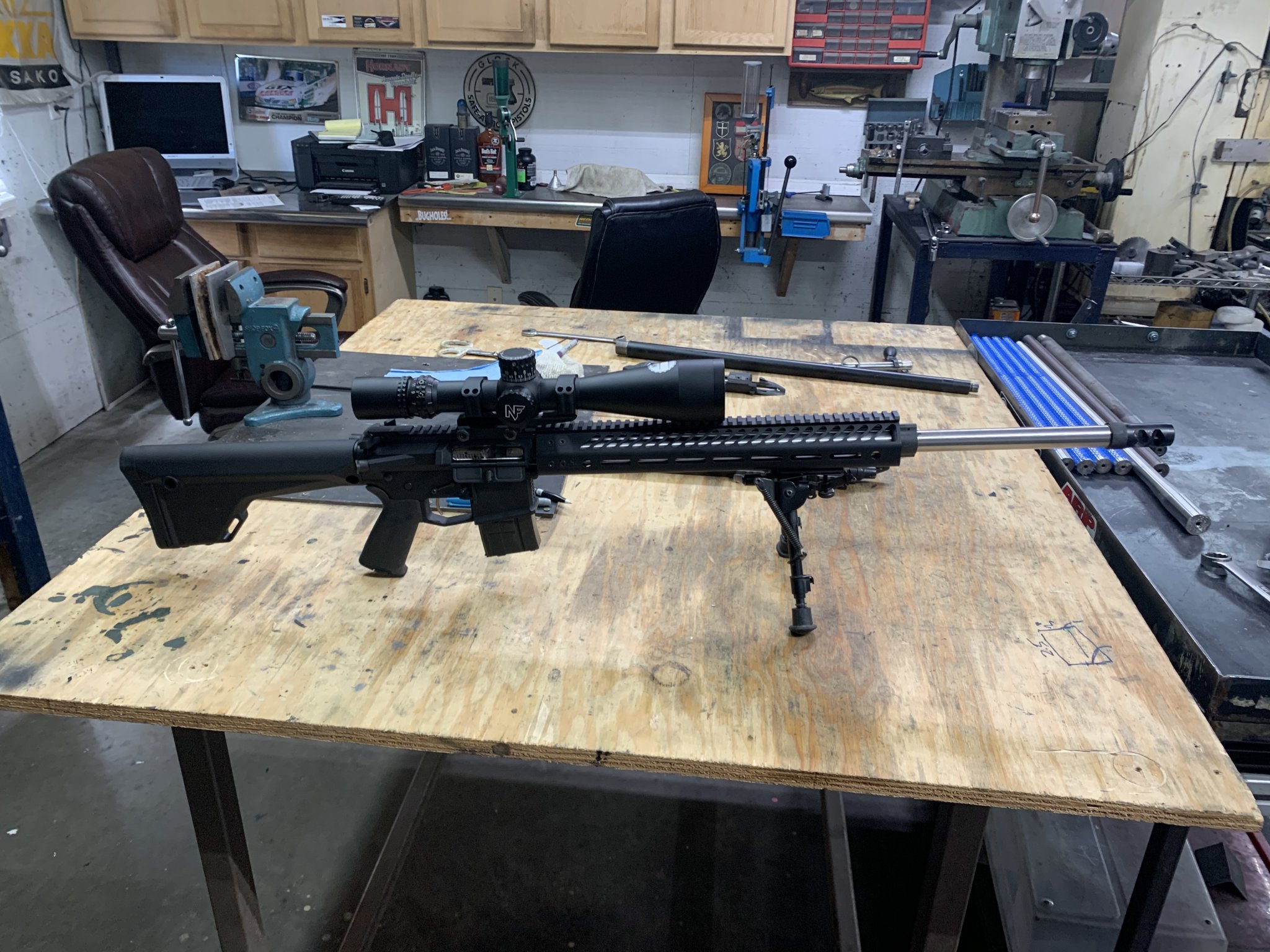

And looking at the photos (plus knowing OAL limitations), I'd say you're running much lighter/shorter projectiles in them just to fit inside the mag length - something the ARC doesn't have an issue with. That's not even getting into bolt face issues.
Its interesting to see them crammed into an AR-15 pattern, but I'd say it looks like you're making some serious sacrifices to do it.

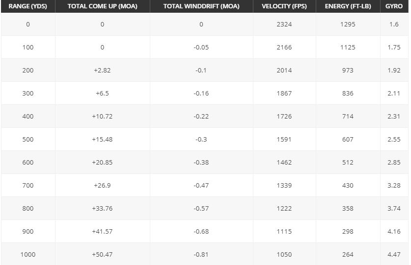

This is using the actual MV’s recorded at the range using 108 ELD-M in the barrel lengths listed. Then put into 4DOF. It’s using whatever Bc is in there. (Which hasn’t let me down using 6Creedmoor)
hasnt been trued yet using Axial Form Factor though. That may change the charts slightly.

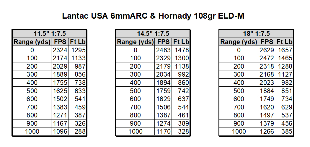

4DoF isn't a BC calculator and doesn't use BCs. There's a table of Cd vs. Mach and another table that describes the mass moments of inertia, CG, etc... for each bullet, among other things. My phone app 4Dof lines directly up with the screen shot of the web-based 4DoF I posted above (59 degrees, 29.93inHg, 0ft)
What's the elevation, baro, and temp you're using? I have to set my 4DoF to something like 1500ft on a 70 degree day and I'm in the ballpark of what was posted above. Most people are looking at sea level/STP for comparison sake.
Personally the only reason I brought it up was because I've always had pretty similar results in the charts whether it be AB or 4DOF, first time I've seen one vary by that much, usually they're both within 15fps or so. Always learning
