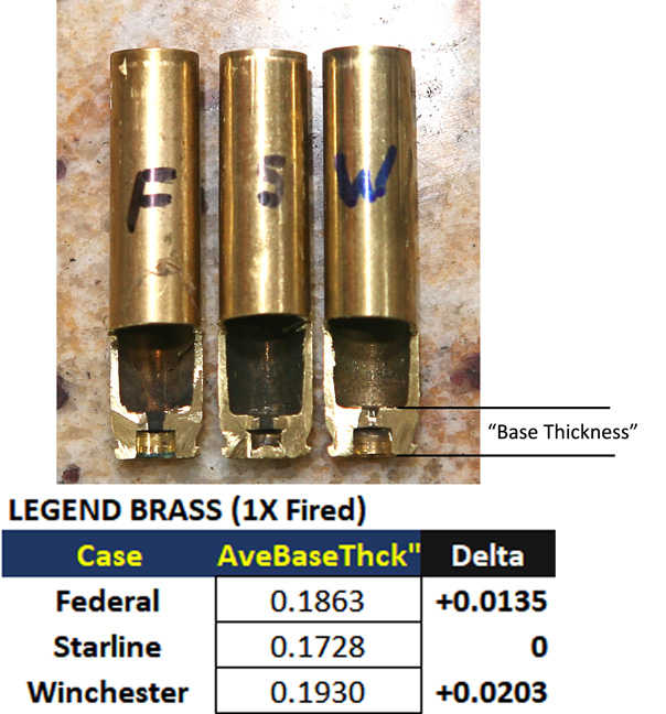

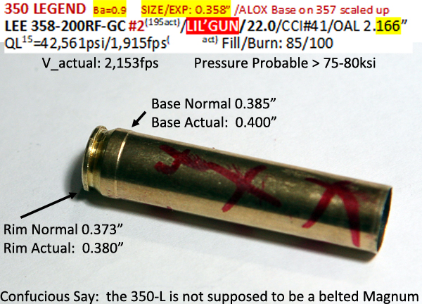

357 size bullets will work but not with Winchester brass. They work with starline which is way better than the Winchester garbage anyway. The Winchester brass is too thick and won’t chamber with bullets bigger than .356” in a saami chamber but starline will with .357” bullets.
And there is where you are wrong. Starline brass is made wrong. One it is thinner, thats why you can fit the larger bullet in SOME chambers. The web is made too low and you can turn the brass into a belted case in a AR that uses a coned breach face. Win brass is made exactly the way it is supposed to be.
I have been loading for the legend since day one of its release. I have them in an AR and in a Ruger American Ranch bolt action. I have shot everything from a 85gr to 290gr in one. I know what it can and can not do. While I have never destroyed any brass like below, I know several that have when this first came out as there was no data to use. I used 357 max data at first. And it was safe as could be.
I have a few 350s and even had a bolt gun built before you could buy a factory rifle. I have never had an issue in any of my ARs or bolt guns with starline brass and 357 sized bullets. The “belted magnum” is from either loading too hot, too much crimp or trimming the cases too short. With high pressure rounds that headspace on the case mouth it is very important to keep the case length as close to chamber dimensions as possible. Now back to the original discussion, the 400 legend looks like it will be a great round and I will get a barrel made as soon as Reamers are available. Hopefully mos-tek with be making ar barrels. This looks like it will be a nice short range bear cartridge with low recoil.
