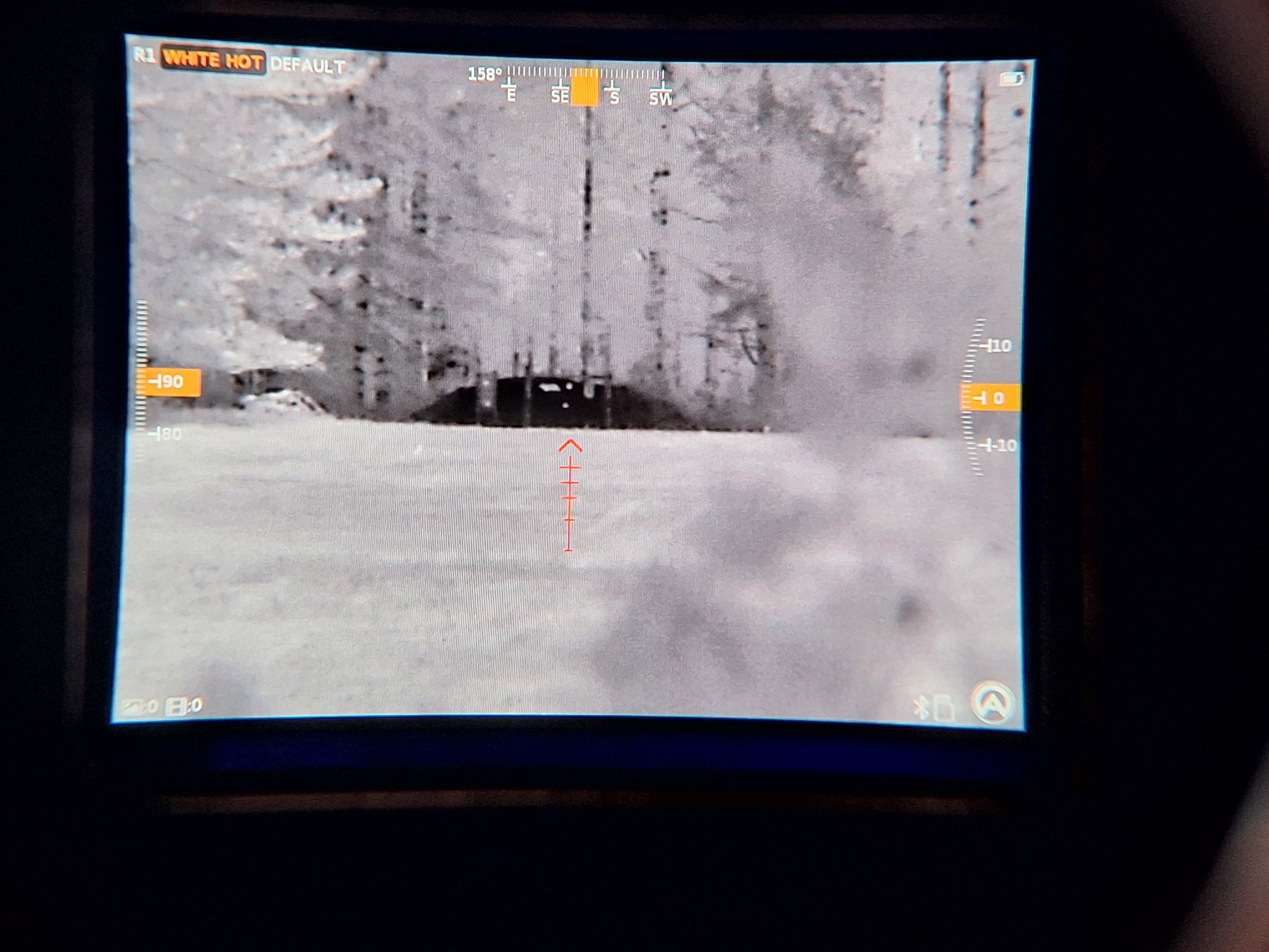

I just purchased a Contractor 320 6-24x so I can report on it once it arrives. I'm hoping the 6x base mag that gives it 72 pix/deg provides good clarity.
Reactions: Kino and Jip4012
Picture is of a Contractor 320 6-24x at base mag 6x power
330 yards to targets, backstop is sand hill in the shade, very moist from rain night before
Field is 6" grass in sun
Life size steel coyote target on left, warmed in sun to slightly warm to touch 30 minutes before photo was taken
6" square steel middle top, 5" steel circle middle bottom, both also warmed
Silhouette target on right, never warmed
Wood frame on far left with paper targets and two mitten hand warmers from 1+ hour before Pic was taken
Daytime, some humidity, 80 degrees F
Pic taken with phone camera zoomed 2x (causing a very slight amount of granulation/ drop in image quality)
Pine tree at 25 yards in front of scope causing interference on right side of pic
Scope is holding zero after 50 rounds of .223 40 gr vmax and a power cycle
Scope shoots 6-12" high when using digital 12x and 24x zoom
So your saying your getting 6"-12" of shift if you zoom??
If so thats terrible and I'd be having it shipped back to Armasight for repair, quality thermals have zero shift if you are at any zoom level.

Yes exactly. I've already contacted them. If I had to guess, it's not zooming in on the point where I moved the reticle to during zeroing, i think it was zooming on the original point of impact before zeroing. When zooming back to 6x it retained zero and the chevron reticle appeared to be tracking bullet drop correctly on 55gr ammo.
Hopefully it's a minor issue that can be fixed because otherwise I like it alot and it's easy to use. I don't really even need the digital zoom with a 6x base mag but it's nice to have.

Created a thread. I talked to them on the phone today and the RMA process seems easy and they said they'll fix it in 6 business days. Most likely a software issue.
