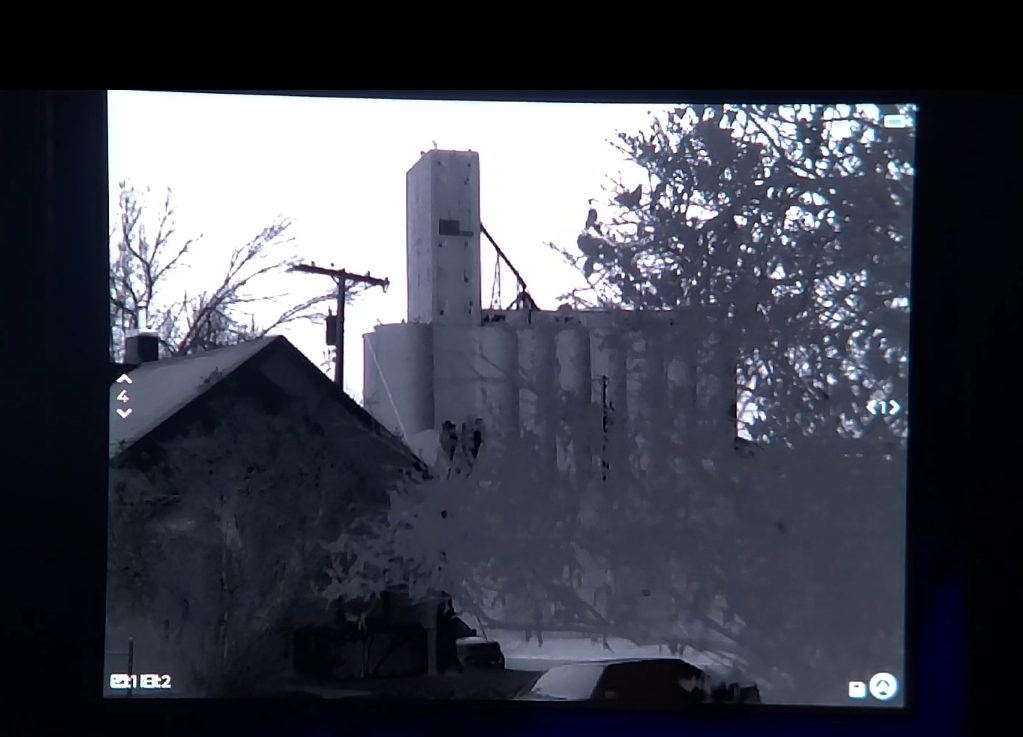

Here's one that I took through the unit I received today. The image looks a tiny bit better than this photo, but I suspect most people aren't really adjusting their settings for the best image.

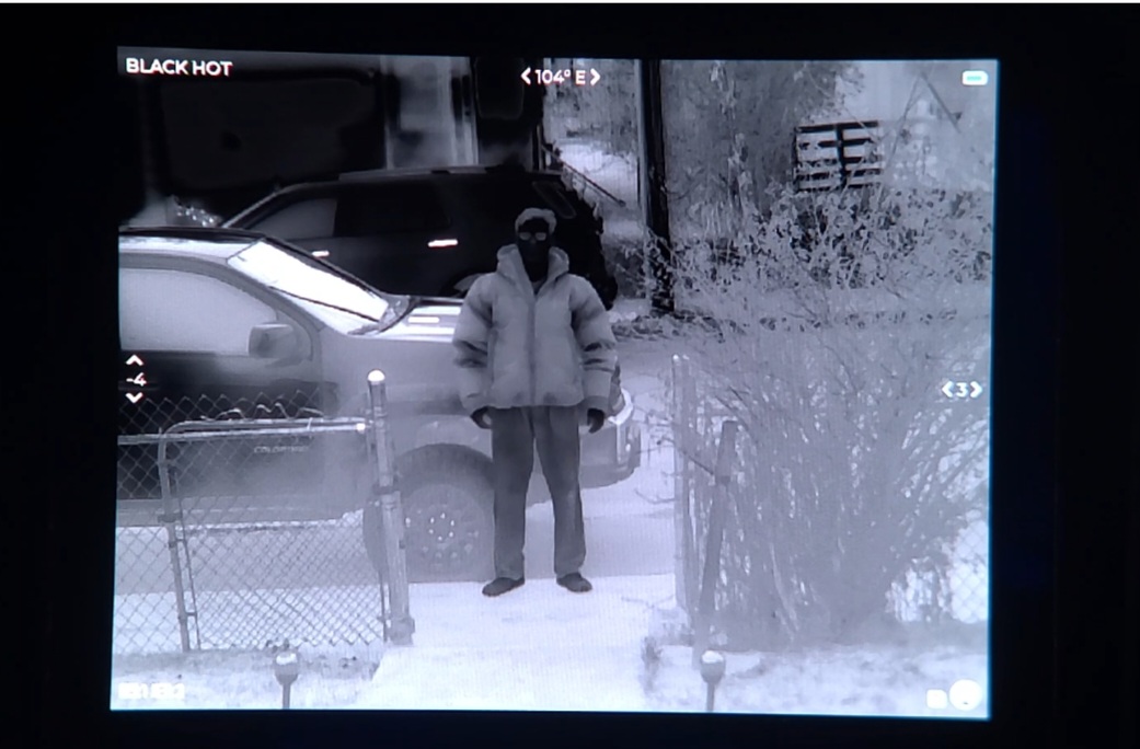

Update: the unit is sensitive to humidity. Once the clouds cleared up a bit, the image GREATLY improved and was realistic/depth perceiving. Humidity was still 81% without any sun that day and winter mix (snow, rain, and cloud cover).
The base settings arent adequate to get a good and contrasty image, but I was able to modify them to get a great picture (I'll post the settings up when I make it home).
Best color pallets are Sepia and Target mode in my experience. Black hot takes away a lot of contrast for reference, but target mode is the black hot base with a red overlay; it works really well. The red overlay isn't too imposing, and is quite sensitive. As a litmus test, I looked at a light 300 yards away to see if I got a hit (that fixture is always hot) and right away it detected it. It's about 1/4th the size of a yote....so that shows promise.

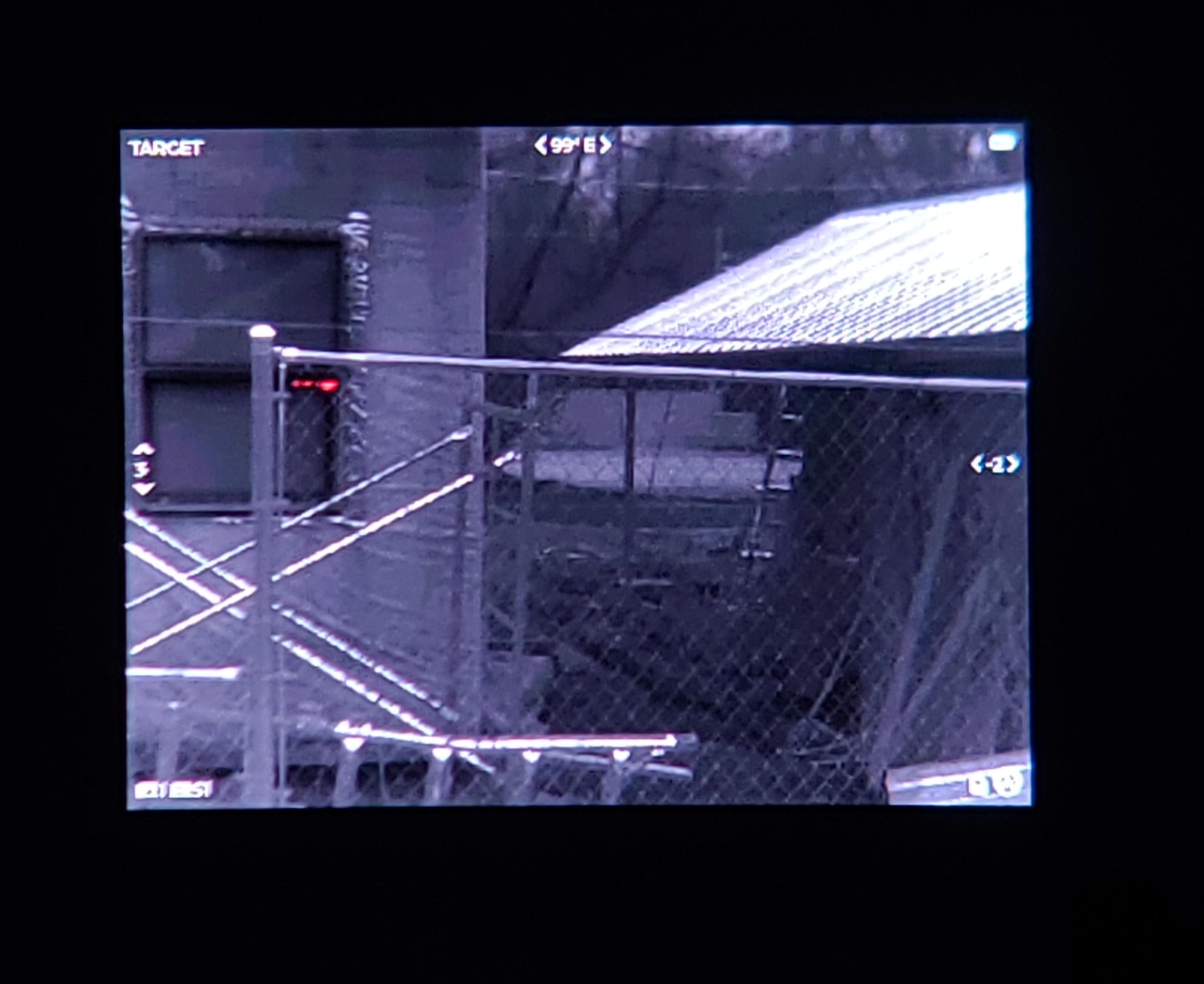

Again, here's a pic with my modified settings in Target mode.

Here's some good photos through the unit itself. Working on a small teaser video before the full review is complete that I think many here will be very pleased to see 😃. Let's just say that the video out does not match what you actually see, and settings matter a lot with this unit.
What you are describing about how this unit is performing sounds similar to how my Flir Thermosight units with Boson cores perform. In high humidity the natural terrain picture might suffer some, but they always perform well on the "live critter". Kinda like the processing power is prioritized to finding the live critter and not so much on the terrain. They have excellent adjustment ability and you just adjust them to the emissivity conditions.
If I were a betting man, I got a hunch that Flir FPA/Core etc is in these new Armasights. Will be interesting to find out for sure hopefully exactly what is in them.
That's exactly how my Contractor 320 scopes are performing. Even if its humid and you can't see the terrain details as well, the animals look almost the same.
Reactions: WhereNow&How
Wow, this nothing like what I'm getting with my unit. Settings seem to matter indeed. Please help me Obiwan!!!!

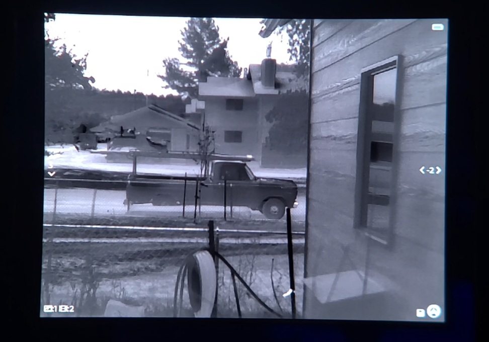

Thats a looking Shweeet. :)
