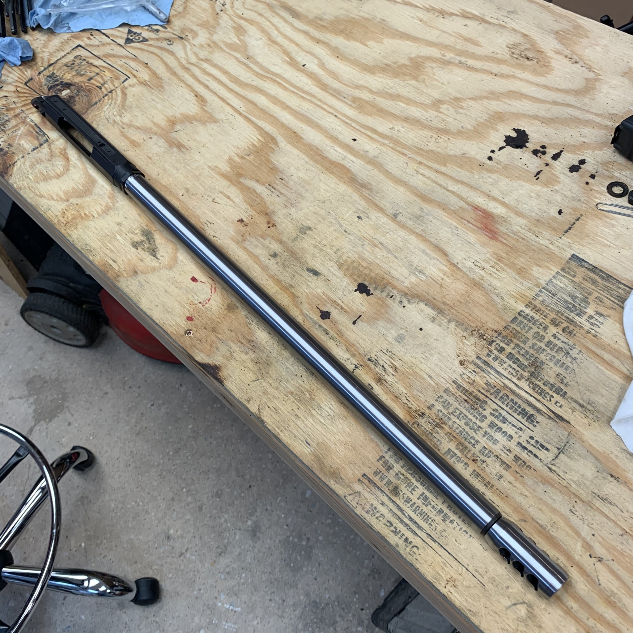

    My little Tikka T3 Lite has the OEM .223 barrel with a 1-10" twist that I threaded the barrel 1/2-28 and put into a KRG Bravo stock.
    Obviously, this limits the barrel in stabilizing heavy projectiles, how fast the barrel heats up and stiffness of the barrel when using a suppressor (POI Shift).
    Shooting 5.56 spec ammo in this barrel leaves brass with faint ejector marks, so I'm "twisting the dragon's tail" shooting the higher pressure stuff in this chamber
    With a new Barrel in 5R rifling in 1-7" twist with a larger diameter, it pretty much checks all of the boxes for my issues with the OEM tube on the barreled action
    I'm going to keep the .223 Breech face bolt ( 0.378" dia ) with this action. I just bought 300 pieces of Lapua brass for this rifle, so .224 Valkyrie is not a viable option.
    I have other .223 Rem rifles so the reloading dies I purchased 2 months ago will not go to waste.
    I saw a 20 % discount code for X-Caliber barrels ( ACCURATE20 ) a couple of days ago and checked it this AM to verify that it's valid. - I have the barrel in my online shopping cart as I type this.
    Here are my Questions / Concerns:
    Should I have it chambered .223 Wylde or "Go Big or Go Home" and have X-Caliber ream it as a .223 Ackley Improved ?
    Is 20" enough barrel length or should do a 22" or 24" tube ? - Keep in mind that the suppressor is 8.5" long
    ETA: - I'm thinking Heavy Palma contour for the barrel to not be too obnoxious to deal with - It'll be a range trainer and predator / varmint rifle, but it'll be for short walks and not high altitude mountain hunting
    Waddaya think ?

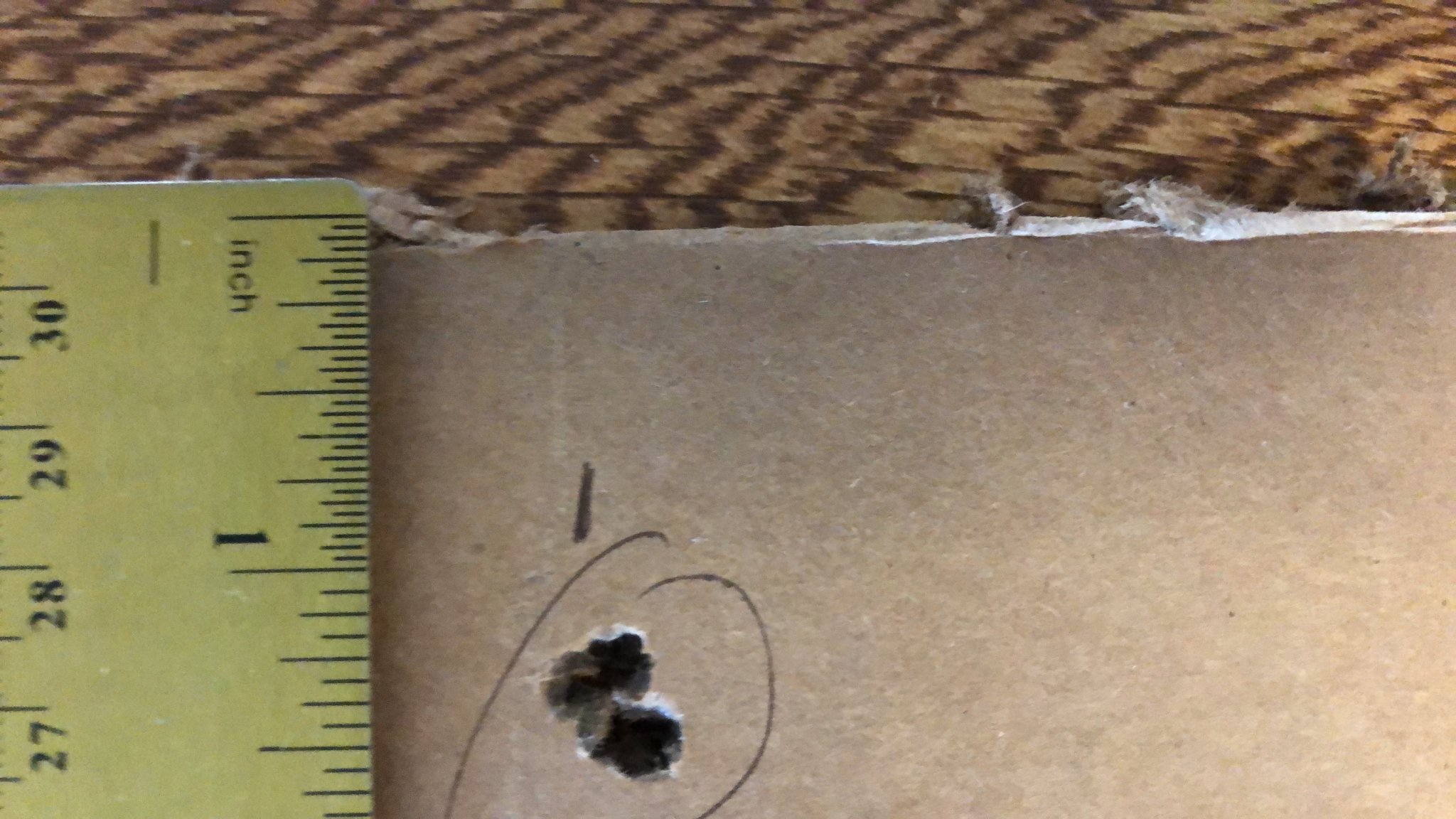

    My son hit 1400 with the factory Tikka barrel and the above 75gr ELDM.
    I ran out of room in my 223AI with H-4895 and 75gr eldm, as the powder is at the shoulder, and am at 3003 fps in a 7 twist 28". I could compress the load and get more fps but I think going IMR 8208 using a max load I could get 3100 fps!

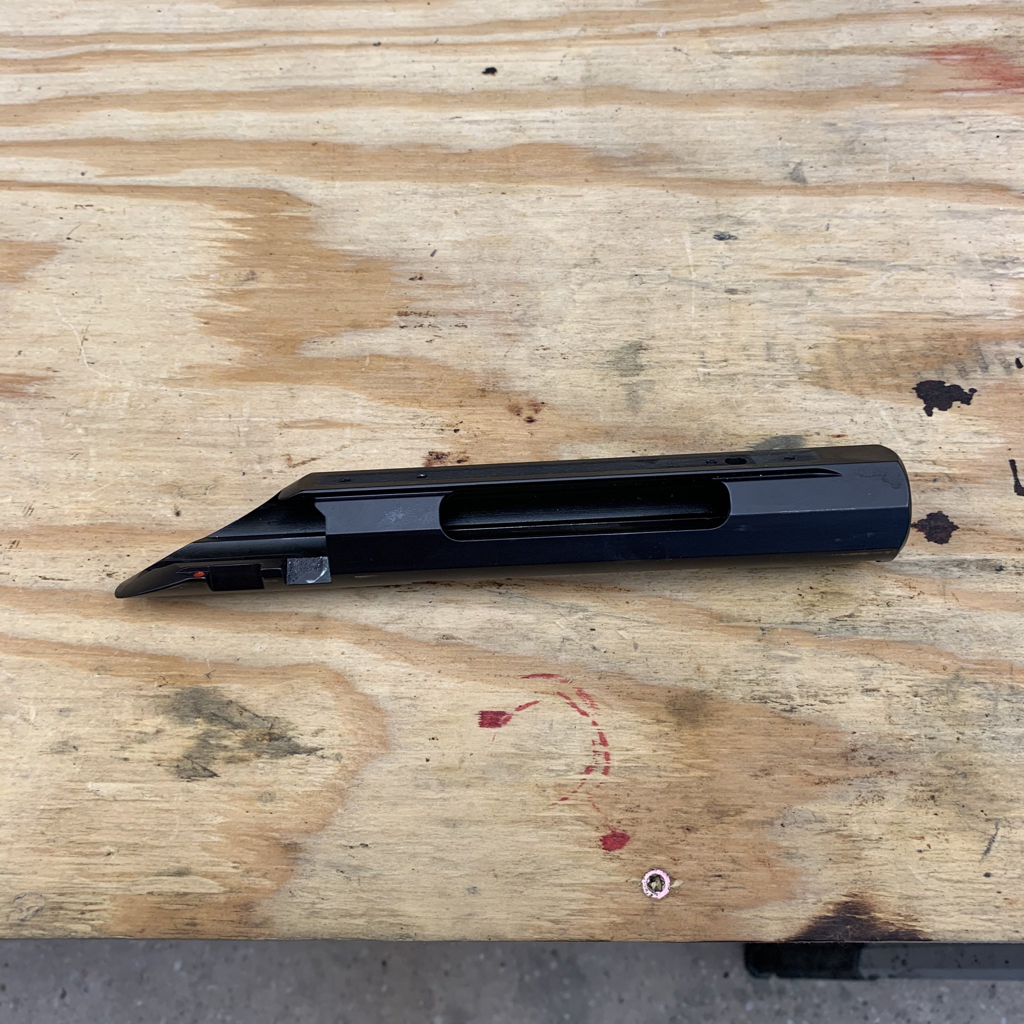

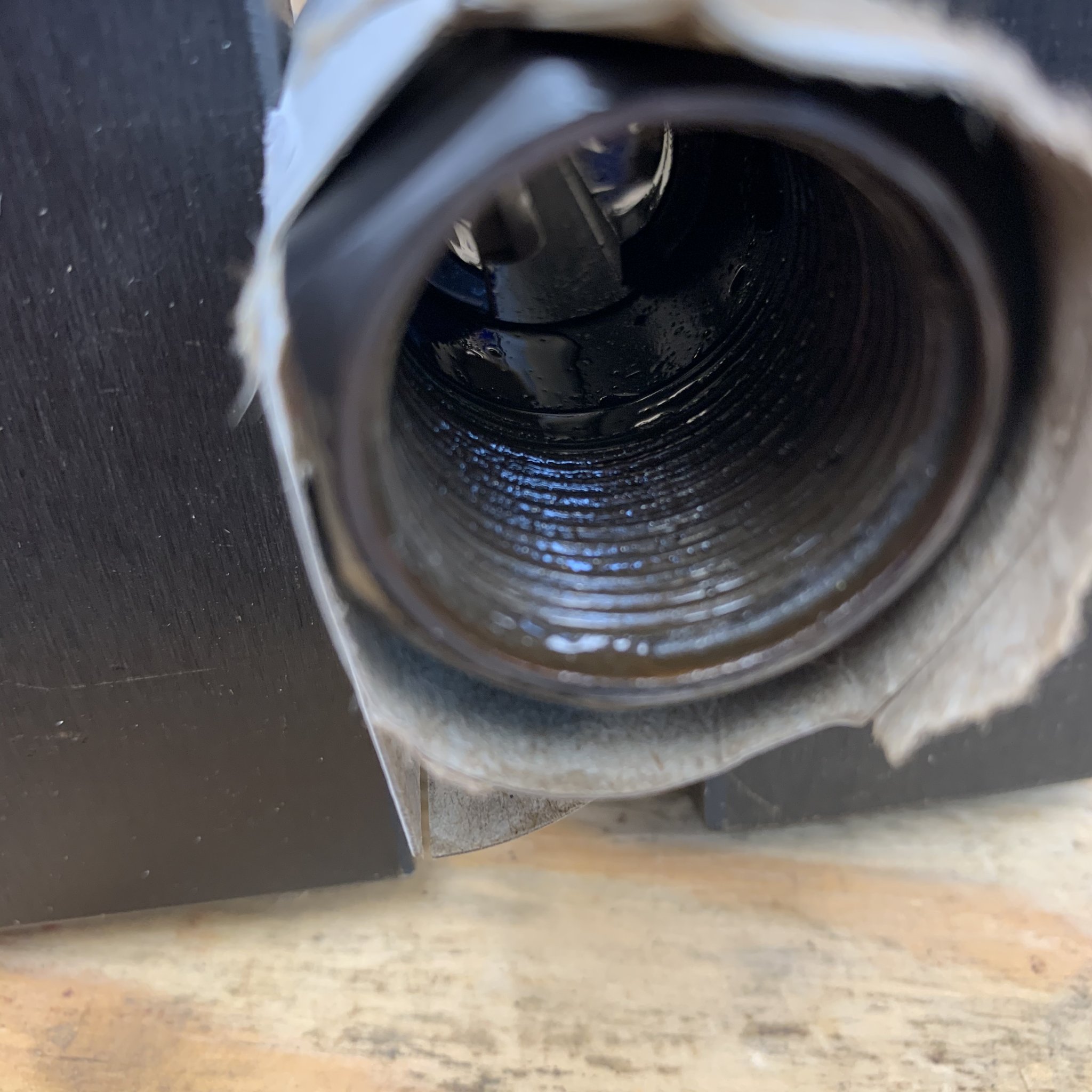

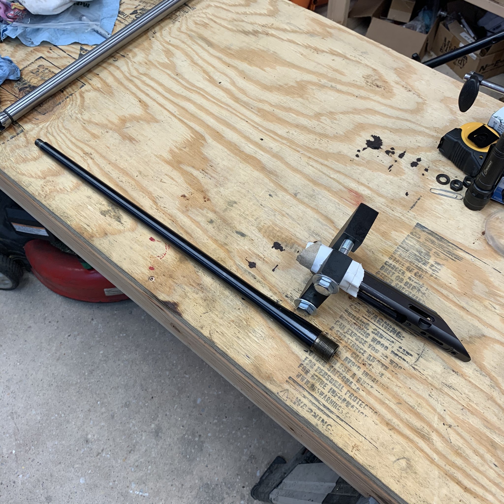

    I received the barrel, cleaned the bore and then scoped it. The bore looks good, the chamber reaming looks good and even in both the groves and on the lands.
    Separating the OEM barrel from the action was a test of perseverance, heat, leverage and finally a hammer blow.
    This must have been one of the actions / barrels that were mated by the Finnish version of King Kong.

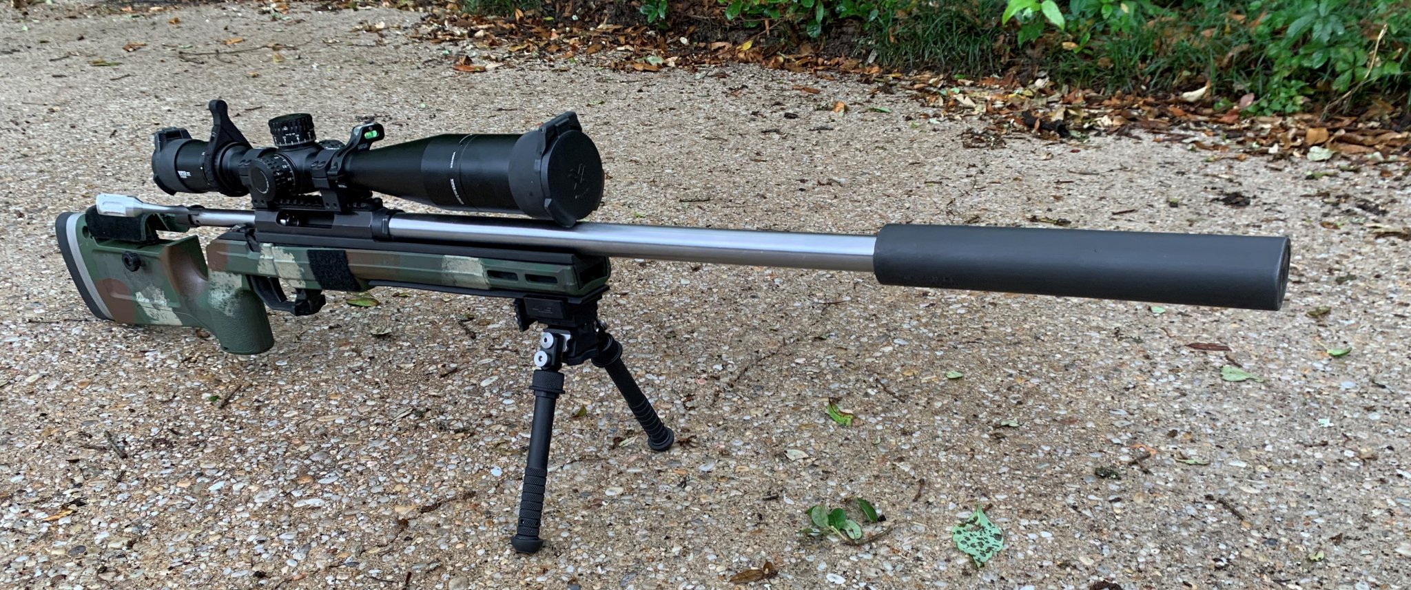

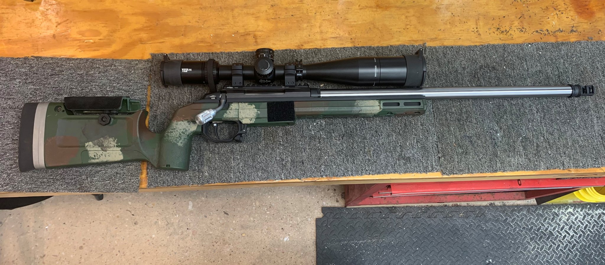

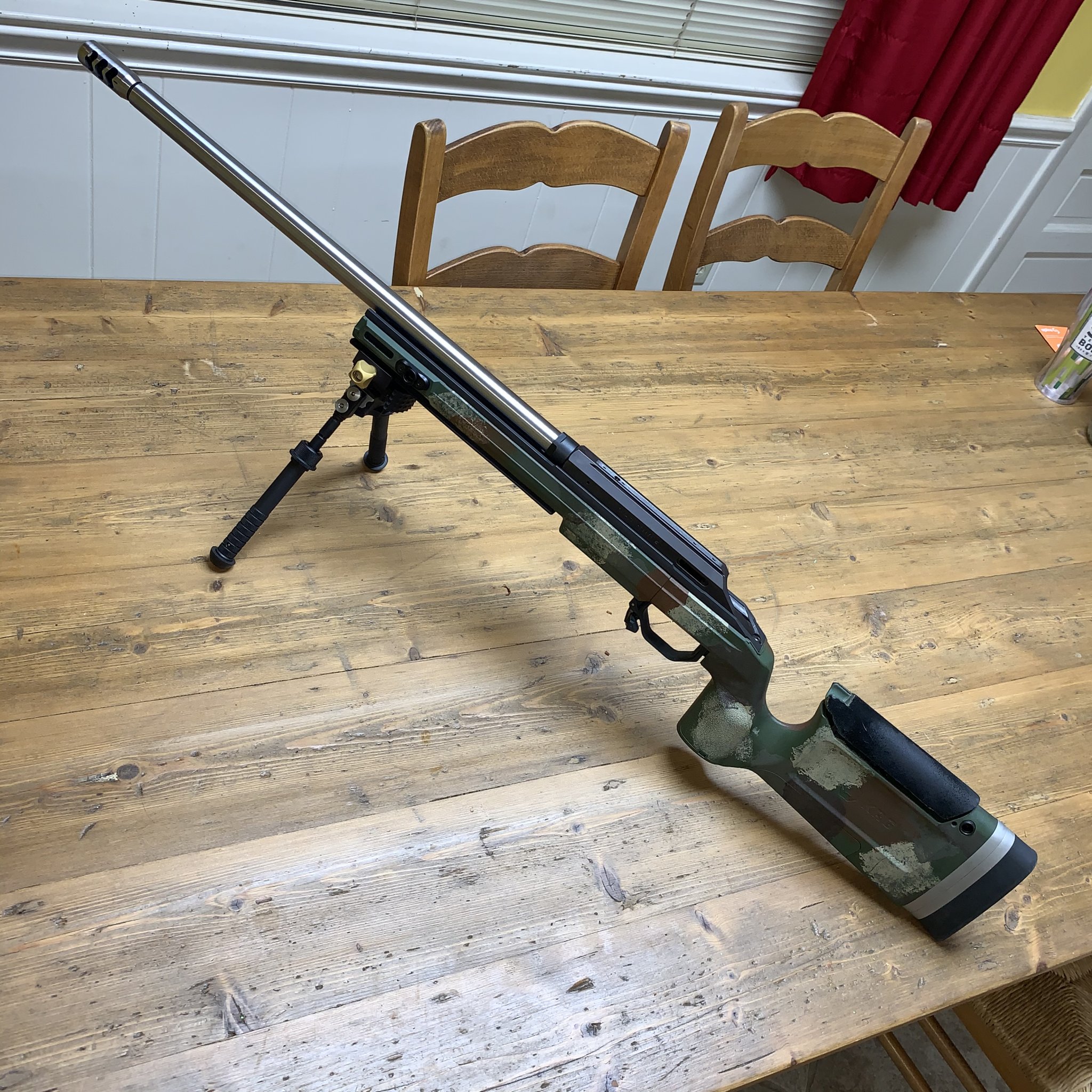

    I got the barrel threaded in, headspaced and the scope remounted with taller rings. The new barrel is a larger OD that the “Lite” profile barrel that was original to the action, ang the sun shield interfered with the new barrel

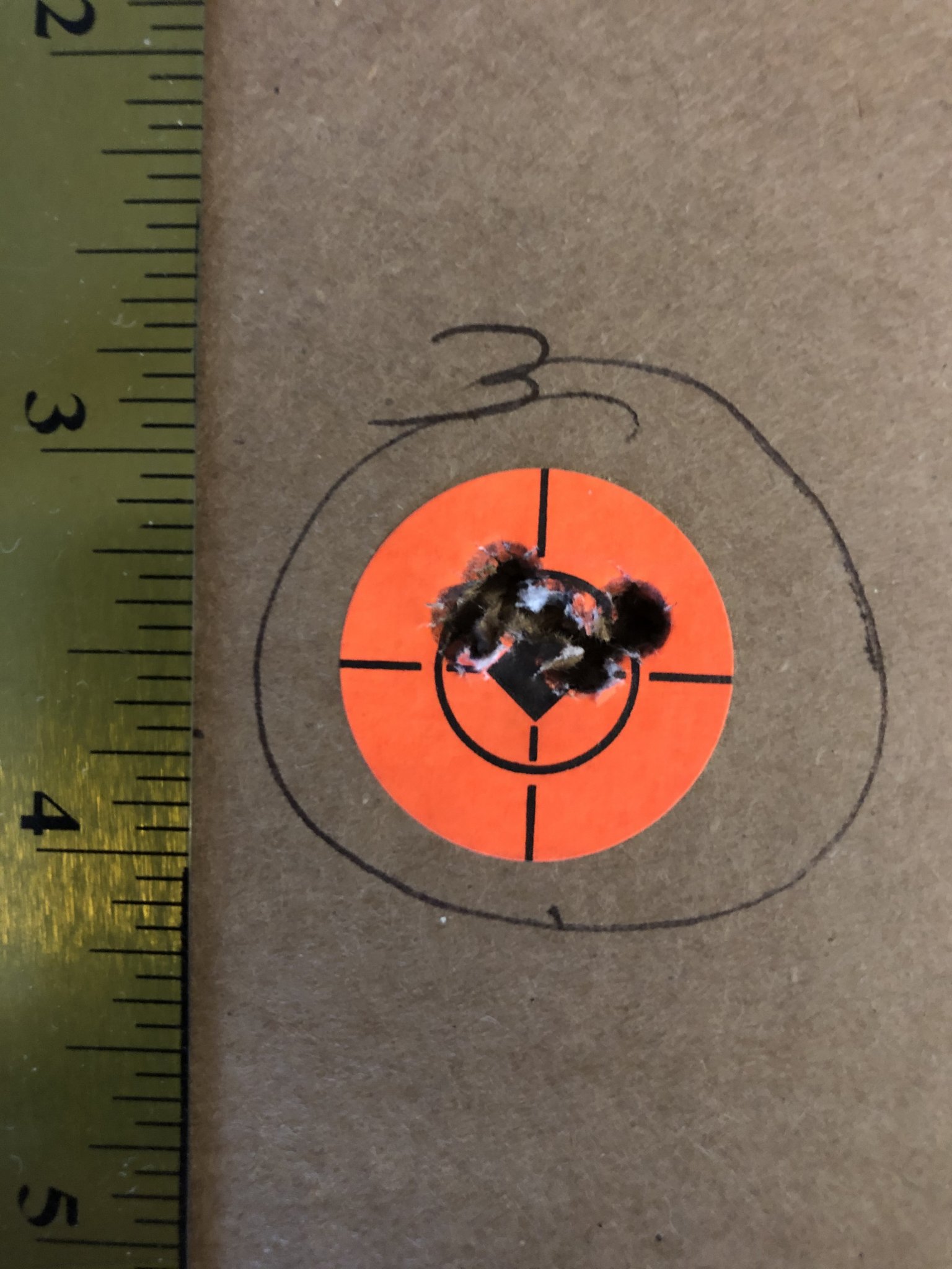

    This barrel is a shooter so far:
    Bulk 75g Hornady HPBTs with a cannelure in front of IMR 8208XBR with a Fed 205m primer in Starline brass
    77g Sierra Tipped Matchking
    In front of AR Comp with a Fed Primer in Lapua brass
    ETA: grid squares are 0.360” to match 1/10 mil at 100 yards.

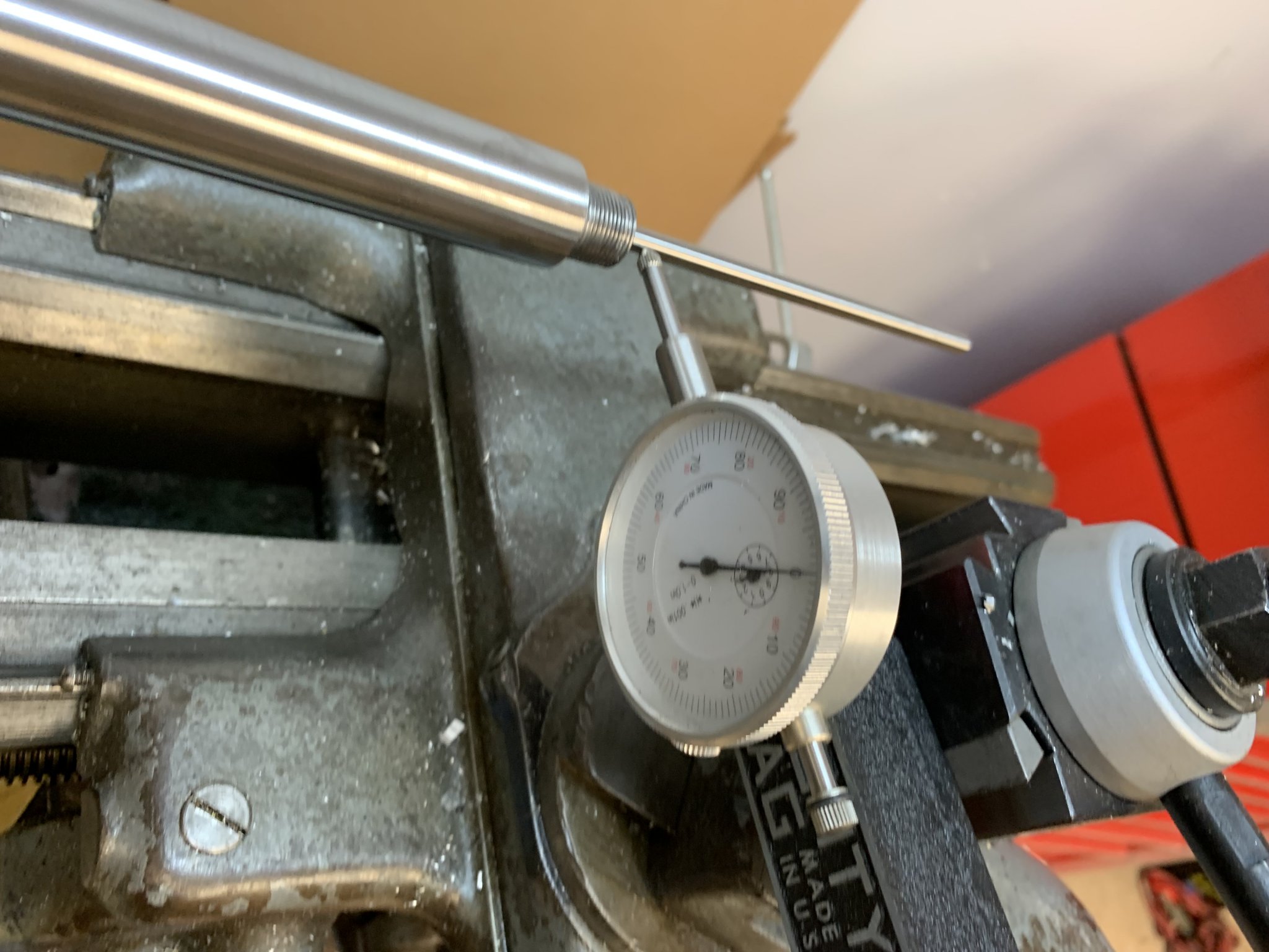

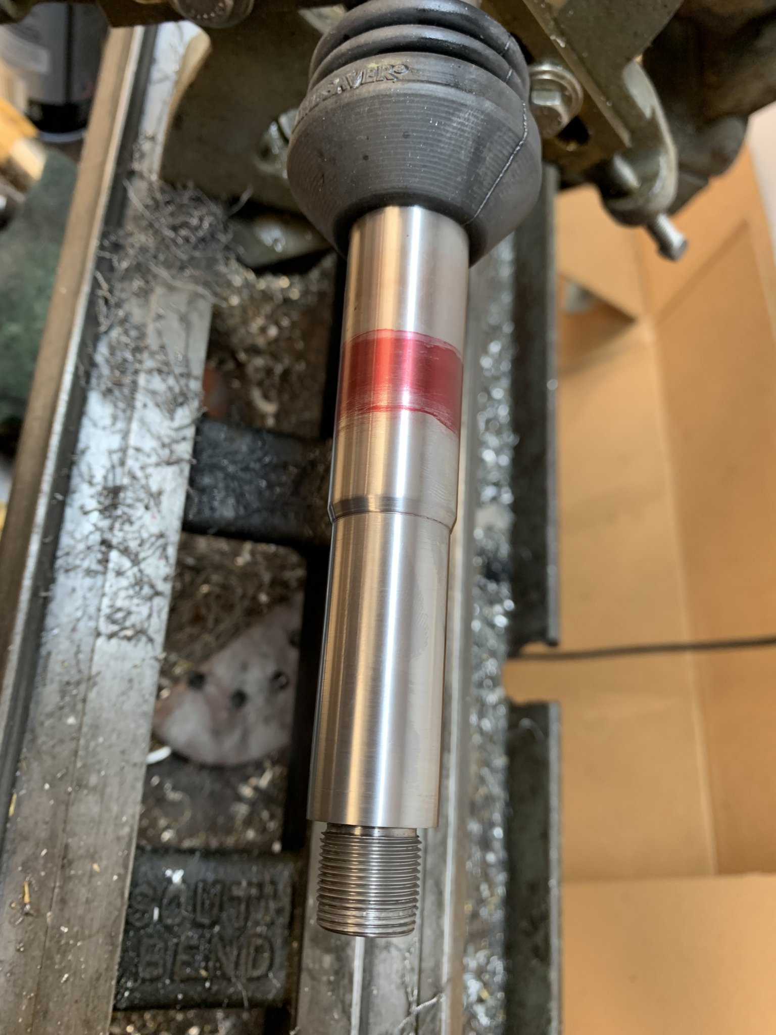

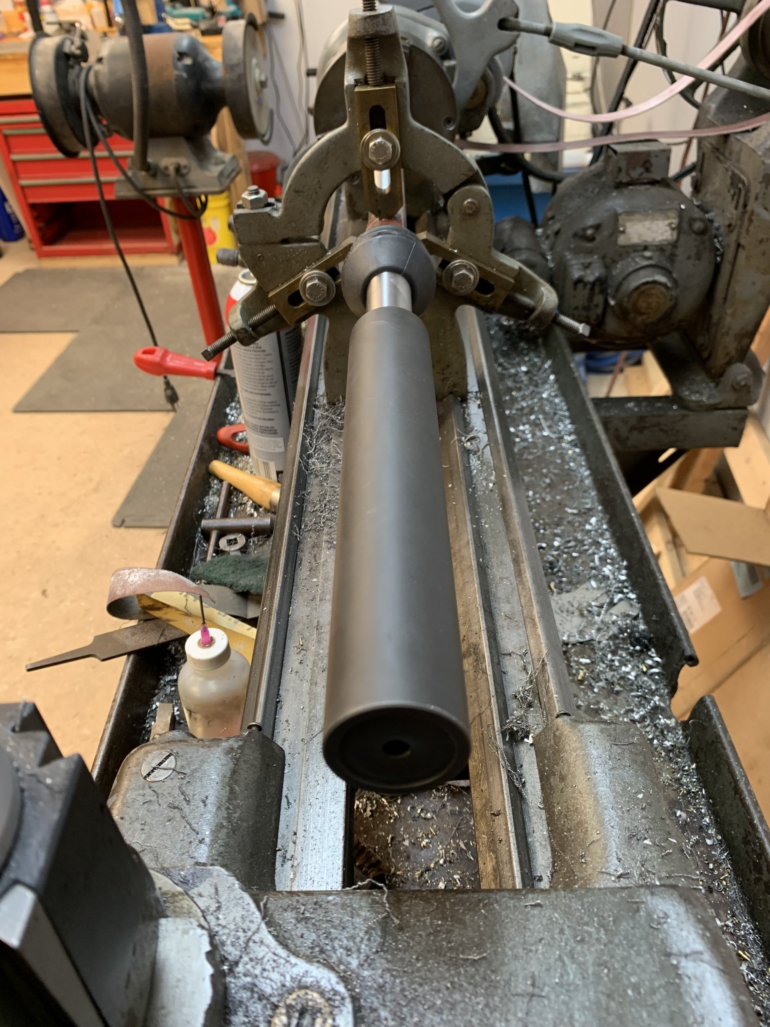

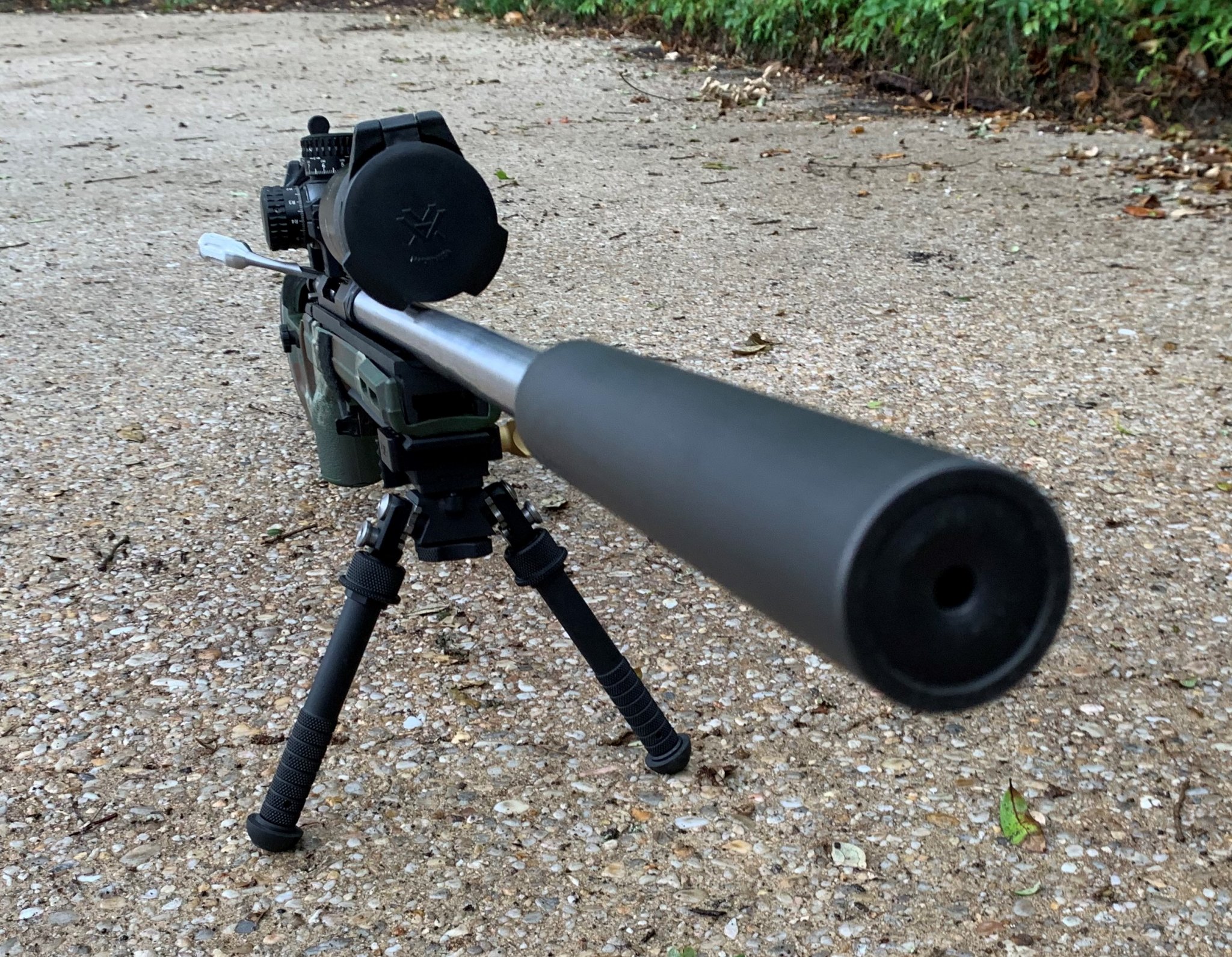

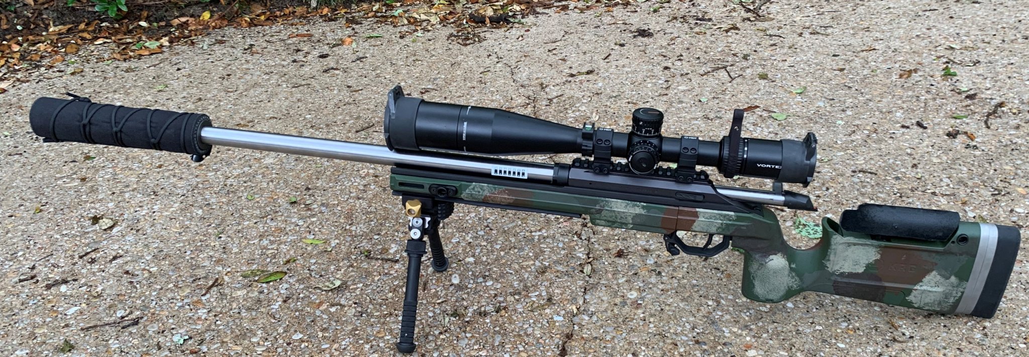

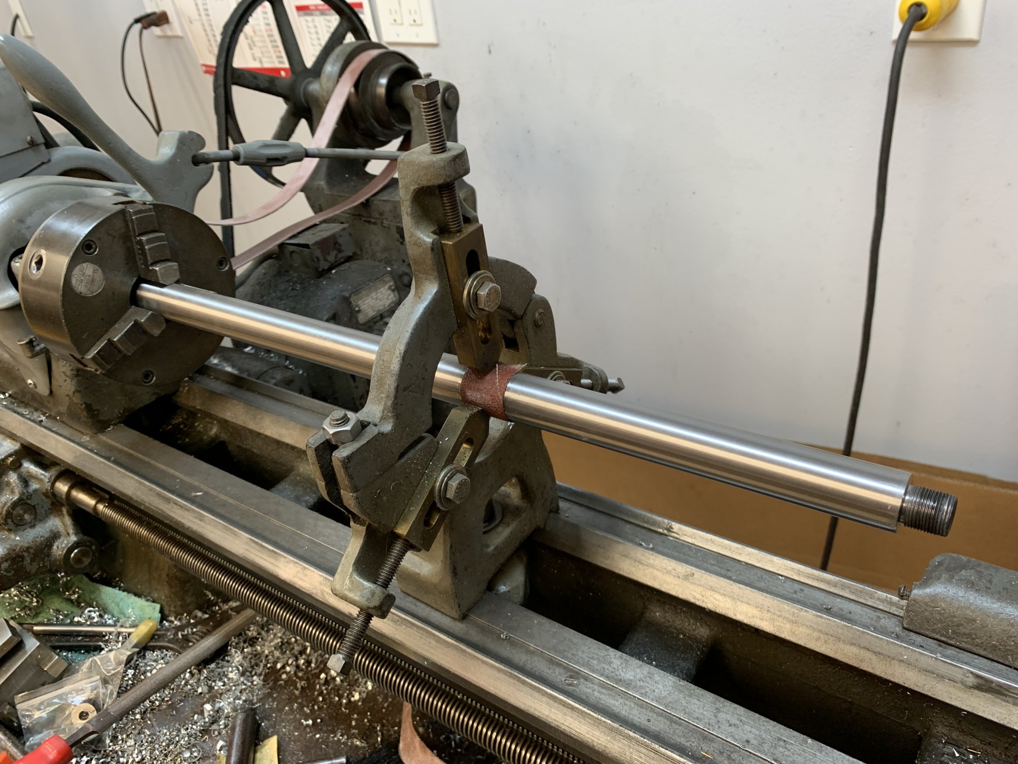

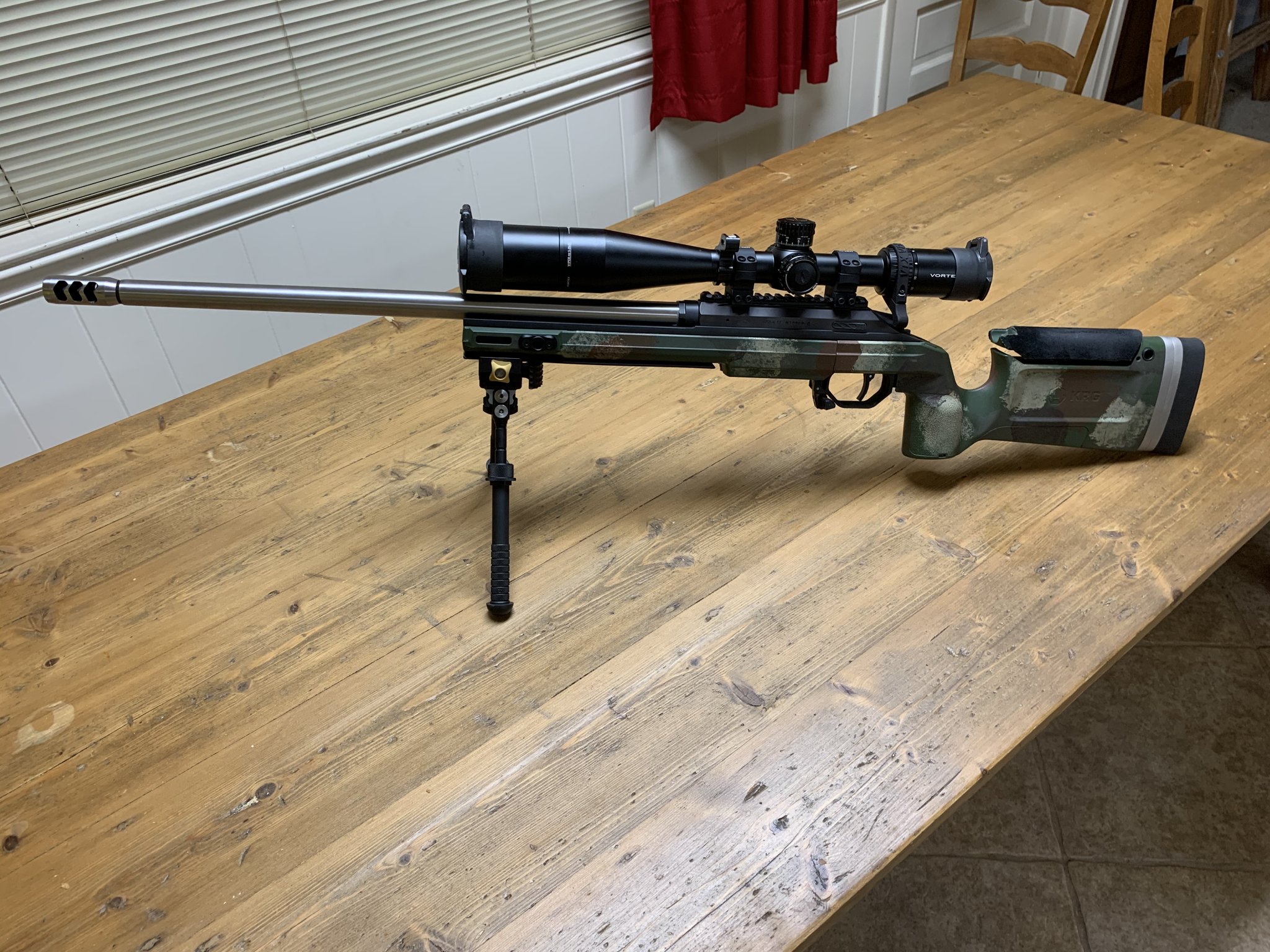

    Pulled the barrel today and set it up in the lathe to cut and taper it to direct mount an AEM 5 suppressor that I bought for my Mk12 Mod0 clone.
    Starting point:
    Barrel in the steady rest - the through hole ID in the headstock is smaller than the barrel OD
    Indicated the bore
    OD Cut & Tapered
    Test Fitting
    Reassembled and ready for a range trip
