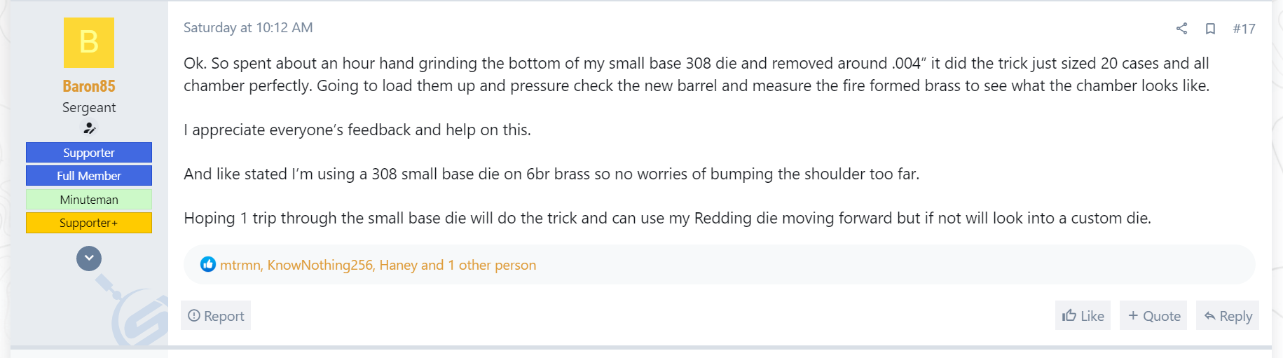

The best solution I have found if no small base die is available in the cartridge you wish to use, is to buy a reg sizing die that is spec, and have a smith or a machine shop bore the shoulder off the die, then remove enough off the bottom of the die to get to .002" under the chamber dimensions. Or if your press a coax, you can just remove the upper part of the die, and this may be the least invasive.

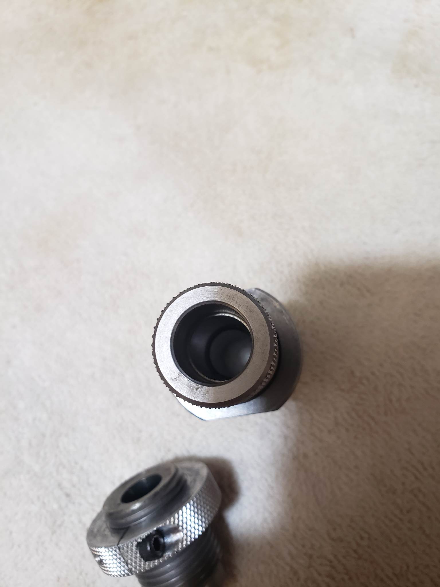

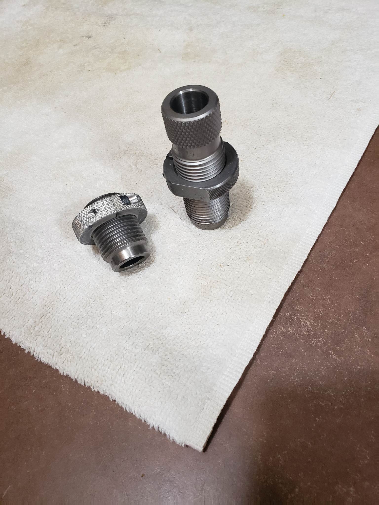

Here is a pic of both, a 243 SB die with the shoulder bored off, think a x47 die with the upper half removed(favorite).die.jpgdie1.jpg

maybe this will help those in the future with tight base or clicker issues and don't want to use a small base die. Small base dies really works the brass back to factory.
