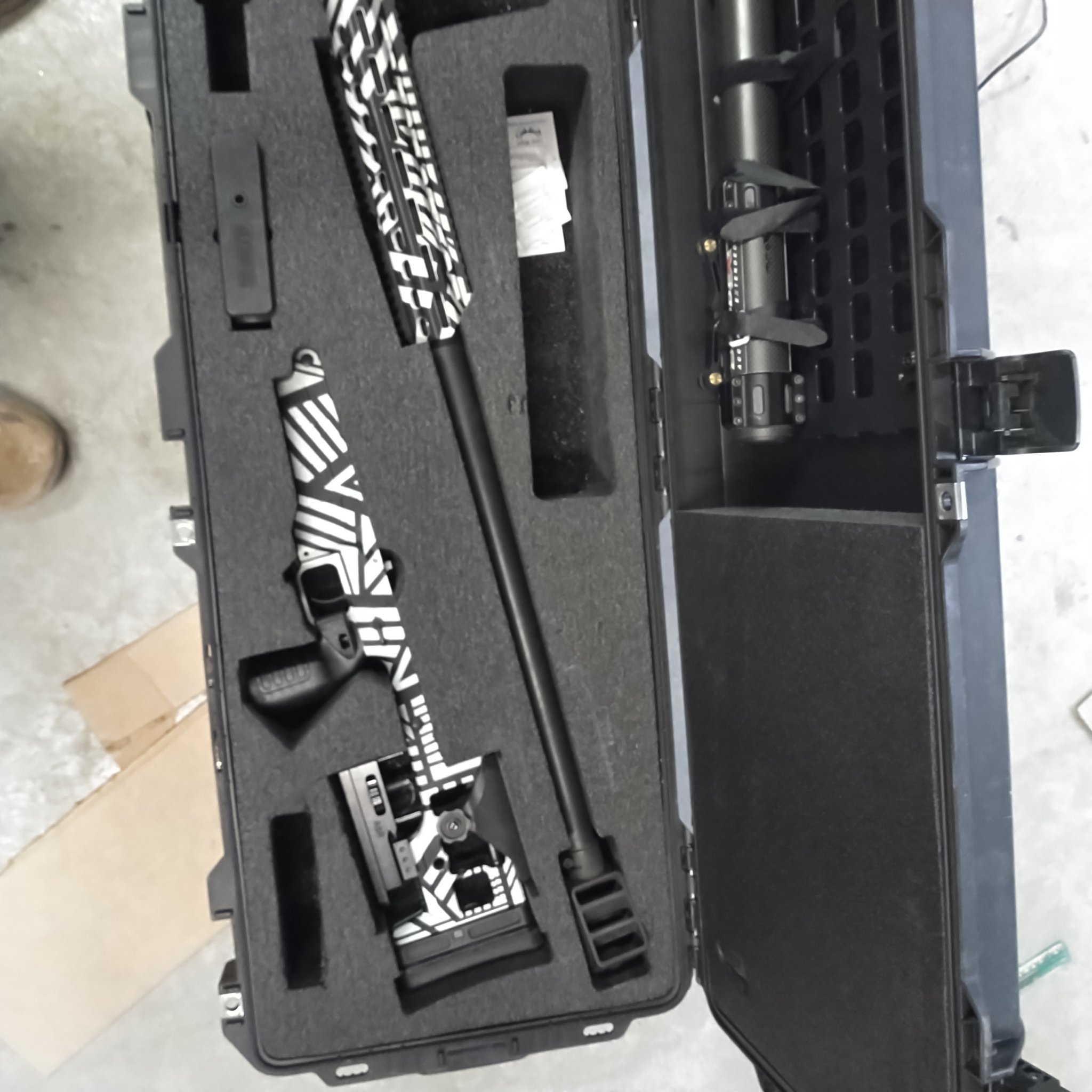

When they switch calibers is it the entire what looks to be an upper in your photo or is it just the barrels?

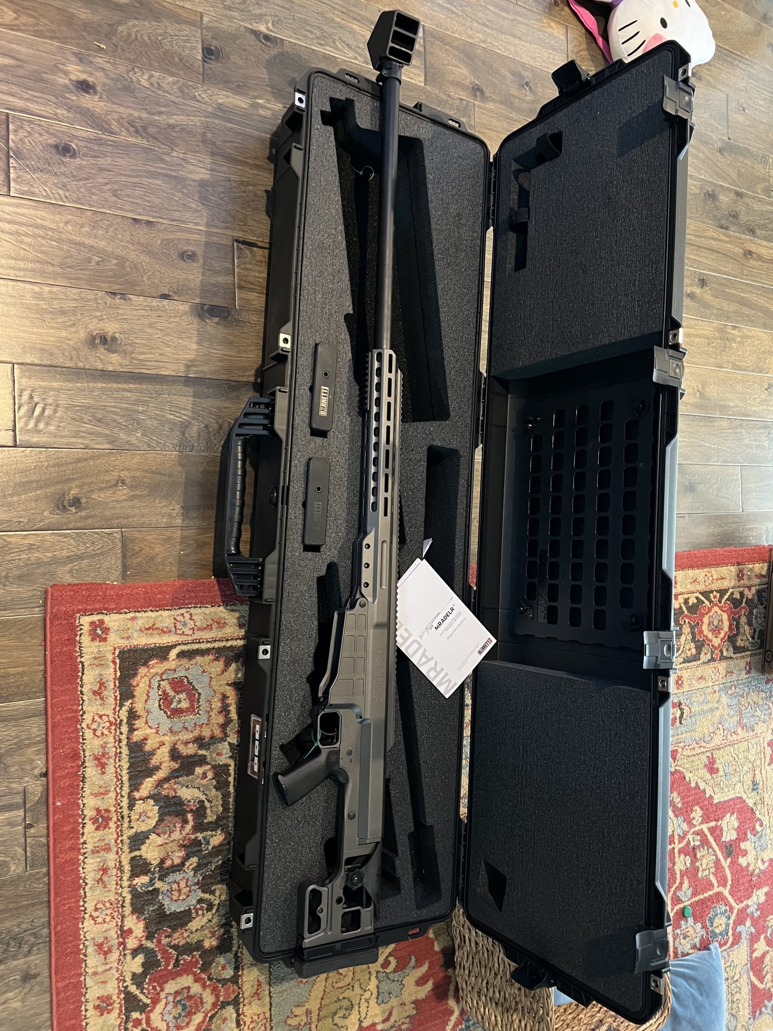

Showed up today. Any good sources for .416 Barrett reloading?

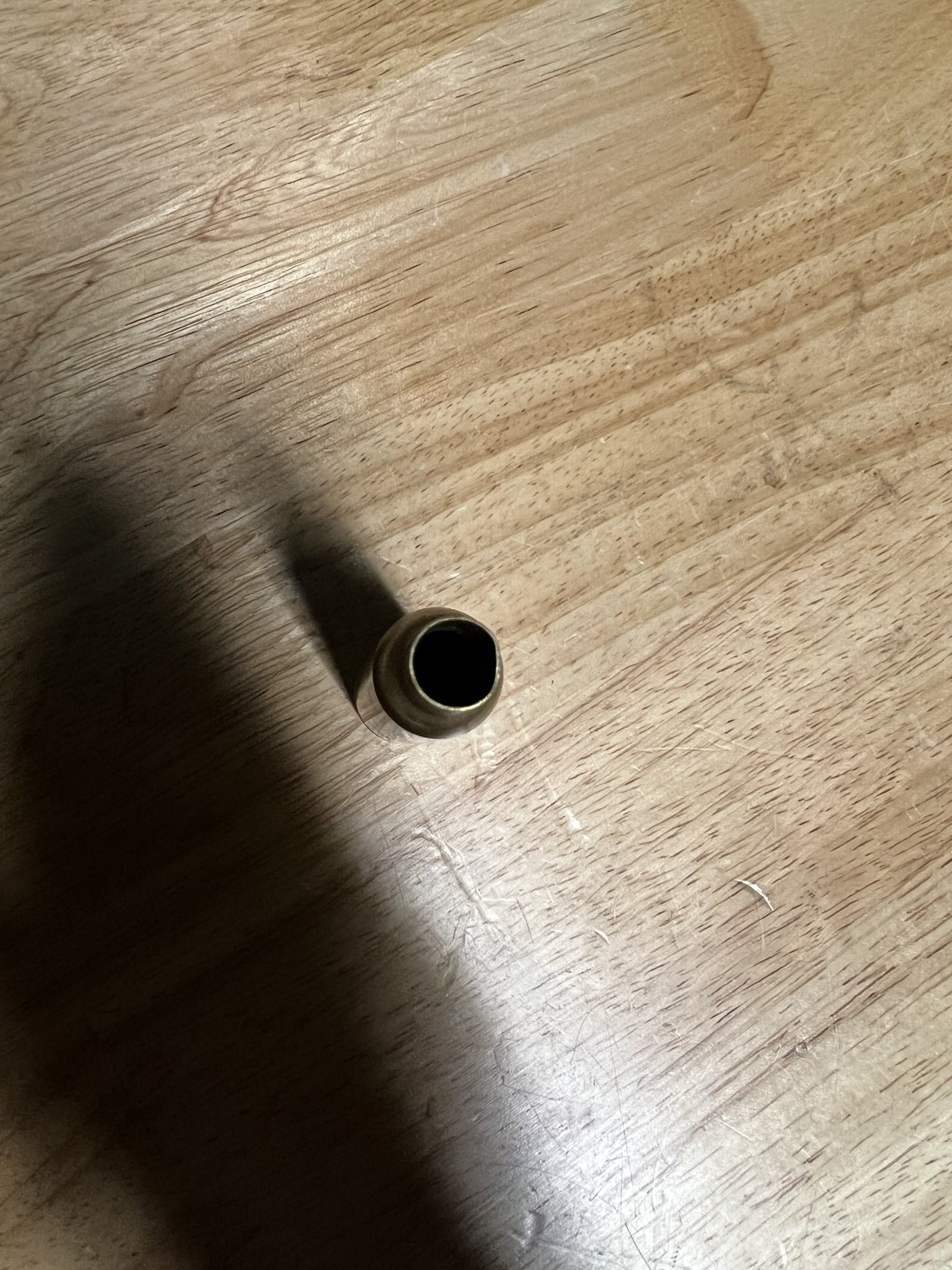

The RWS "50 Browning" stamped brass I have from Dale Arenson and his importing partner is marked "RWS" on the boxes (all 16 of them); The "T" brass I have that is RWS is made in Thun Switzerland. I have never seen a brass headstamped "RUAG" or boxed and labelled RUAG. I do know that the 50 BMG primers I got from Dale with the brass are all in these boxes which are marked both RUAG and RWS.
I'd like to learn more about this RUAG brass.

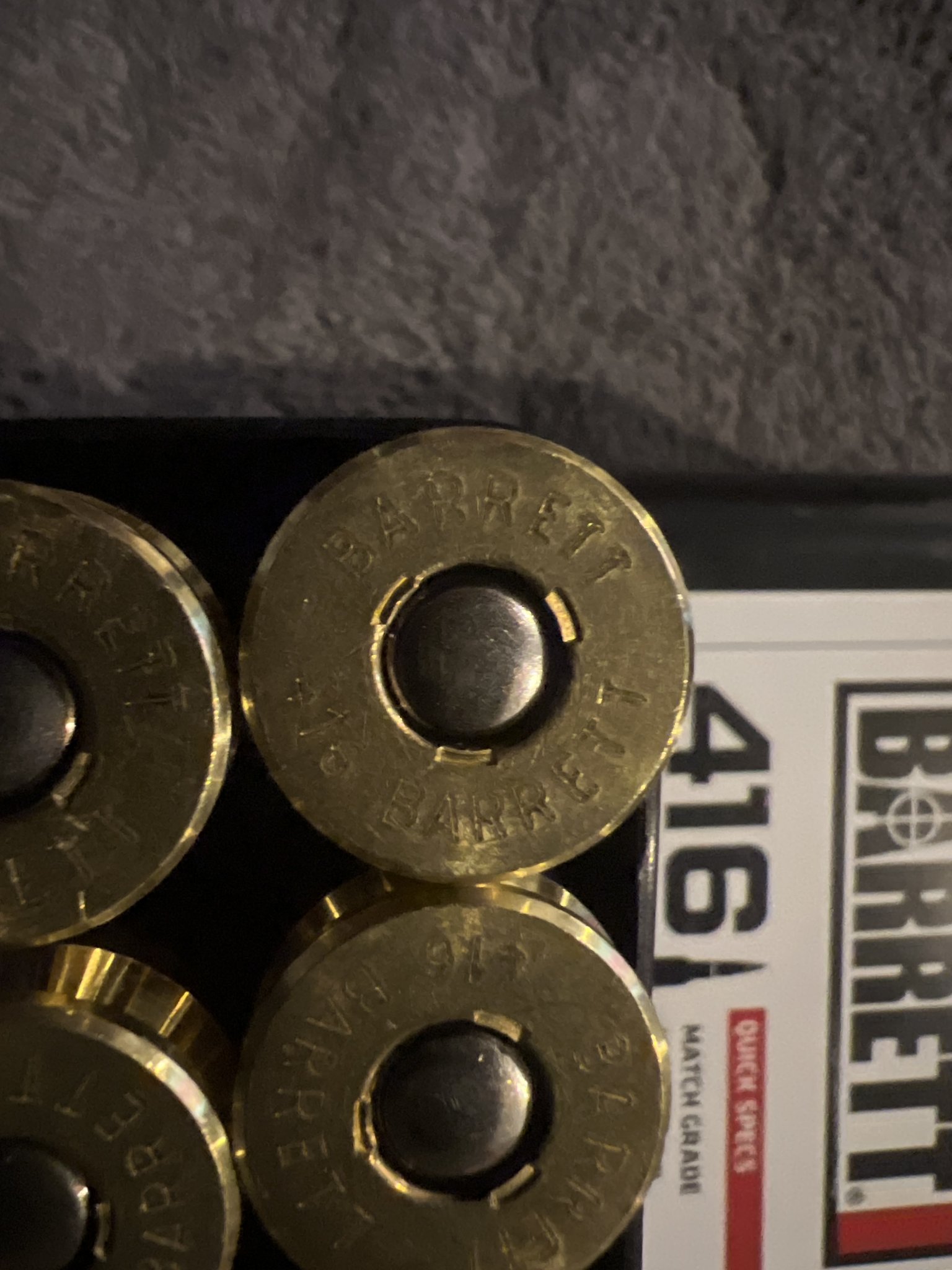

After a conversation with Dan Warner earlier today the RUAG brass is the factory 416 Barrett head stamp and the brass that's offered from Barrett . It's the brass that has consistently had extraction problems and issues resizing. The RWS 50 brass you get from Dale is the same rws brass that Dan works over and makes our match 416 Barrett brass from.

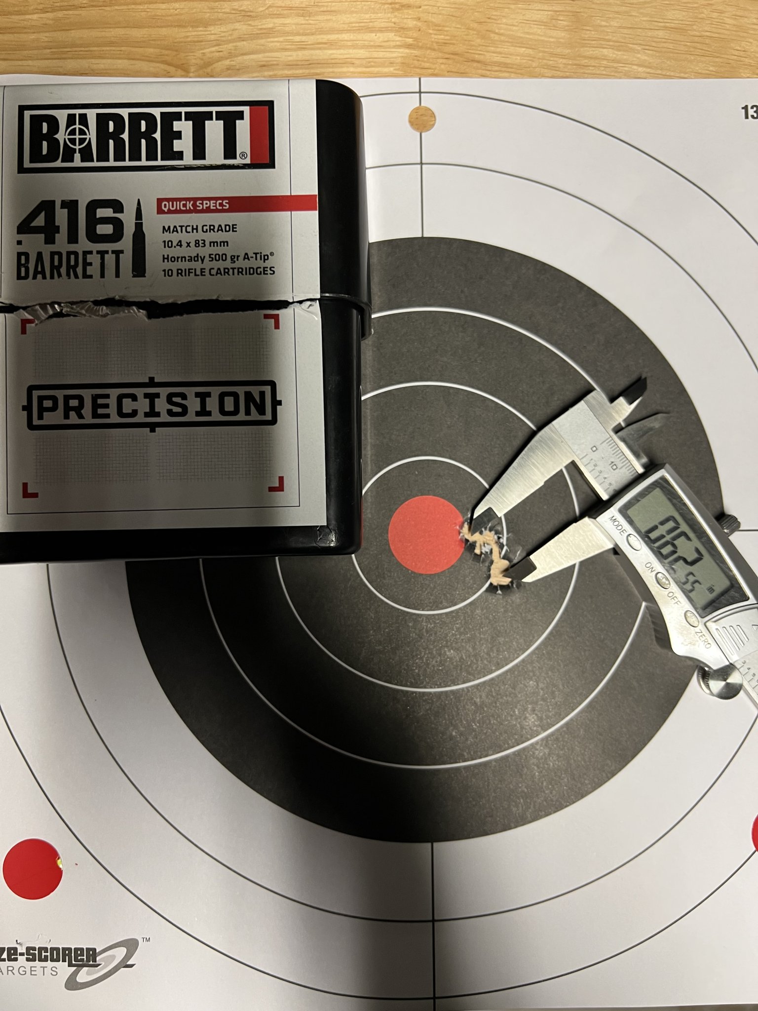

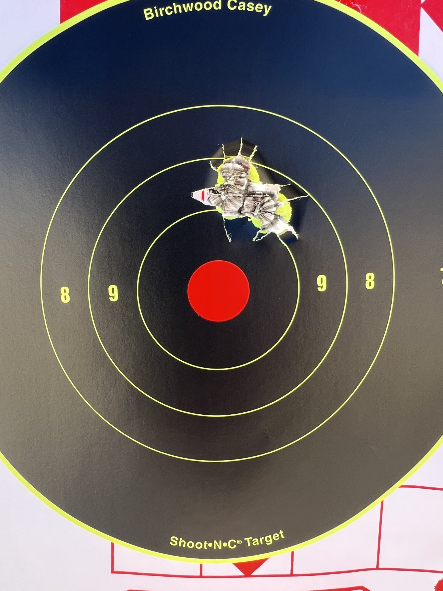

Got the first 20 rounds down range today. Initial thoughts are that it is super heavy, but accurate, with surprisingly mild recoil.
It’s comparable to somewhere like the 300 win mag and 338 Norma in the standard MRAD.
Fired the 500 gr ATIP match ammo available through Barrett. This thing hits the pocket book hard. Even reloading it’s going to hard to get the cost under $6 per round.
With a small sample size, it’s more accurate than I was expecting. 3 round group after zero measured 0.62in. Shot a coupele three round groups at steel at 500 yards that all measured about four inches. Still have a lot to figure out how it does with hand loads and at distance.

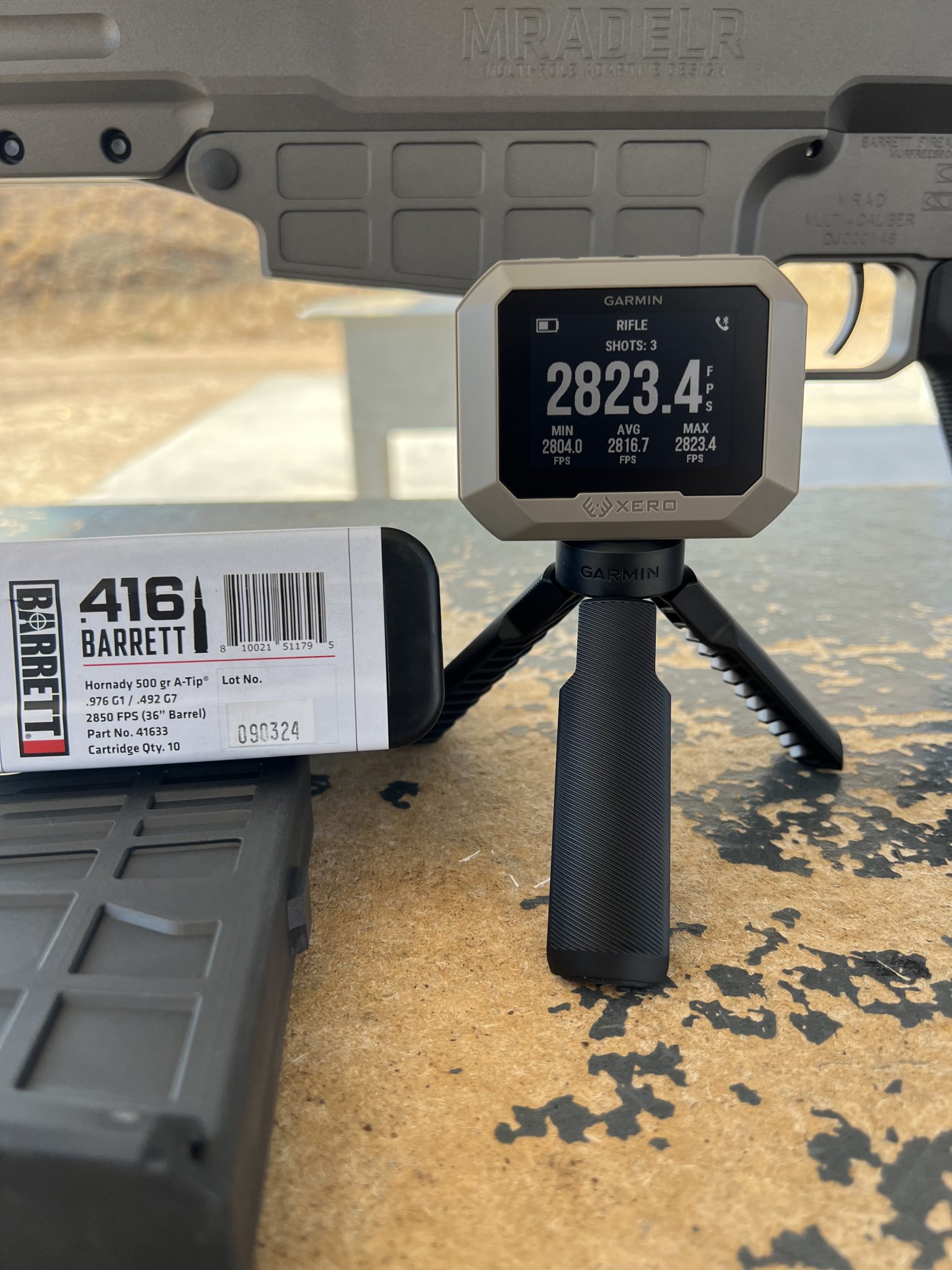

What did those factory 500 grain ATIPs chronograph at?

Just got a garmin so took it out today.
Factory has the 500 atips listed at 2850 I came in about 30fps under. Don’t know if these barrels are expected to speed up or not my round count is at 50. I think and ES of 20 would be awesome from a factory offering, the sample size is still low though.
Cloverleafs at 100 meters every time though.

You are less than 1% away from the advertised velocity so I would definitely say it is completely consistent with what is on the box. And yes, it might speed up 50 ft./s with more rounds down the tube.
+2850 ft./s for a 500 g projectile with that ballistic coefficient is certainly no slouch

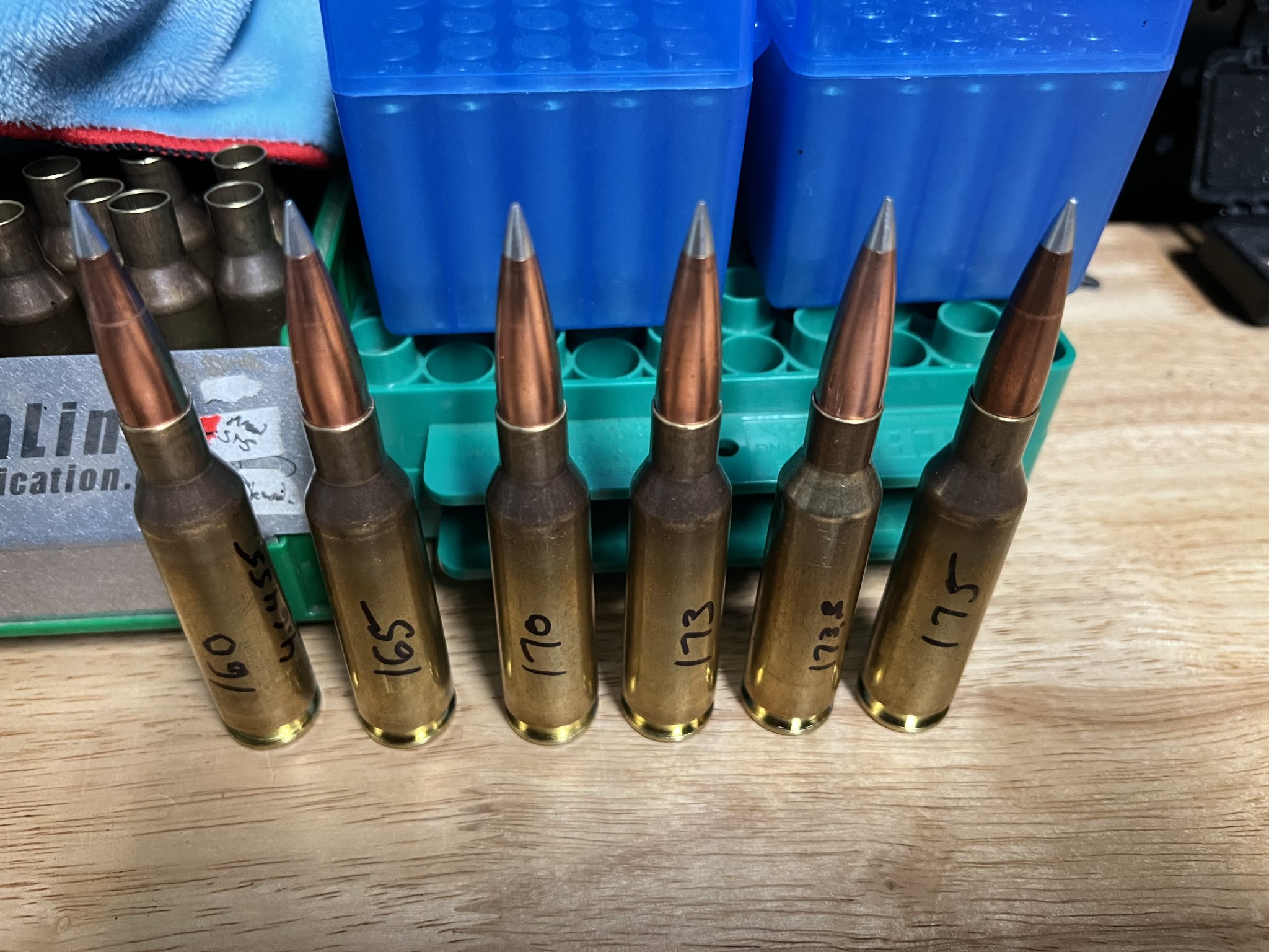

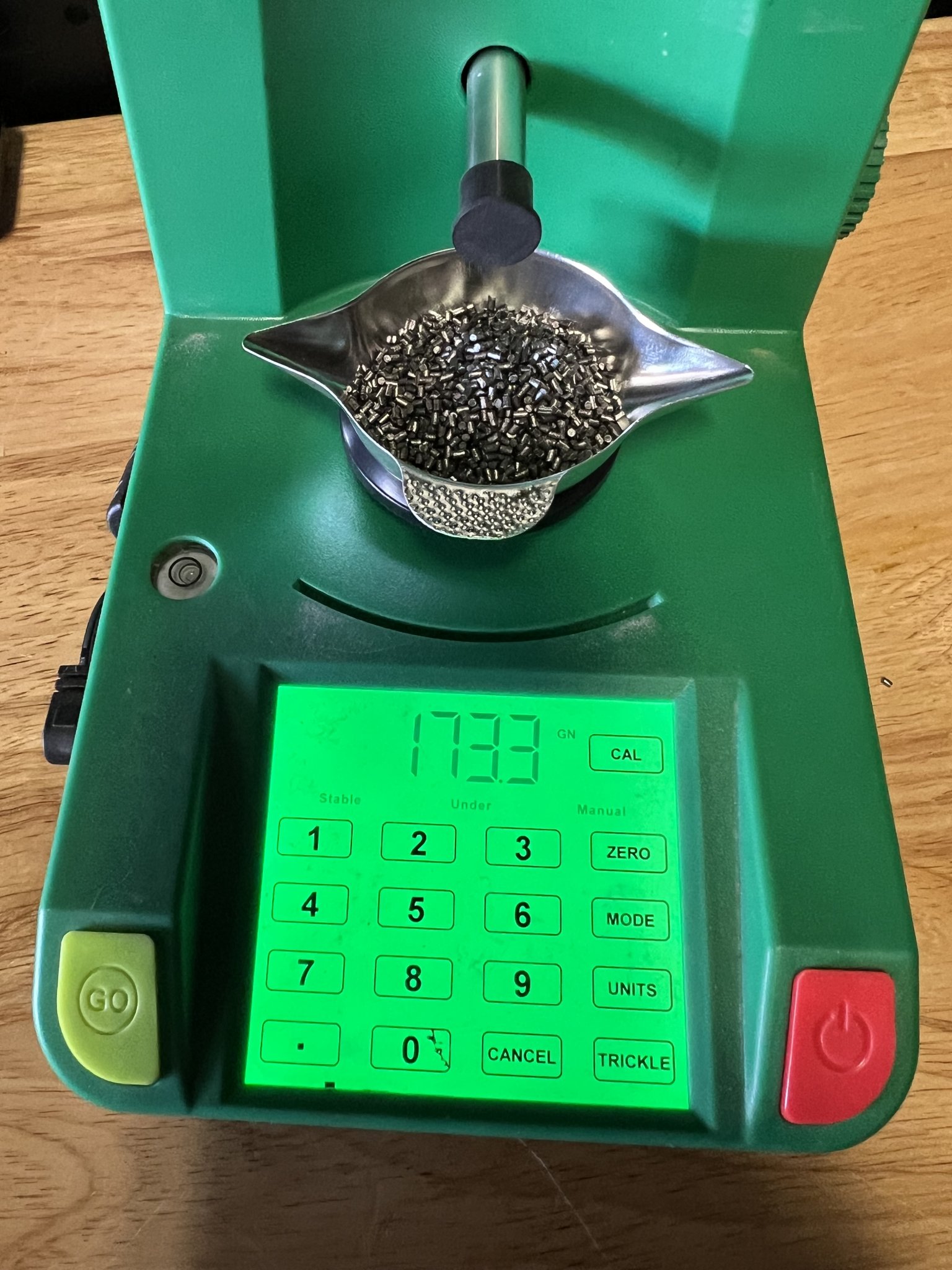

I pulled a bullet as suggested. It definitely appears to be RL50. It weighed out at 173.3. This is precisely within the charge weight range that was suggested to me by another member to match the factory speed of 2850fps. So that is good data.

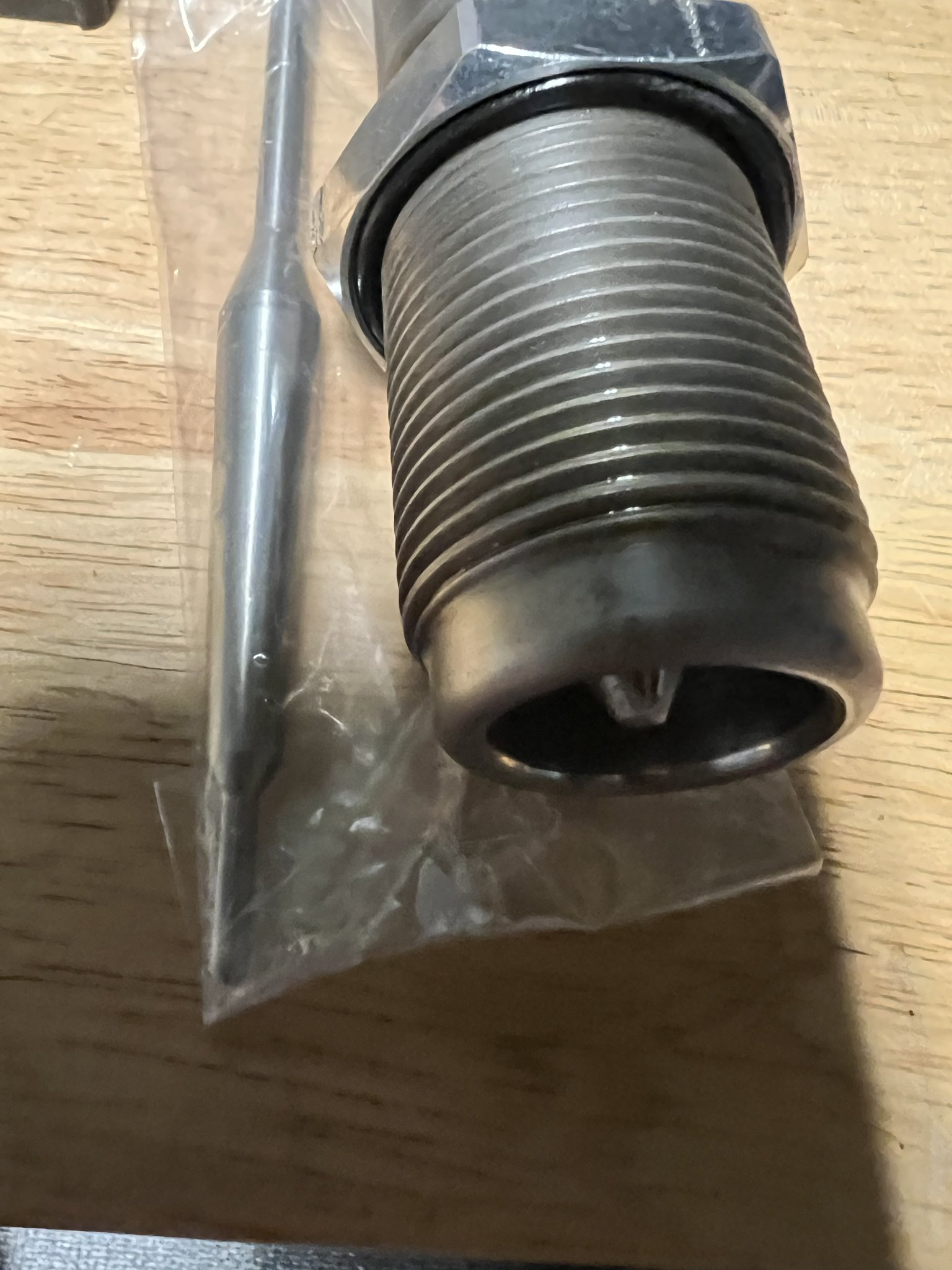

Buy once cry once might be obvious to most, but I wanted to get something compatible with what I had laying around and got the Lee dies to work on my old Lee classic. Let’s say it’s doable, but not ideal. On the fresh brass I cut the decapping pin off the expanding unit to attempt to make everything more concentric without punching the primers. I bought a spare pin for decapping and sizing in one step in the future.
The Lee die resizes closely to the factory dimensions measured with a comparator. Though my fired brass visibly has a sharper shoulder angle taking on essentially a fire formed appearance. I’m thinking custom dies will be the way to go in the future.
Loaded up a couple of charge weights to try. The goal is ultimately to meet or slightly exceed the factory 500gr offerings, while maintaining accuracy, which has been really good in the factory loads (only tested to 500 meters so far).
The Lee seating die is also hard on the Hornady bullet, leaving an ogive ring mark, so that needs to be addressed too.
