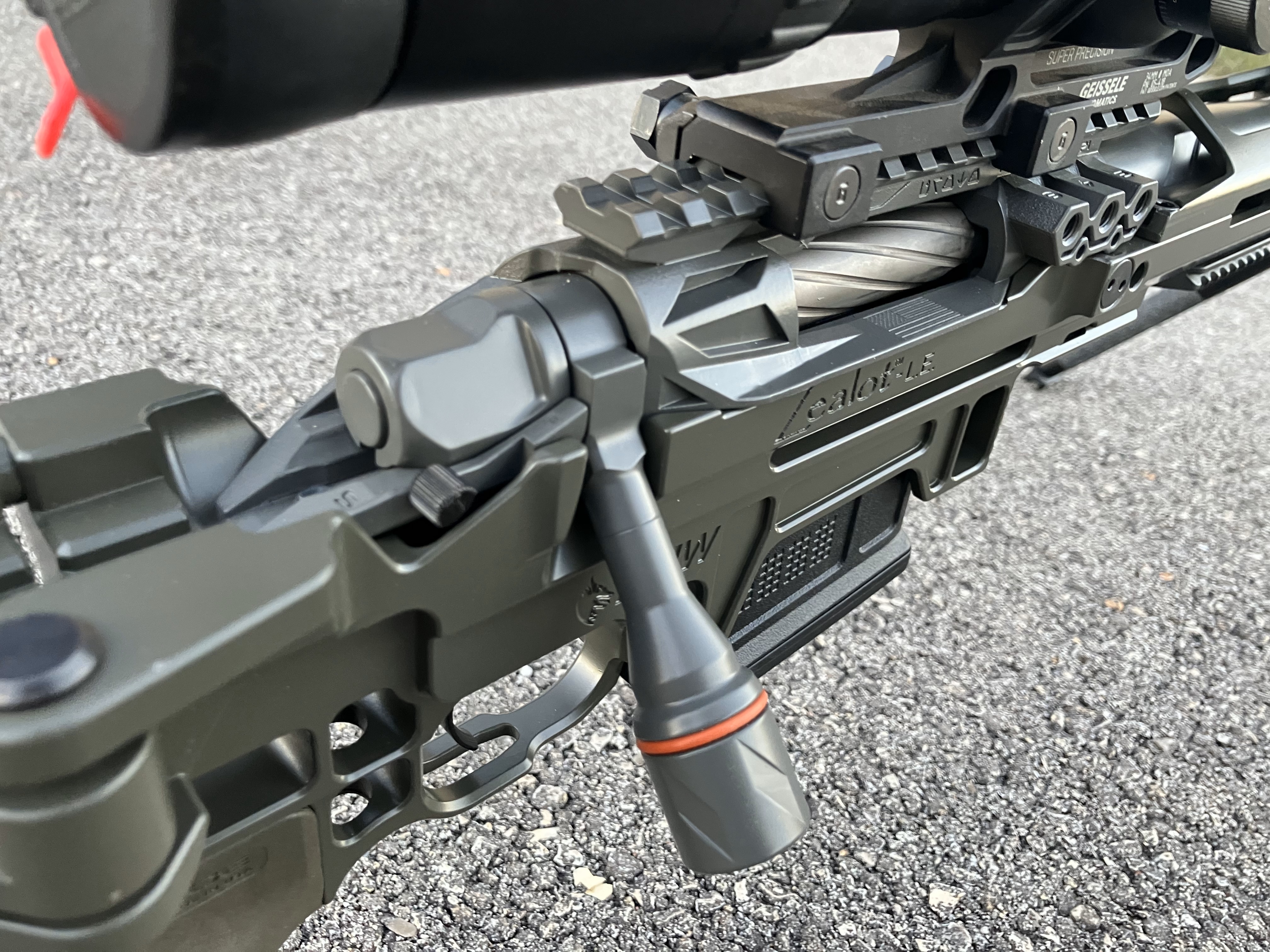

I got to see one of those actions the other day in Matt's shop (I'm assuming this is one of Preston's).
If you're inletting a Zealot for one, I might be coming up with an idea. We were joking about some knucklehead showing up at regional F-Class matches with the most tactical thing out there...
That would be it.
Tell Matt I said Hi next time you see him.
In process
Well, somebody's got to do it!
That would be it.
In process
