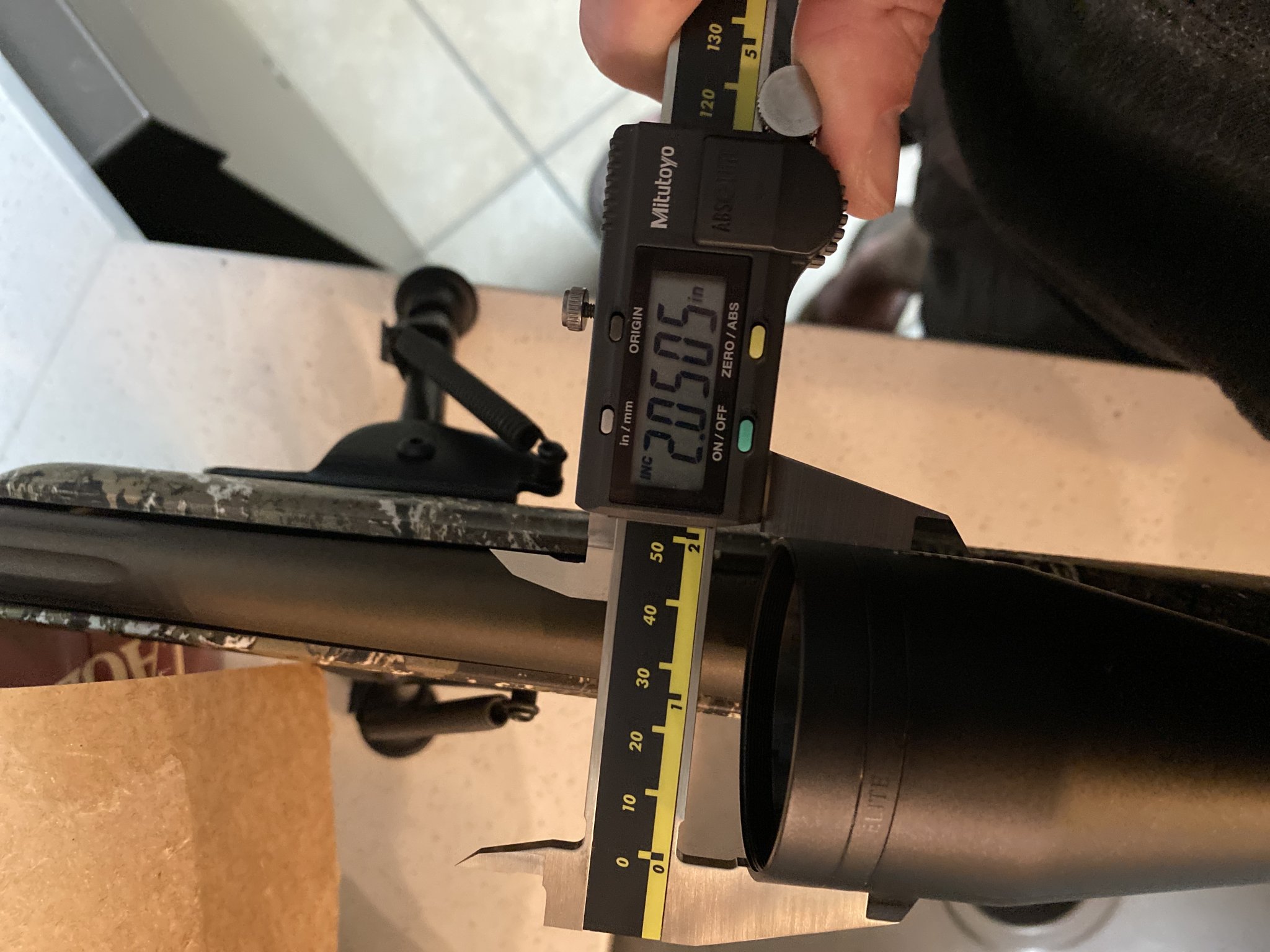

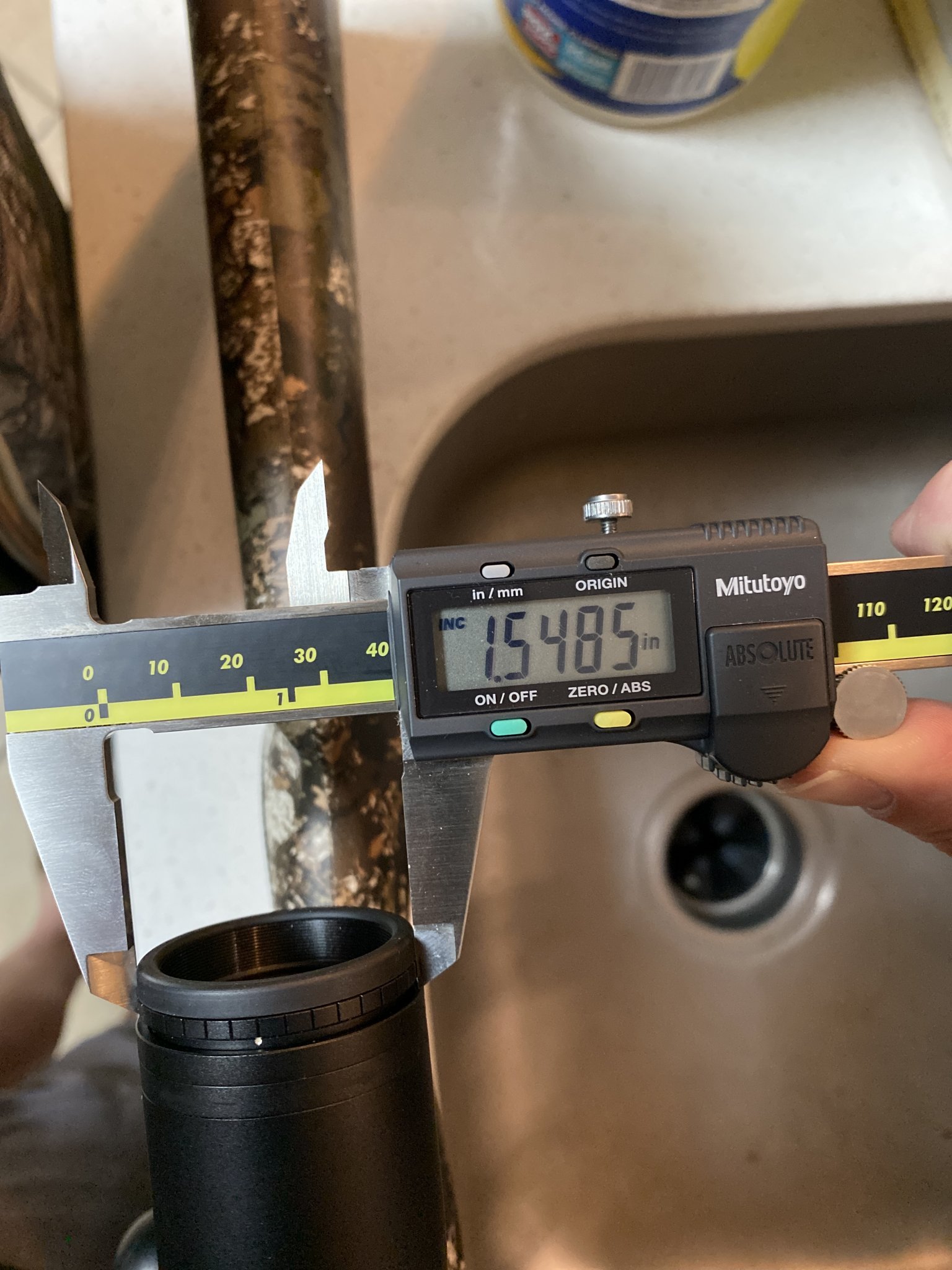

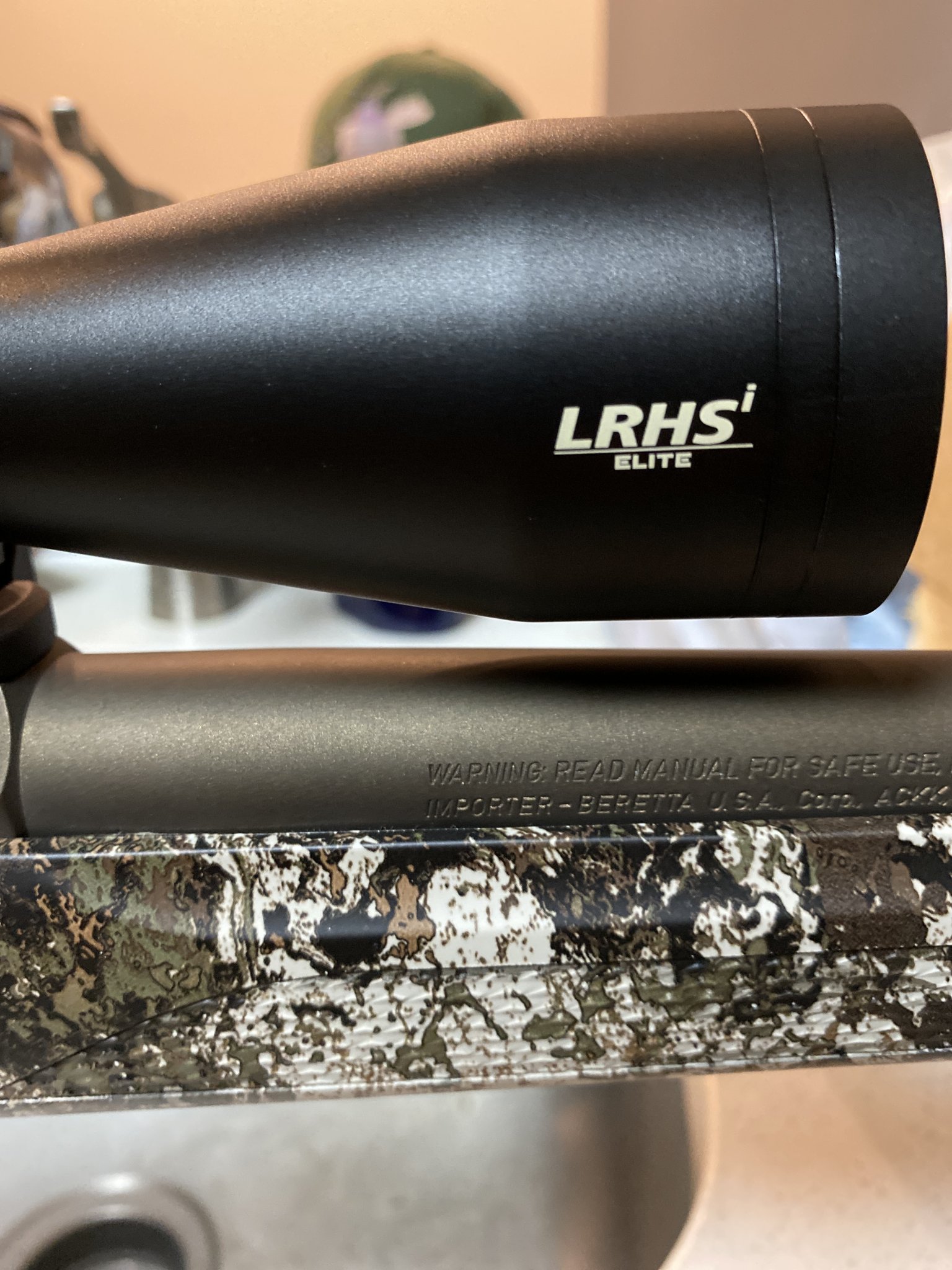

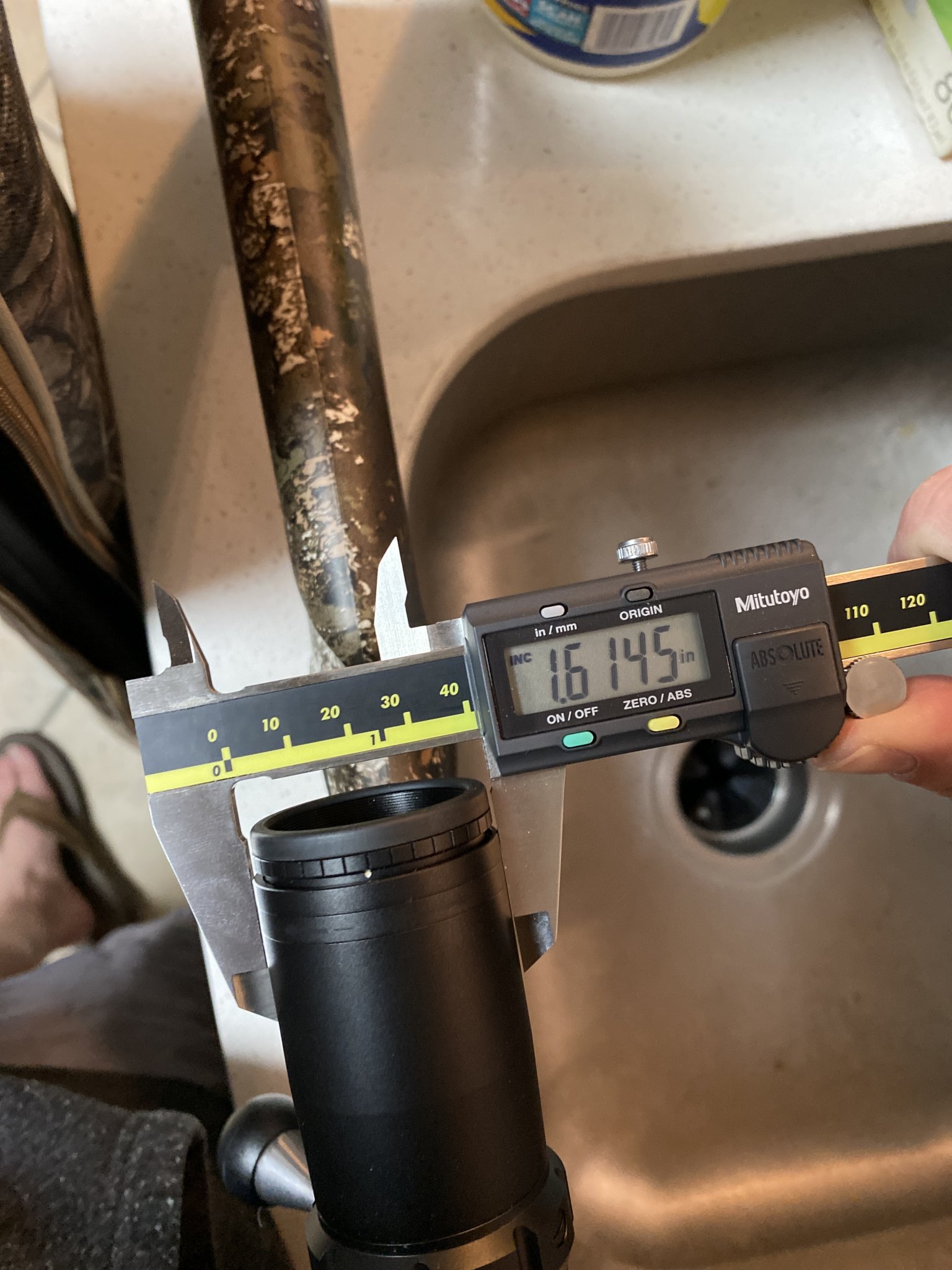

While we're on the subject - can someone please measure the outside diameter of the objective and ocular lens on a Gen1 LRHS 4.5-18 down to the .000" --- I'm trying to order an ARD and ocular lens cap from MK Machining and they need the value for proper fitment. My digital calipers shit the bed .
Thanks in advance

Obj: 2.050
Ocular: 1.605
There’s a slight gap between the ocular ring and the body there so maybe go 1.6145.
