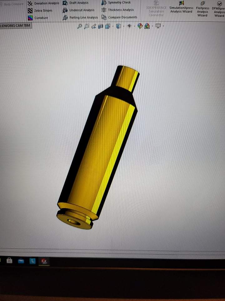

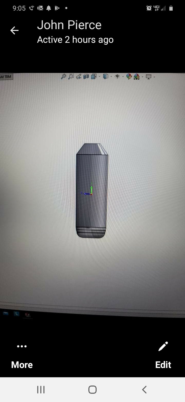

I figured it was time to start focusing on some of the smaller cartridges. Several years ago swamplord and myself Worked with John Pierce at Pierce engerneering to have the 800 series (wildcat ) actions made. We quickly became side tracked with the devlopment of the 20x action and cartridges it utilizes. But all allong i kept thinking about that 800 series bad ass action. So last week John and i started on the Warrior series cartridges. The warrior will harness both rebated and ultra rebated rim diamiters. ( lapua and cheytac rims customers choice ).The cartridge will be desined to maximize a custom box that we have devloped that is wyatts extend length but much wider as the cartridges will be considerable larger in diamiter then the cheytac and enabelr case but much shorter. The idea will be to create a package rifle mag feed with cheytac/ enabelr performance but has a finished rifle build in the 12 to 15 lb range. Below is a solid works drawing of what will soon become the next generation of our adventure . Reamers have been ordered and brass prototypes will be ordered next week. This one will be fast tracked but the amount of design work still ahead is still staggering

The warrior case has a h20 to case mouth of aprox. 150 grains in 338. Useable h20 138 grains. it will be in 338,358,375,408 a 358 version will be canada compliant.

Case is about the same length as a 30-06 case but is larger on diamiter then the 585 aferican case the aferican case is .680 at web. but this is not a wild cat it is not formed from any known parent case it is new manufactored case design. Thats all i am willing to share at this point in time.
