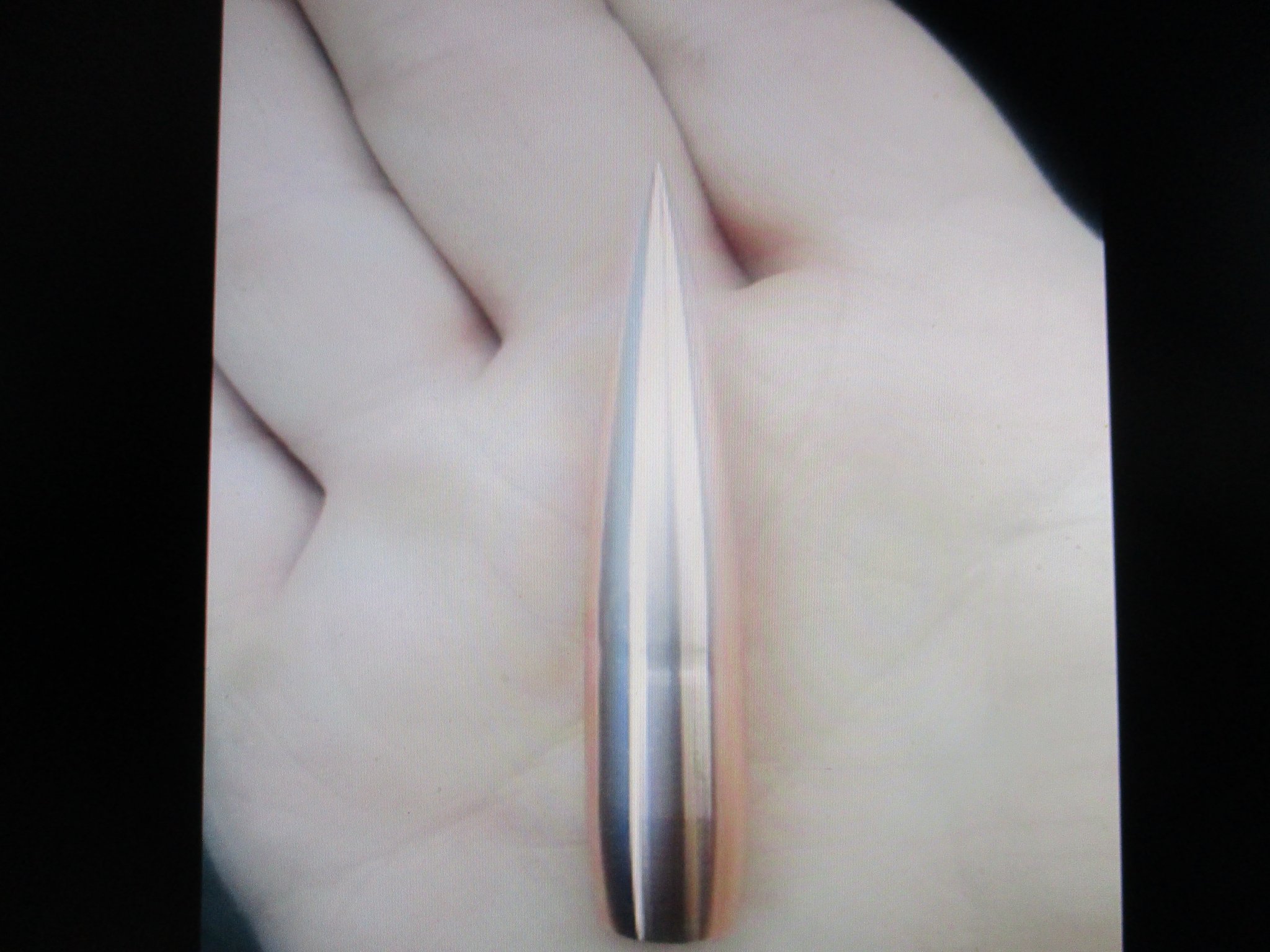

new bullet for the 420 blitzkrieg
the 565 grain bullet bc is conservative will most likely be higher at the velocity we will be running it could be as high as 1.200 g1 and a g7 as high as .615 here is a photo next to a 338 lapua improved and another photo of the actions

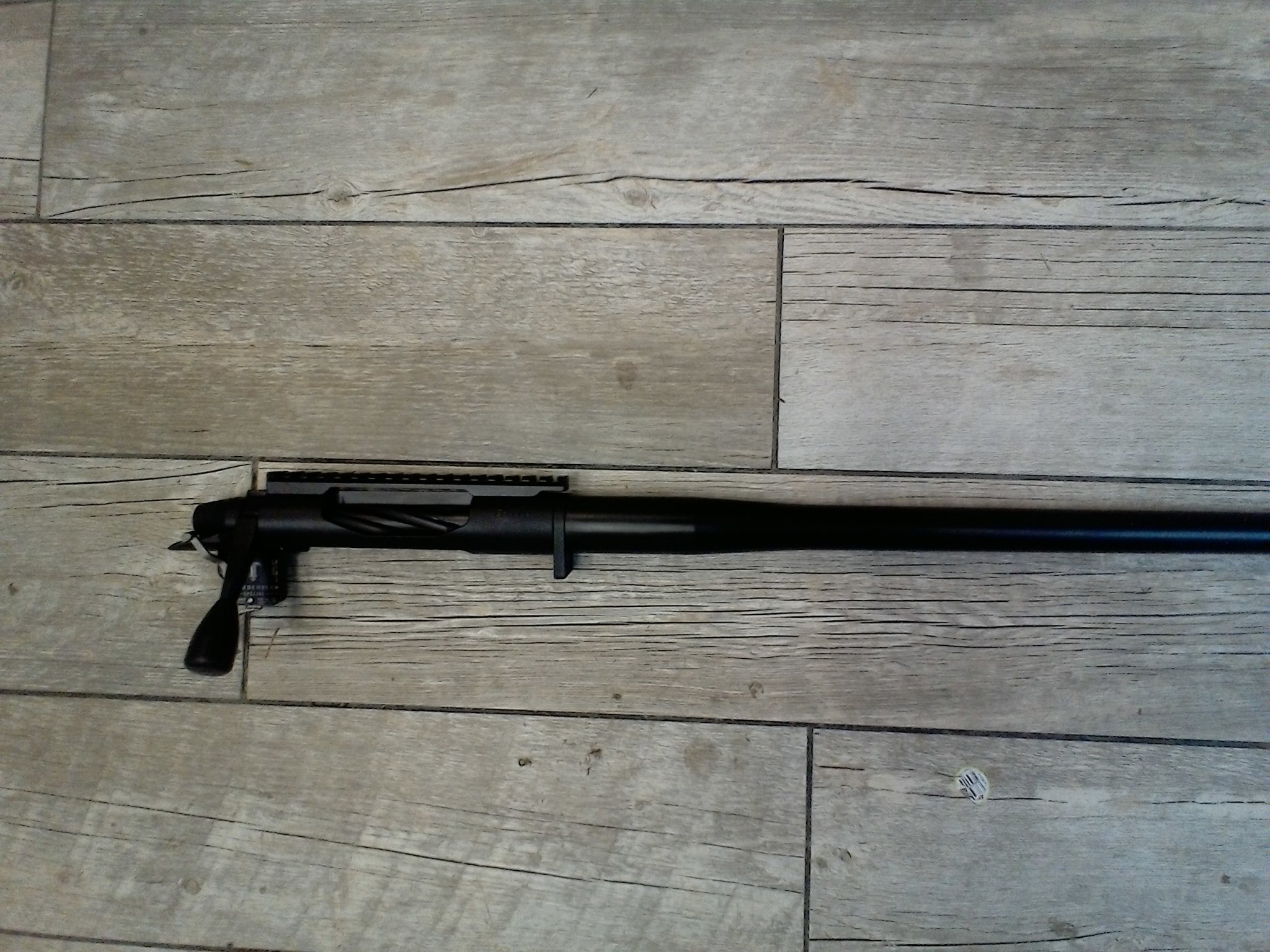

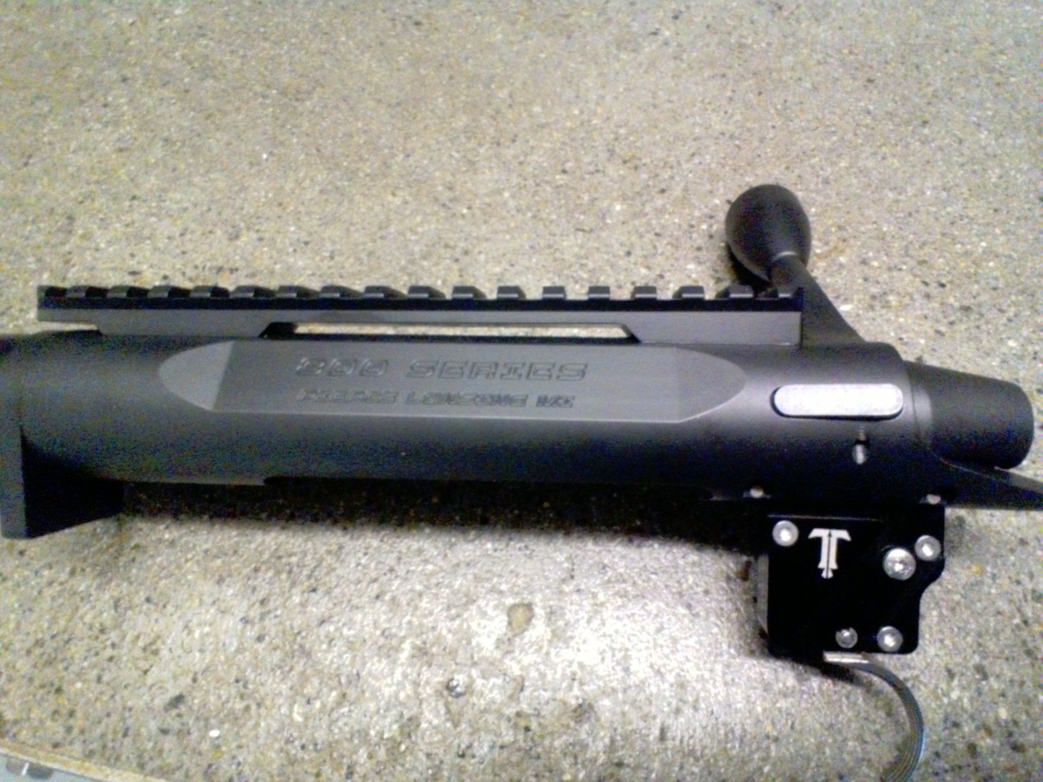

Here is one of the barreled actions for the crusher series in 338 chetyac based shortened wildcat 30-06 length . will be installing in a skeletonized black walnut carbon fiber stock of my design

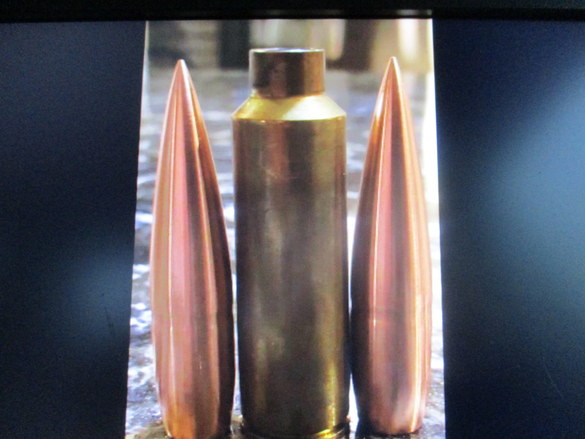

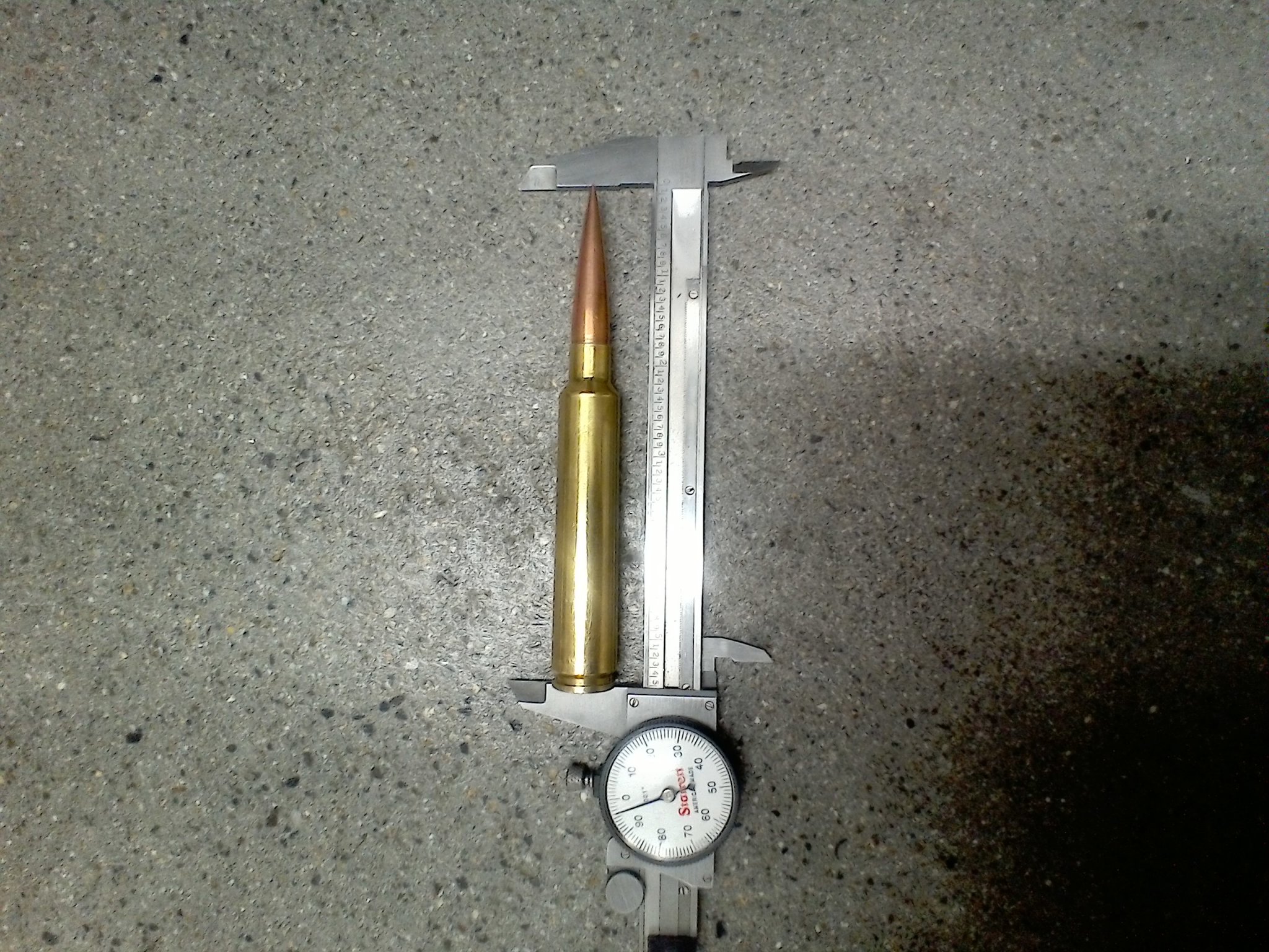

bullet stuffed in the blitz case .

Awaiting the performance details of this, along with the other "Nemesis" & "Executioner" cased cartridges :)
