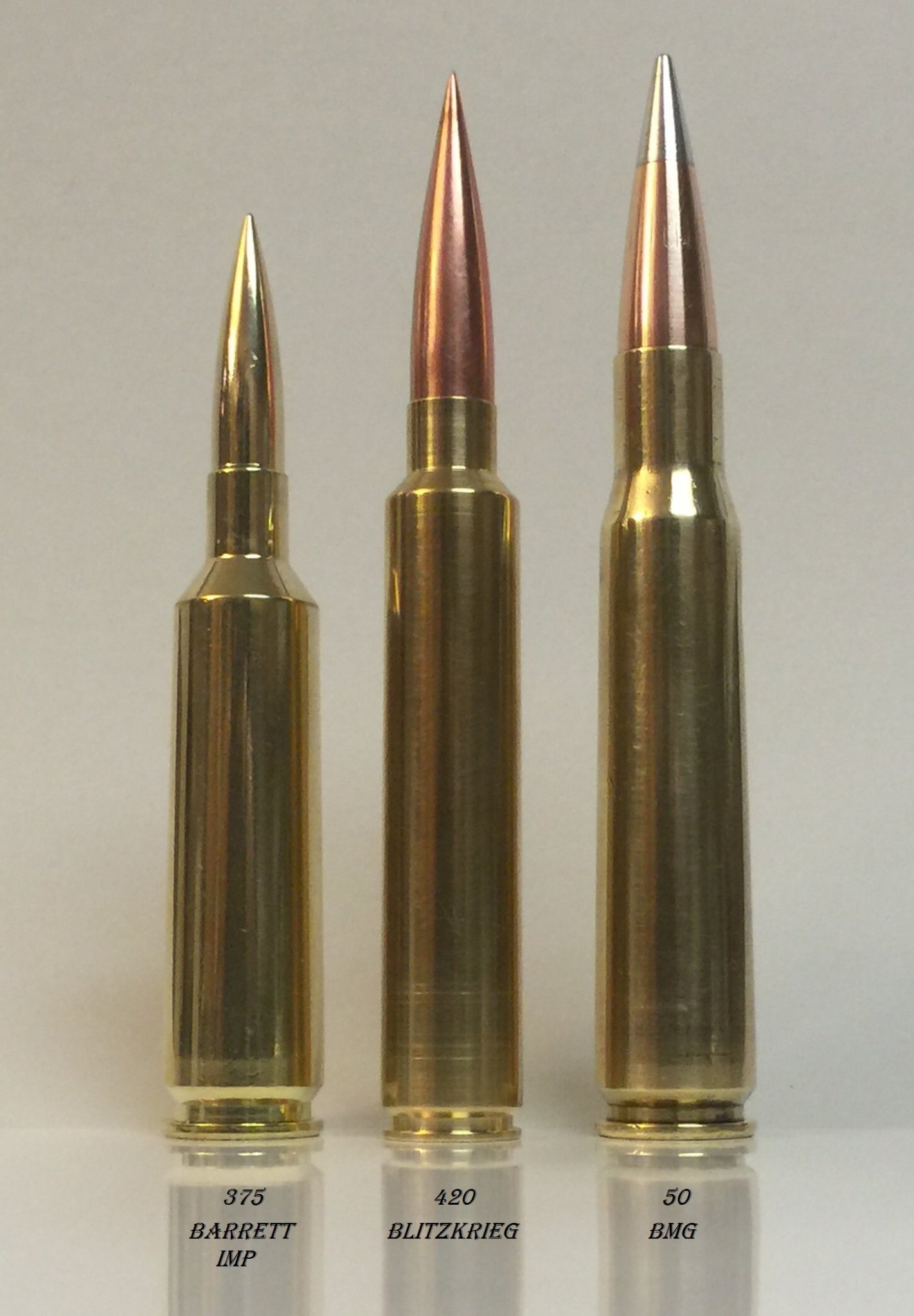

Kind of where we are at with our 420 Blitzkrieg cartridge and a couple others, completely new concept in case design in order to bypass "pre-existing" issues when dealing with typical parent cases on the market, have done multiple wildcats that have potential but are held back by the ailments of parent brass,
