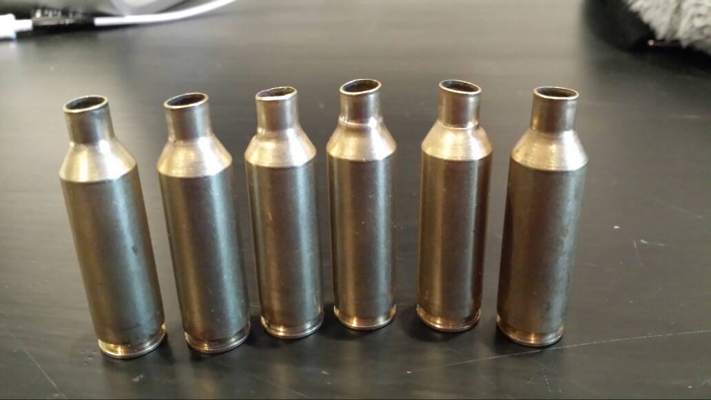

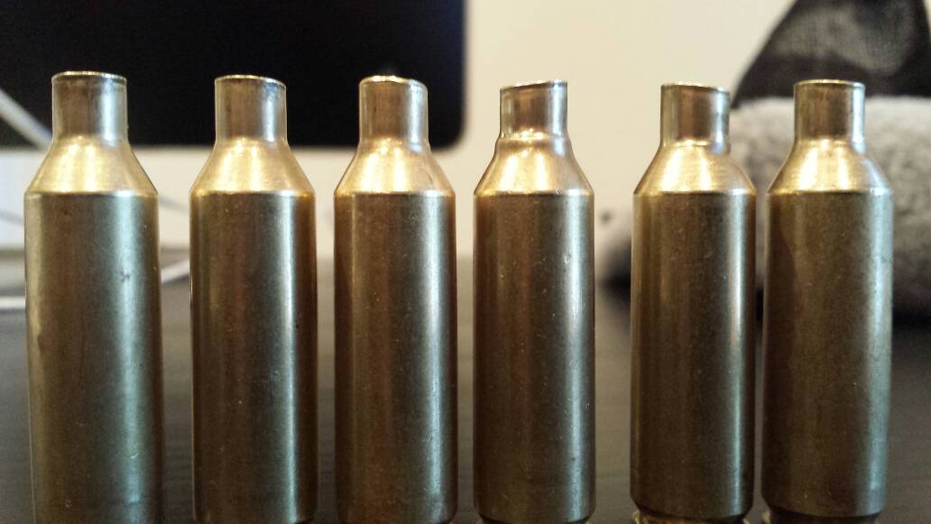

am I retarded? I used the .295 bushing on some once fired 300 SAUM and the necks turned out like this... do I need to use larger bushings and then slowly size it down and then trim? uploadfromtaptalk1403239128068.jpguploadfromtaptalk1403239139350.jpg
